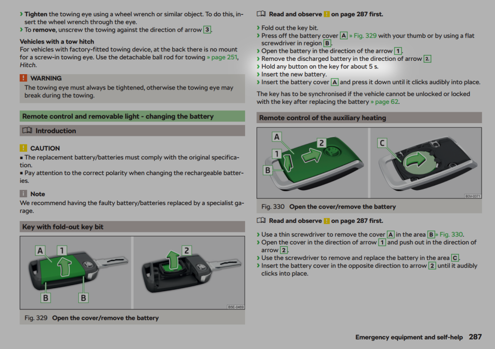

Do you hold any button for 5 s after removing the battery ?
Edited by agedbriar
Did not hold for 5 seconds so thanks for the information, now all batteries working. I would have thought the dealeship would have told me that when I put one of the batteries in to show it was not working, instead they took the fobs away and came back with the skoda batteries fitted and a £15 bill.

I replaced the keyfobs' batteries twice (i.e. 4 batteries) before learning on this forum about the 5 s button-press step.
Had no problem either.
The key and battery seem to be a moody pair...  :)
