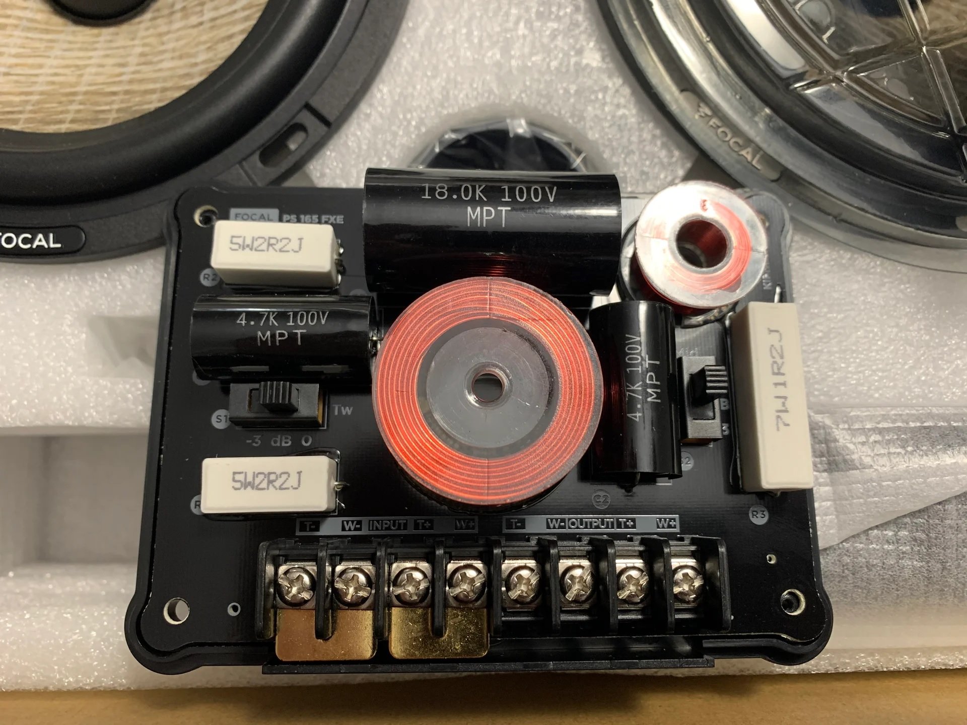

Below is the xover of the flax fronts you have. Electrically, its a 3rd order on the tw (or 2nd order with a contour network for the woofer, not sure what the second 4.7uF cap is doing as no schematic neither I can measure it) and 2nd order on the woofer. A few tips to try:
* check with a multimeter if there is a connection between the two 4.7uF caps by measuring on the side of the coil. If there is, then its a 3rd order electrical which may well be a 4th order acoustic slope (24db/oct). You can then try the following: remove the last 4.7uF cap (before the tweeter) and replace with wire. Remove the 18uF cap on the woofer - the value for a 4ohm driver (I haven`t measured it so a shot in the semi-dark) is large indicating this is likely also a 24db/oct slope. Try replacing it with a small cap - you can use the 4.7uF - this will give you a lighter roll-off and more midrange coming from the midwoofer Those are mounted very low in the Octavia so you`re (to the left side) at least 60 degrees off-axis - at such angle driver roll-off for a typical 6.5" with a phase plug would start at 2.3-2.5Khz (hence some not adding a crossover at all). Note, leaving the coil only (so using wire instead of the cap) would roll-off the driver with a shallower slope but will start earlier so don`t do it (you could, but with a smaller coil instead of this one). Its an easy modification - you need to resolder a few components on the PCB.
*if there is no connection between the two caps then this may be a contour network for the woofer (it may have a narrower cone resonance). Then one of these 4.7uF caps shall be connected to the large coil and one of the resistors should be across it (shorting it, effectively). If that is the case, try adding a piece of iron (a nut) inside the small tweeter coil and see if it brightens sound. If it does you can use hotmelt glue to leave it there or just replace the coil with a bigger value. You can also try replacing the tweeter cap (its one of the 4.7uF ones) with a bigger value as well, this will move the crossover point to a lower frequency hence clearer sound. Woofer advice from above also holds.
A piece of caution - doing the above will brighten the sound and may improve your midrange but will reduce power handling and may introduce another problem - at higher power to get more distortion our of the tweeter as its Fs is likely 1.2-1.3Khz and these rarely have ferrofluid in the gap so resonance shall be more pronounced. Still, doing it will give you more means of affecting sound from the car equalizer later on.
According to specs both are 2nd order filters. Second cap might be part of a notch filter, which is commonly used with Focal speakers, due to having rigid cone of the tweeter. It's there to remove possible cone resonance frequency, hence limiting distortion.
I have actually built active speaker set using Focal TC90TD5 as part of my thesis.
Manufacturer specs give the combined (acoustic) slope, not the electrical as its the important one. How you achieve it is your biz. I seriously doubt they put a notch on a tweeter, can you share an example? A typical hard dome has a resonance at 23-27Khz, the values for such notch are tiny and totally unneeded as even 3rd harmonic would be at 8-9Khz and it would be scarcely amplified by the tweeter motor as its weak.
Depends on the manufacturer.
Looking at this XO pics you attached, to me it seems to be 12dB electrical filter. Then again, it's hard to be sure without schematics.
Maybe not in this case, i don't know. But it's quite common to have a notch filter on a tweeter. This allows for "cutting" it fair bit lower.
Maybe we're talking about different things, but notch filter is calculated based on Fs of the speaker.
http://www.mh-audio.nl/Calculators/NFC.html
""Most drivers benefits from using notch filters, specially tweeters and midranges where the component values can be kept small. Using this filter on bass drivers calls for very large (and expensive) components."

Look Felix, typically a notch (LCR or CR in rarer cases) is used to suppress a cone resonance. While there are tons of online calculators that offer crossovers, lcr and l-pad calculation, they`re mostly useless and everyone that has designed at least a few speakers knows it. Actual approach is by measuring and then designing using software, such as LSP Cad or similar. Then you`d find our how misleading and useless are those online calcs such as the one posted, especially on crossovers. A strong resonance of a tweeter at Fs can be suppressed easily enough by a simple resistor across its terminal (usually using an l-pad). Complex LCR networks are rarely needed and usually employed by people believing they`d solve an issue that indeed they created by using the tweeter improperly. And again - a crossover type and its behaviour is determined by the acoustics (combined) slopes, not by its electrical order. There are very complex 1st order networks that while offering a simple 6db/oct decay indeed involve 10-12 elements such as coils, caps and etc.
Anyways, topic went elsewhere. Before you close measurements, I`d also run impedance sweeps so actual crossover adjustments can be done.
