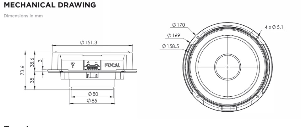

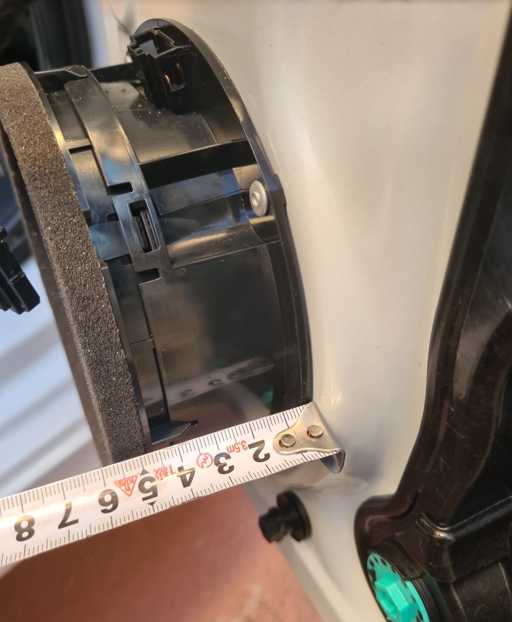

Hello there. I am thinking to do the same think. I have some questions, I would appreciate it if you could answer them.
1st, the height of the factory speakers is about 48 mm. The height of the Focal IS VW 165 is approximately 38mm. Did you add extra spacers to reach 48mm?
2nd did the 165 fit normally? I ask because Focal recommends 155 at least for the Golf 8.
No, i haven't used any spacers, but i have added some self adhesive foam to the edges of the speakers, same way as in factory speakers, but it's it's a bit longer, so it still touches the door card.

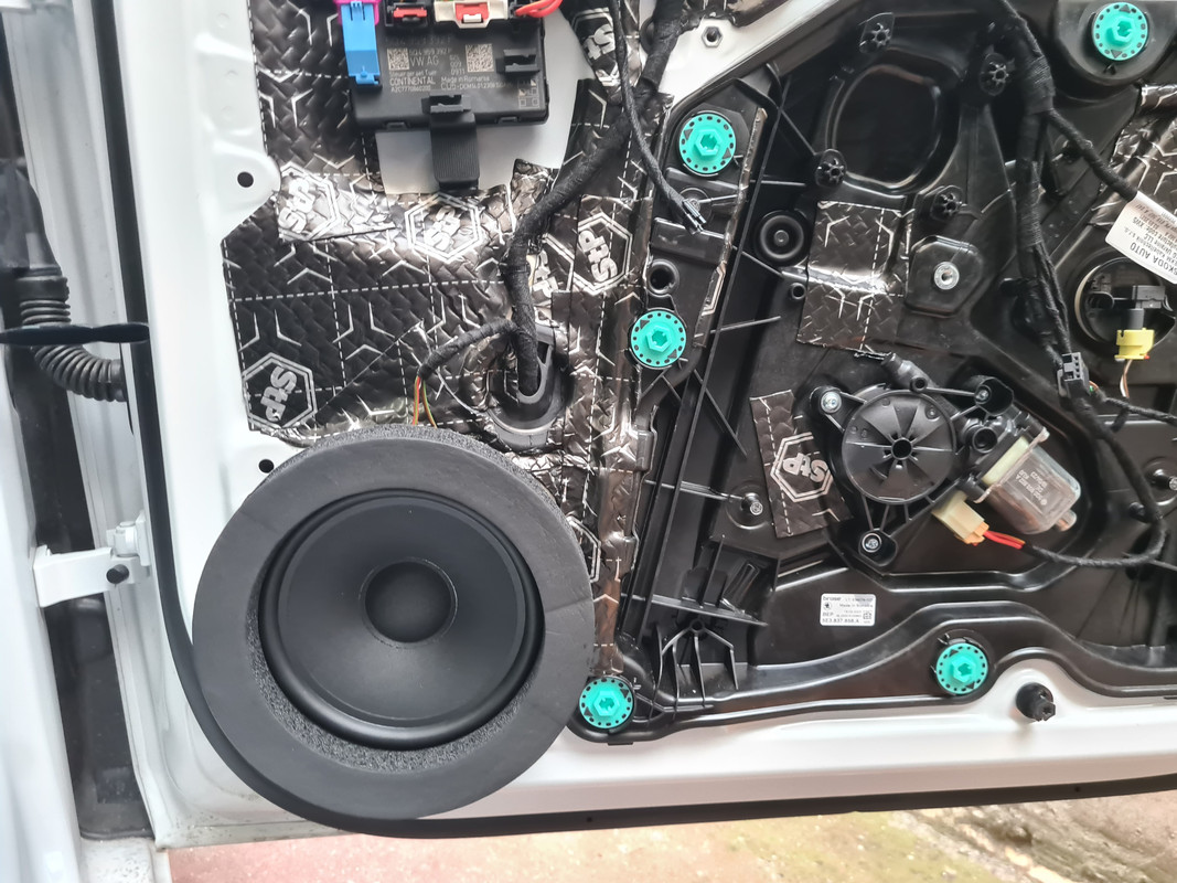

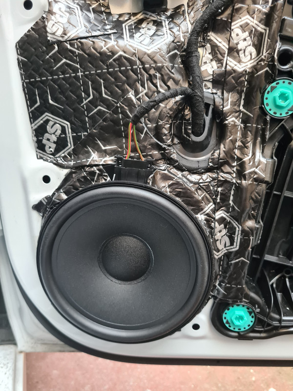

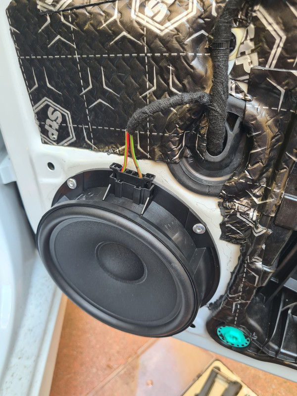

Finally i made the installation.
the process is straightforward.

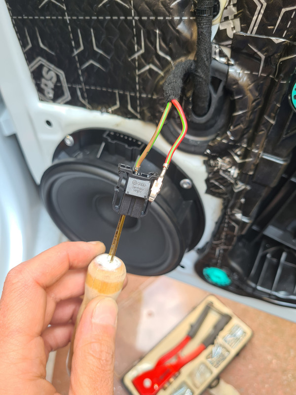

For the mid-bass range speakers the only matter is the connector.
I bought 2 connectors with 4 pins to make the installation easy.
I removed the pins from the original connector and i istalled them in the new one.
The new connector in its place:

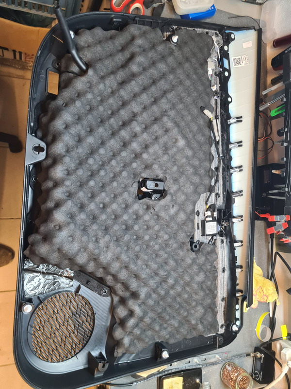

And some sound insulation
Finally, I put a soft material around the speaker to fill the gap between the speaker and the door cover.
I still have no idea about the performance of the speakers. I'll work on them for a few days and then come back.

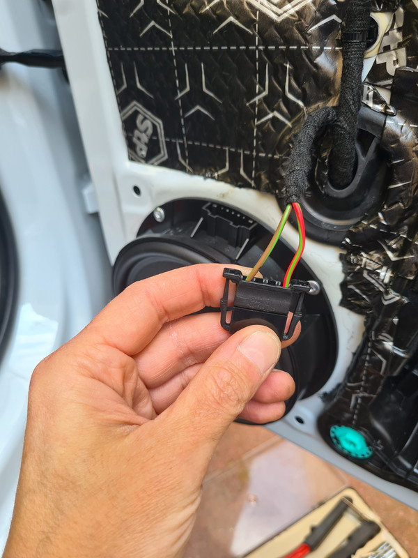

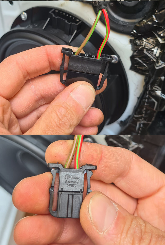

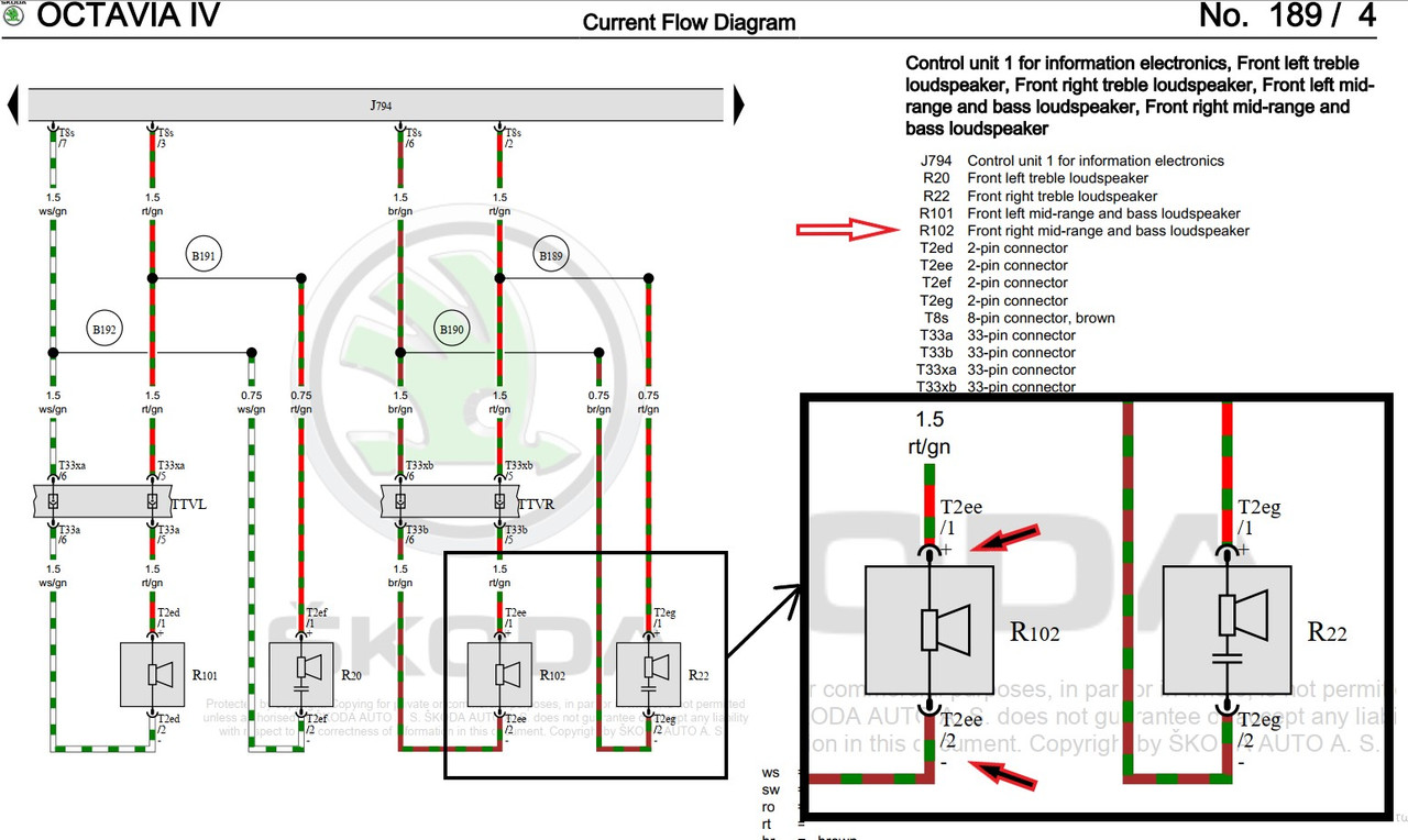

I was faced with a strange situation.
The subject of the speaker's positive and negative pole.
In the photo 1 is the electrical diagram, in the photo is the actual situation.
Photo 1
it looks like there is a reverse connection from the factory. Unless the pole marking on the speaker is wrong. (it isn't i tested it)
I can't figure out what's going on.
That's interesting. Need to check my photos if it's also reversed polarity.
In some applications actually reversed polarity is done on purpose, however i don't think it's the case here.

I connected the cables exactly as they were.
I didn't check the polarity on the tweeters, I didn't think there would be a problem, so i didn't have any photos.
I should check the connections and reverse the polarity on the mid range speakers just to test the sound quality. I have to undo the door panels, i am not like it.
