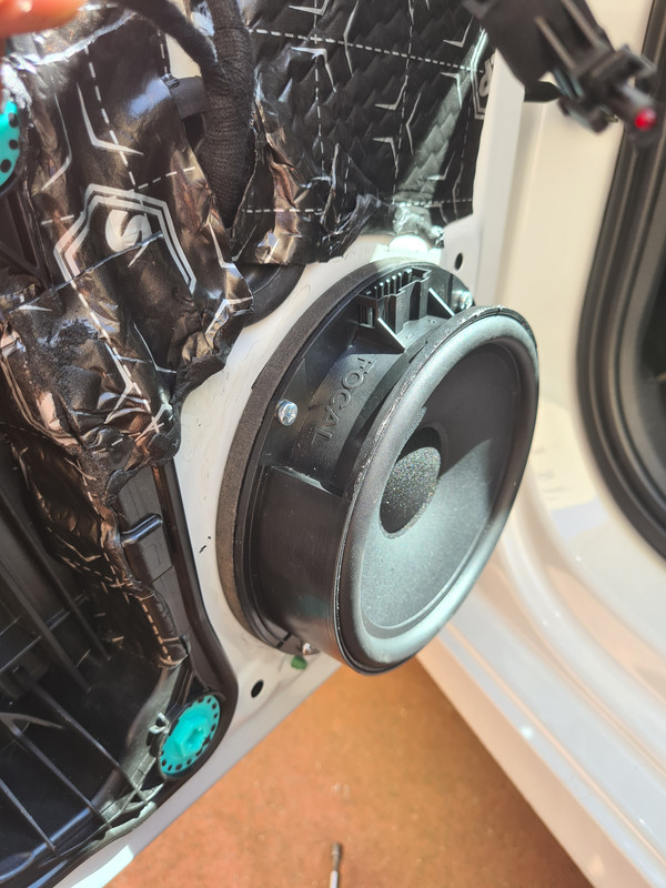

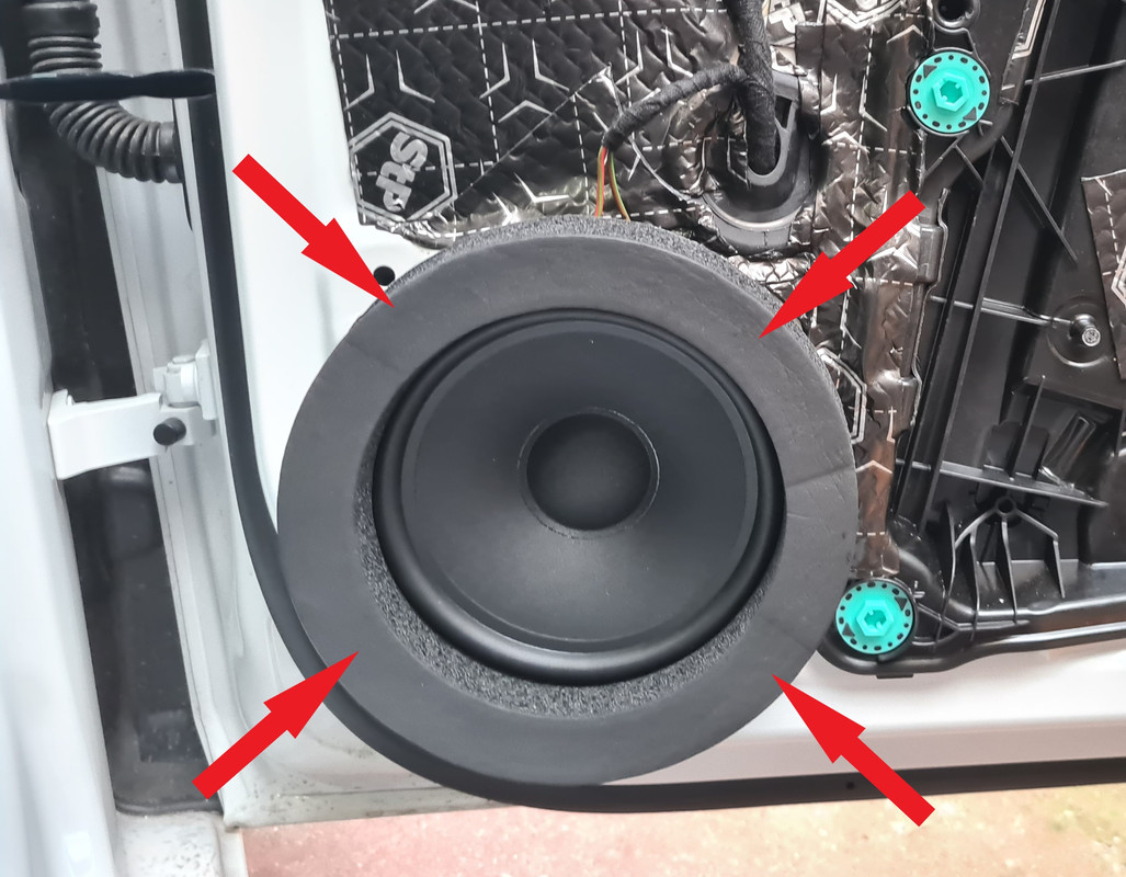

@Giannis20 looking at your picture it seems possible, that foam, when pressed, is pressing against speaker suspension and impacts the sound.
However that doesn't explain why you do not have enough treble, as this is coming from tweeters, that are not blocked by the foam (i assume :) ).
Anyway try whatever you can, as really your experience is the opposite of my experience with Focal, so there must be something wrong. Even if they are not the best speakers out there, they are objectively way better than factory speakers.

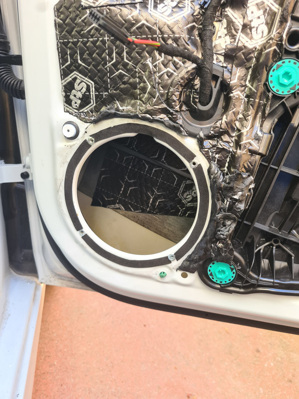

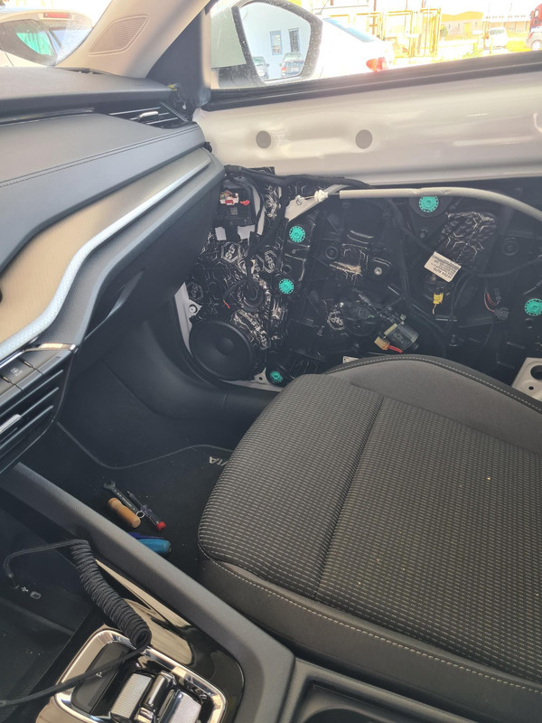

Well, yesterday i removed the passenger's door panel. Immediately the sound improved. I removed the foam from the speaker. Then i did some tests with the wire polarity, I changed the polarity and checked the speaker membrane moves out in the deep bass. I couldn't figure it out for sure, I left it with the change I made and plan to use the car for a day or two without the passenger's door panel.
For sure the sound improved, the treble is mostly heard to a satisfactory degree. And all this just from the changes I made to one door. The driver's door remains as it was. When I finish testing, I'll make the changes to this one as well.
I can say that, for sure, the foam made some kind of contact with the speaker and was spoiling the sound effect. I don't know why this created a problem in the treble as well (maybe it's the change in polarity that helped with this).

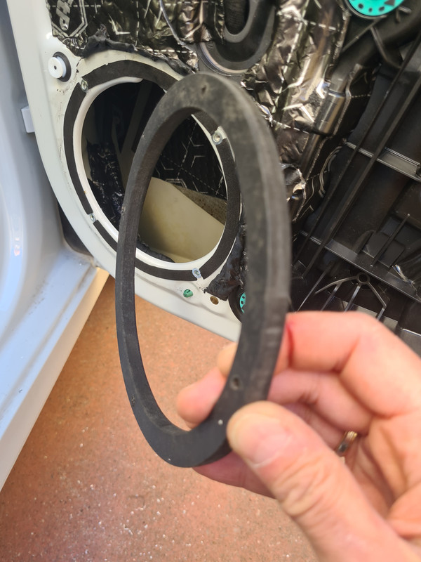

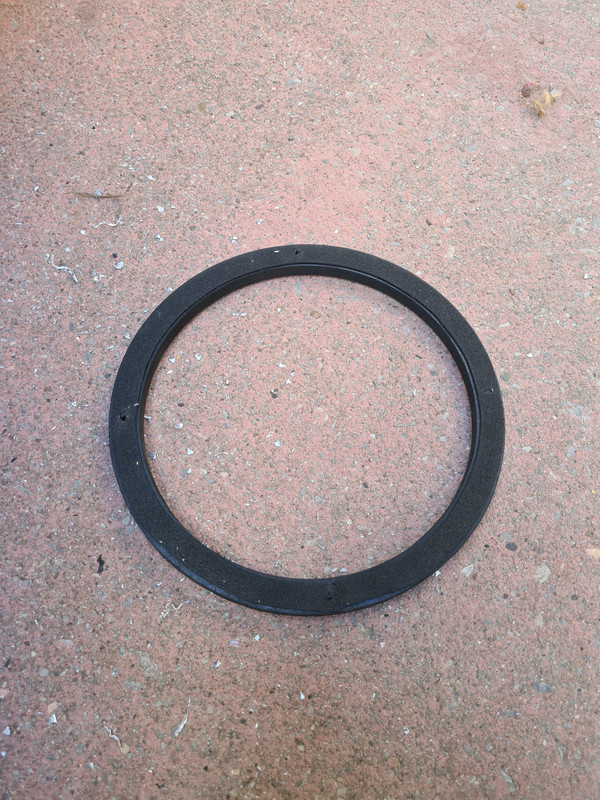

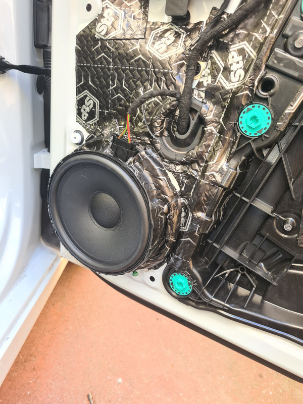

After finding out that the foam somehow spoils the sound quality, I proceeded to the 2nd plan.
I removed the speakers, put in rivet nuts and made a 10mm spacer.
I also change the polarity.
I didn't install the door panels, but the sound is much better, the bass appeared and the treble sounds clear.
Today I will complete the installation and update on the final result.

Are the spacers just cut out of dense rubber? Looks neat.
I made them out of MDF. I spray painted them black. Nothing special.

@Giannis20 - How exact do you think the 10mm thickness needed to be? For those of us that aren't very good at cutting rings with jigsaws, all I seem to be able to find is 14mm or 20mm spacers to buy.
To be honest I don't know if it's really necessary. I noticed the height difference between the factory and the kit speakers and after the foam solution failed, I made the spacers. I ordered them from a carpenter of course, neither can I, I can do something like that myself.
