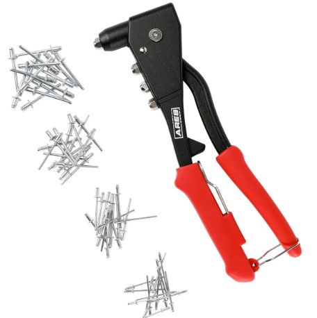

Sorry another question from me - how are people securing the 165s? Can the rivets included in the box be used? I'd rather not buy a rivnut tool!
i am afraid you have to use a rivet tool. There is no other way to fix speakers at the doors.
Αt least I could not install them with screws even though I tried, because the sheet metal around the perimeter has configurations, it is not flat to put some kind of metal nut from the back side.
Thanks @Giannis20 - were you able to do it with regular rivets, or did you have to use a rivnut? AIUI, the holes in the door are rather larger than those in the speakers.
Just regular aluminum rivets, with a rivet tool.

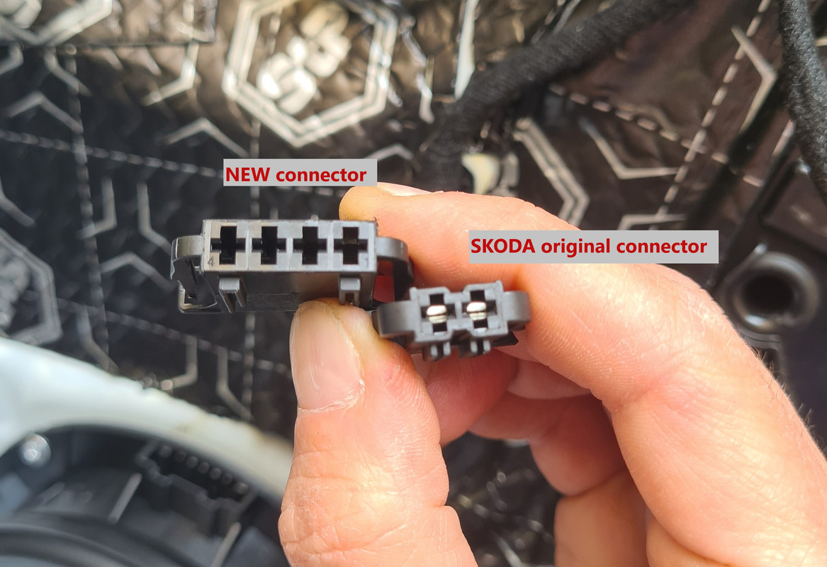

Finally i made the installation.
the process is straightforward.
For the mid-bass range speakers the only matter is the connector.
I bought 2 connectors with 4 pins to make the installation easy.
I removed the pins from the original connector and i istalled them in the new one.
The new connector in its place:
And some sound insulation
Finally, I put a soft material around the speaker to fill the gap between the speaker and the door cover.
I still have no idea about the performance of the speakers. I'll work on them for a few days and then come back.

Hi,
the 4-pin connector has a code: 4D0972704
the 2-pin connector has a code: 1J0971972
Edited by Giannis20
17 hours ago, Giannis20 said:
Hi,
Cheers mate. Where did you find these info?
