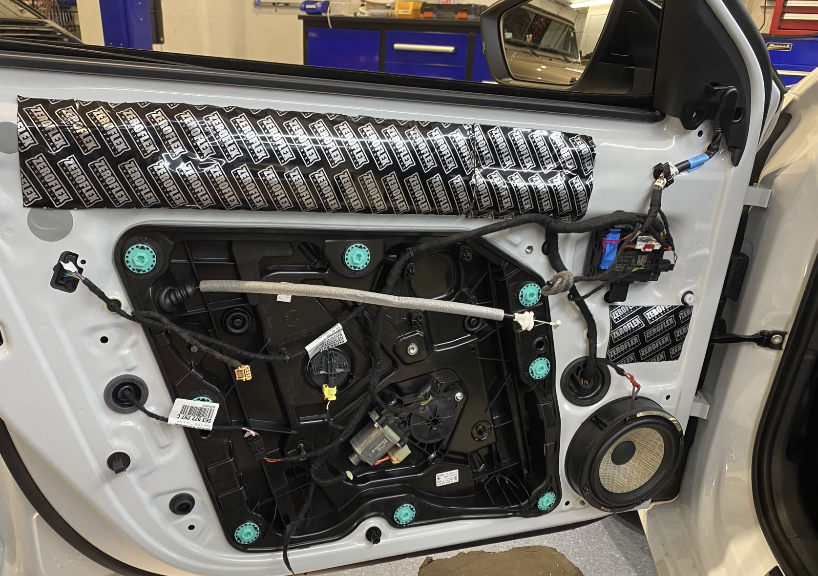

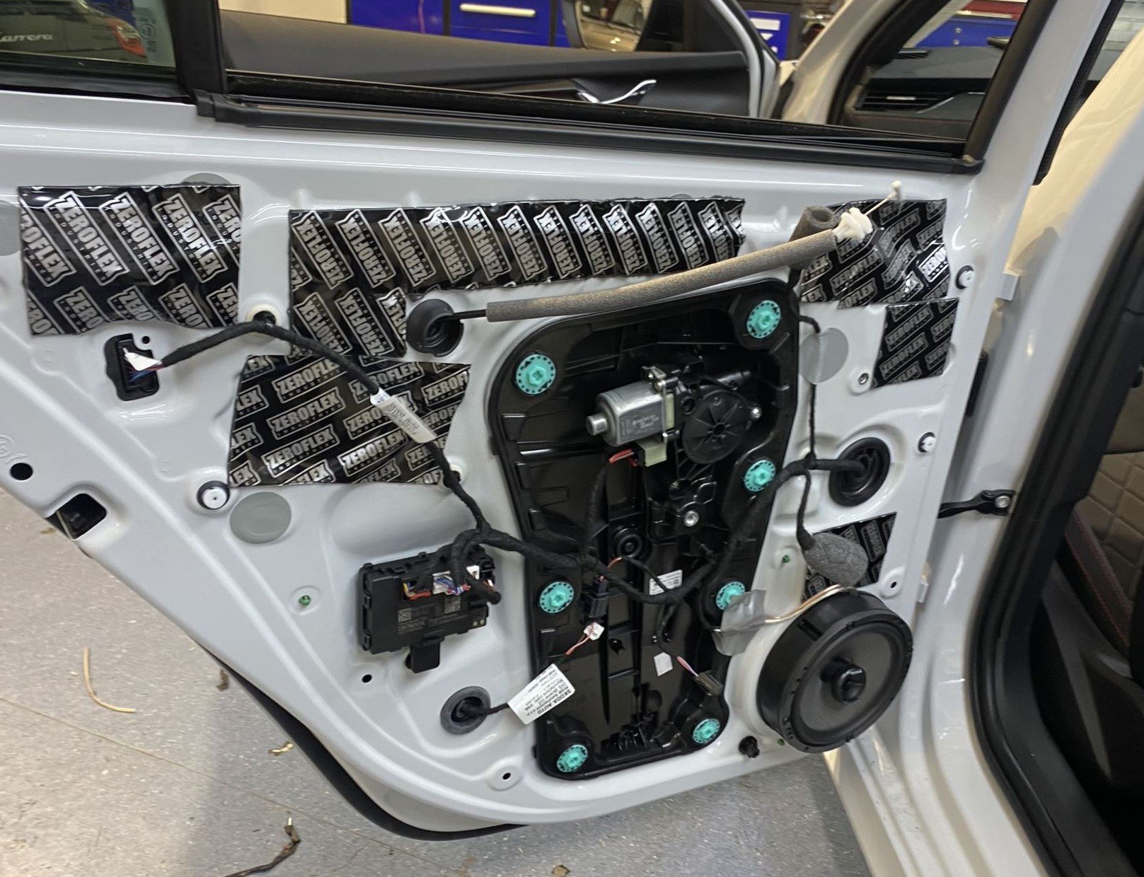

@Filternz to be honest i think you need to find a better workshop to do that. Getting a result that is worse than stock after upgrade is not that easy to achieve :)
Why would you mix different series of speakers, and using coax speakers at the back? They will have different characteristics, hence messing up the sound. Would be much better to use same type/series, and using normal speakers with separate tweeters at the back.
I cannot see it on the pics, but is the interior of the door dampened? Any mats inside? That brings improvement.

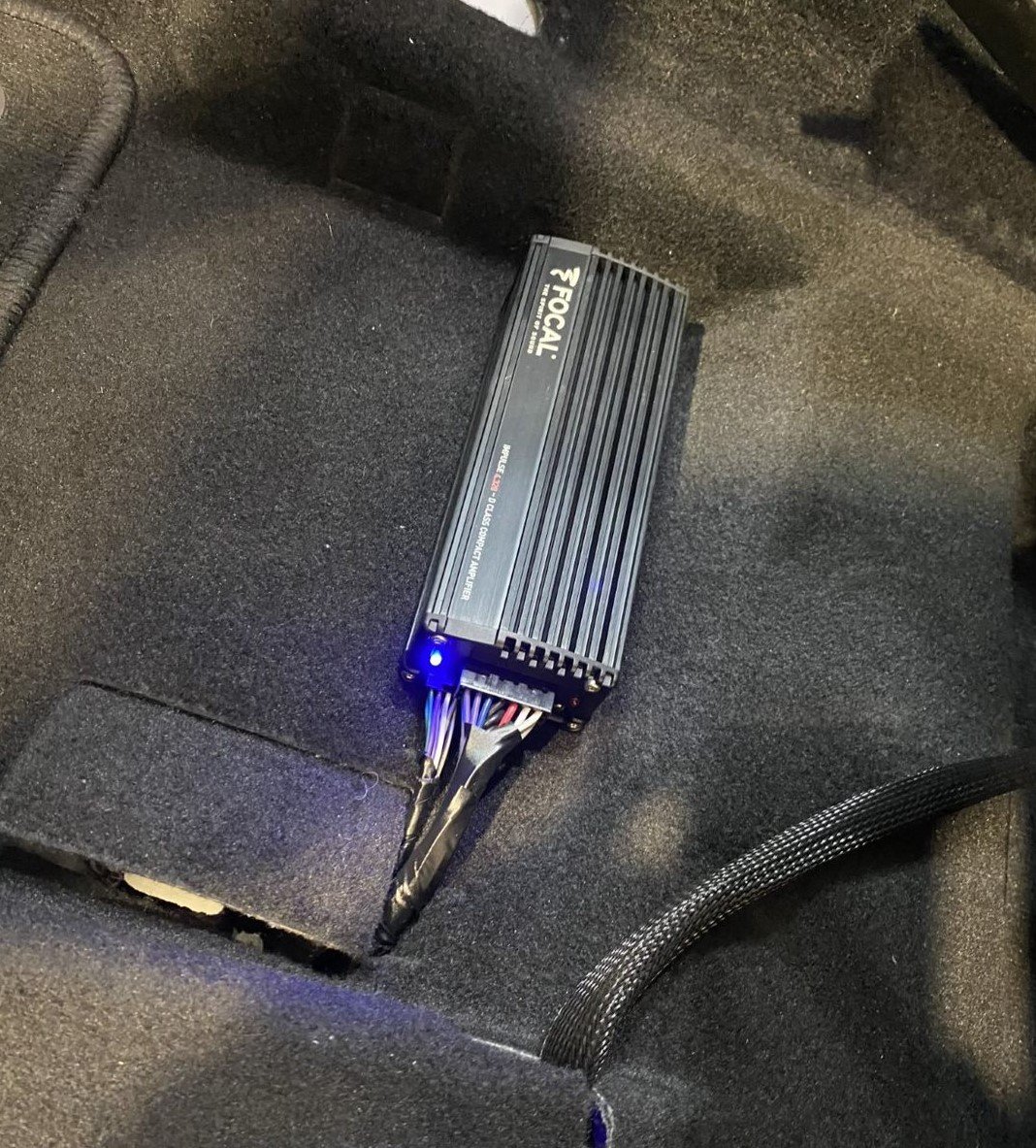

As for amp, would be much better to use something with MOST interface, compatible with VAG. Probably even original VAG amp would be better.
I think DSP is very much needed, question is if external one, or are you able to find someone that can fiddle with built in DSP. Check this out: https://mqb-blog.com/en/2022/02/21/sound-dataset/
