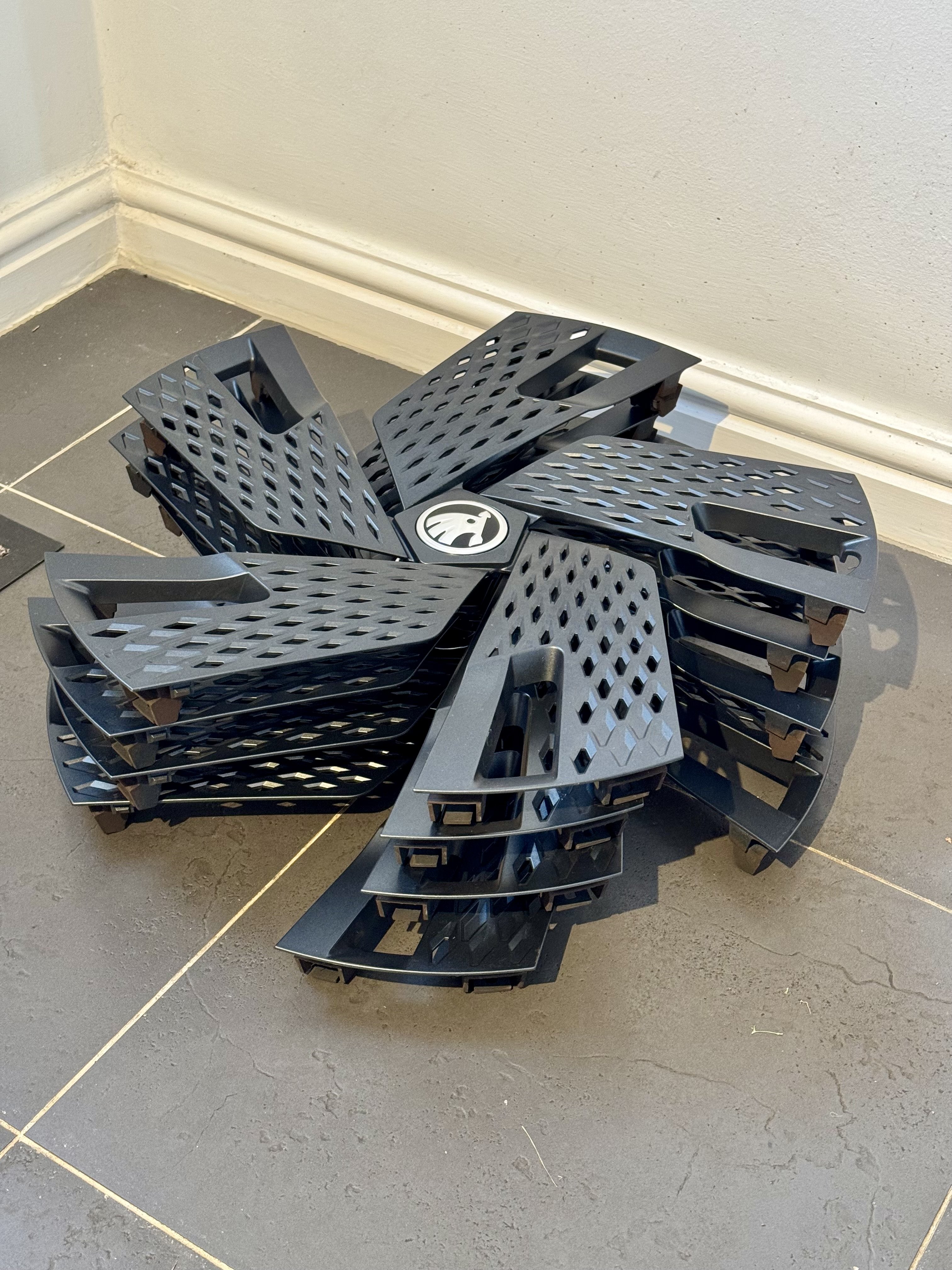

does anyone know the size of the caps needed when you remove the cheese grater inserts? thanks
my take on changing the aero on the segitarius wheels on my new karoq, i only spent around £9, no-one will know 😛

Just want to say thanks for this thread. I'm collecting my '72 Sportline Karoq today, which has the gross aero inserts. I've already ordered the bits to remove them, in advance of collecting it.
Dealer quoted approx £90 to do it, but I've found the bits for less than £30.
My sportline delivered a couple of weeks ago had Sagittarius wheels but no inserts! Not that I wanted them!
I believe that Skoda have deleted the inserts, on recent cars, probably due to owners removing them and buying the wheel nut and centre caps. I have kept mine on, just to be awkward!😂
Thanks again for this thread – I’ve now successfully removed the aero covers from my wheels.
I was shocked at how much brake dust and road grime had built up behind the fins! It took a bit of effort to get them properly cleaned, but I definitely prefer the look of the wheels without the covers.
Just a quick word of caution for anyone keeping them on: they can potentially cause scratches over time. I’ve noticed a few light marks on mine after removal, and my car’s only done around 6,000 miles.
