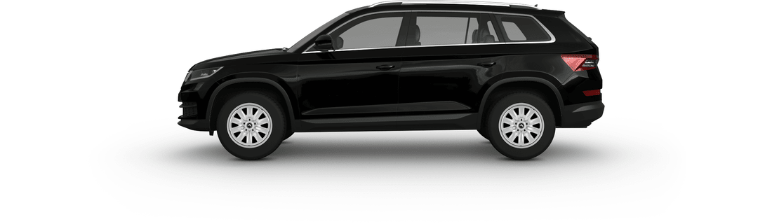

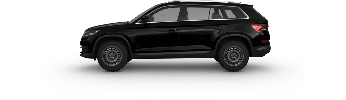

However, if you want a cheap and comfortable tyre size, 215/60R17 might be worth a look. You could fit this size to steel or alloy 6.5Jx17 ET38 Kodiaq rims. Compared to 215/50R18, 215/60R17 will raise the gearing by about 2.6%.
6.5Jx17 ET38 5/112 57.1 steel rims from the Kodiaq
https://www.mytyres.co.uk/rims/rim-selector
