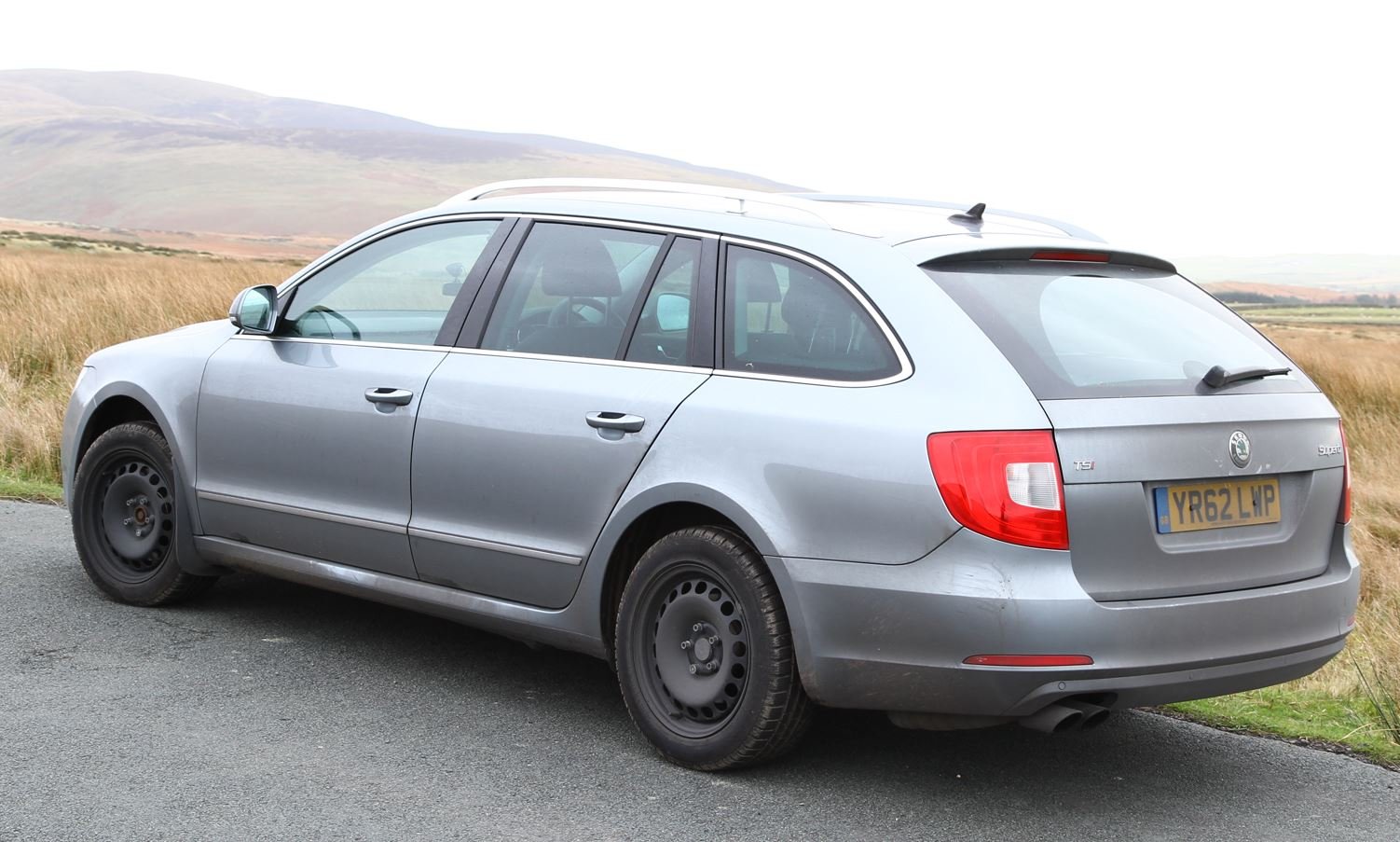

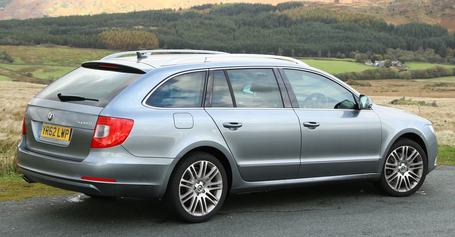

I went form this:
to this:
Main reason for the change was I needed a set of winter tires and I was tired of damaging my 18" - 3 times in less than 2 years. So I ended up with 3 set of wheels - 18" alloys, 16" alloys for the summer and 16" steel for winter.
Comfort was maybe a bit better but I did not notice a major difference. Definetally car was not as stable in on tiwsty roads but it never was a champion in that department.

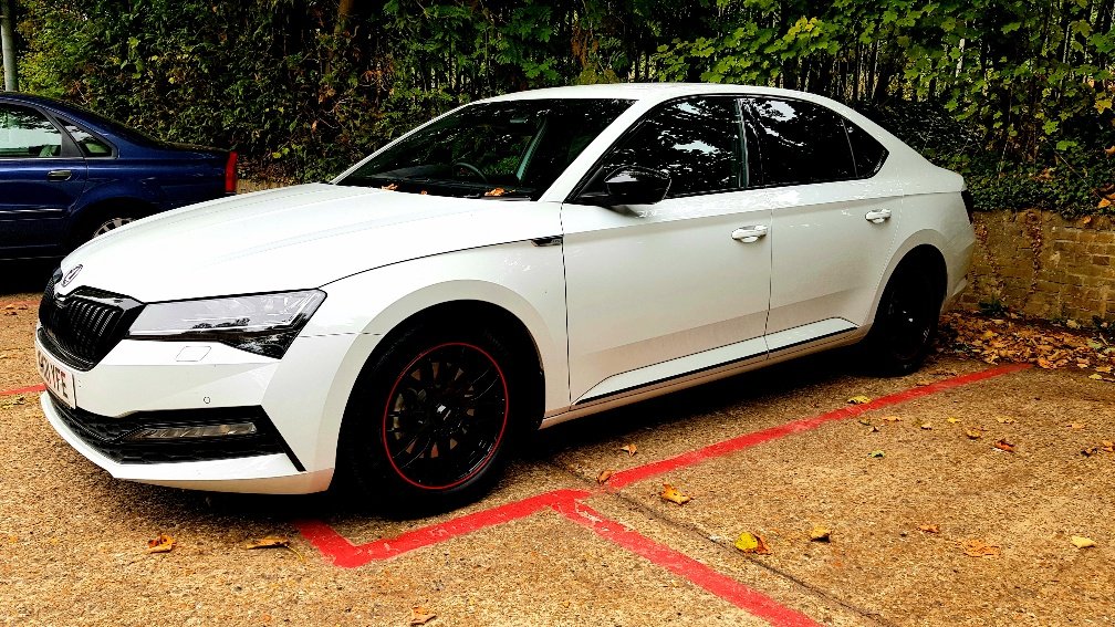

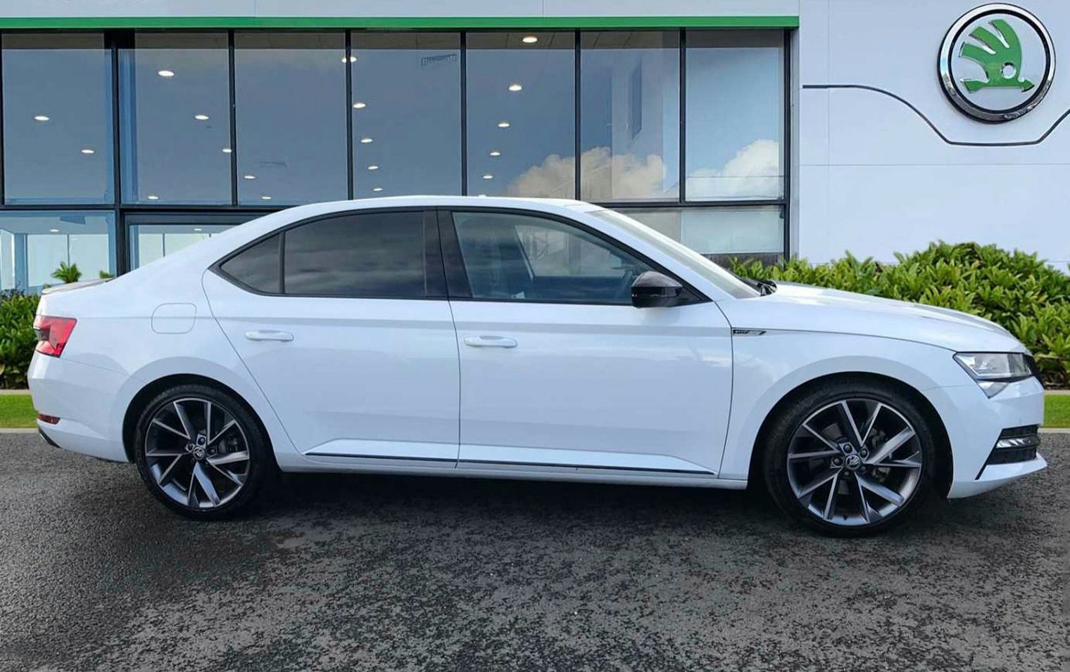

Hi Guys
My Sportline come on 19'' 45 profile, looked great but the ride was stiff. This winter I'm on 17'' alloys wearing Continental Contact All Season. Softer quieter ride. 17'' was the smallest wheel option when new so I was happy with hub and brake caliper clearances etc. Black wheels look 'less lost' in the wheel arch as the tyres help (also black 😄) and of course match the black sports trim
Photos below (I just need to decide if I put the summer 19''s back on next year, however................On balance we have more winter and rain than summer sun ?)
