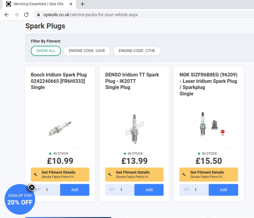

They even show and have the Plugs Skoda / VW Fitted and recommended.
