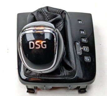

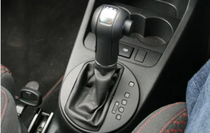

The reason i prefer D is the quick know across to M with some DSG's  and being able to drop gears to slow down.
I really do not use paddles, i like to use the shifter.
Is this not a thing regardless of D or S? You can still push across to M. Or do some DSGs have an actual slot for S?
Not on some DSG's, like DQ200's, like on a Mk2 Fabia vRS or others.
Needs to be in D to go to the left.
