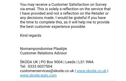

@toot I asked for something in writing that I would still be covered when my warranty runs out if the problem was nothing to do with ‘Software update’ as I explained I wasn’t going to pay when I’ve taken my car twice now and luckily they did email me.
You raised it within the Warranty period.  They have accepted there is an issue and they can not resolve it and putting the issue with Skoda CZ / VW Group.
Now this rubbish from Customer Services.
Now they have to own it. It is their problem to resolve even after 3 years passes.
85% of Fabias with the issue.   What total idiots they have doing the Customer Service roll.

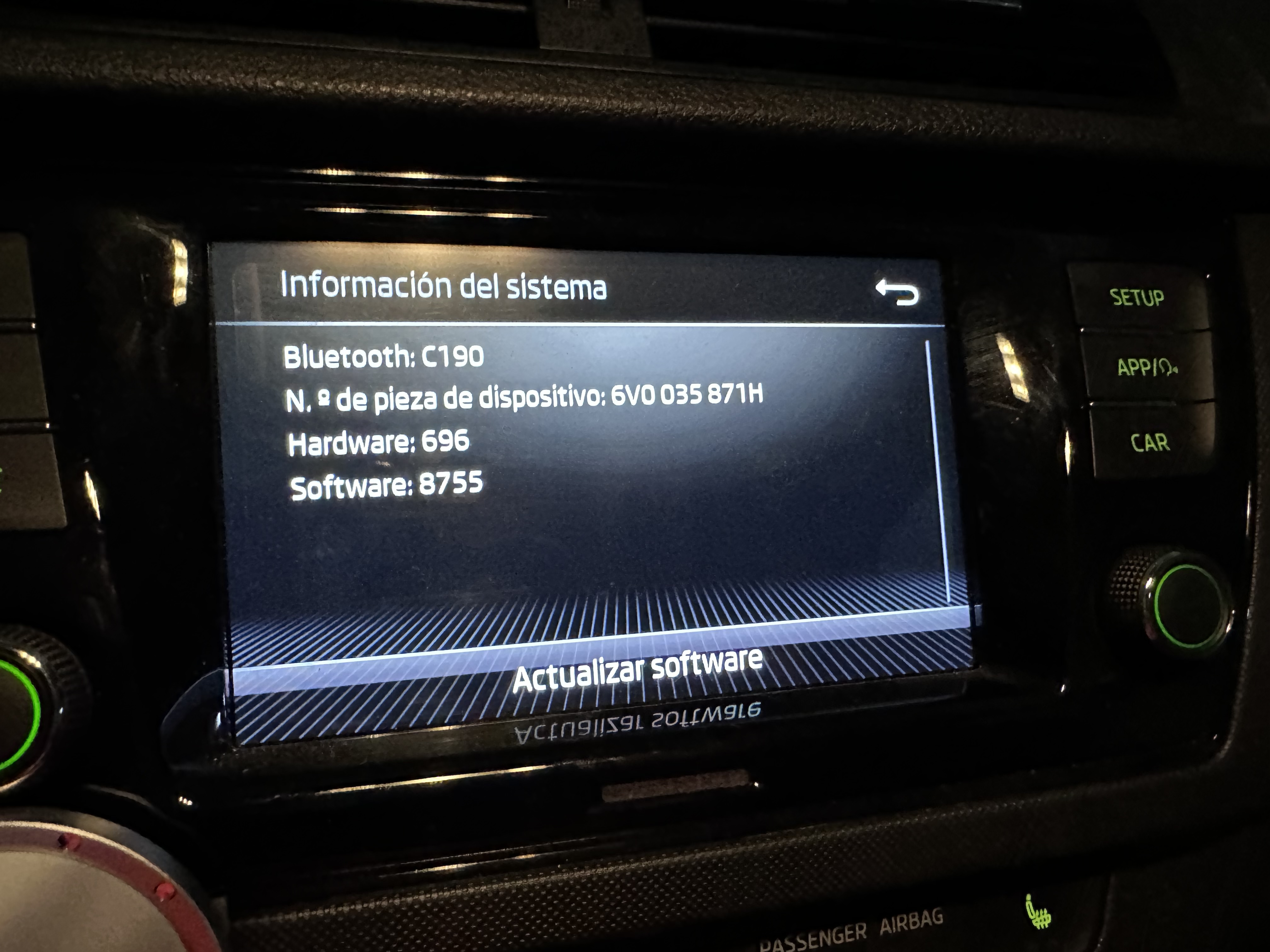

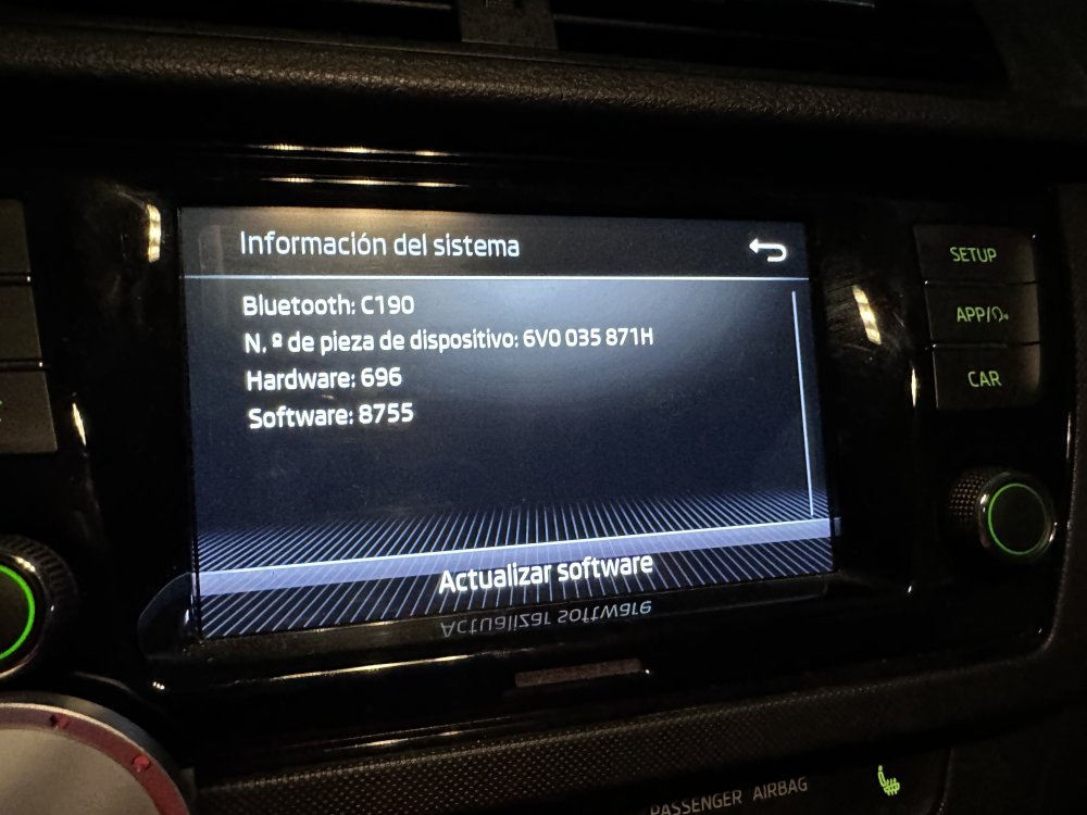

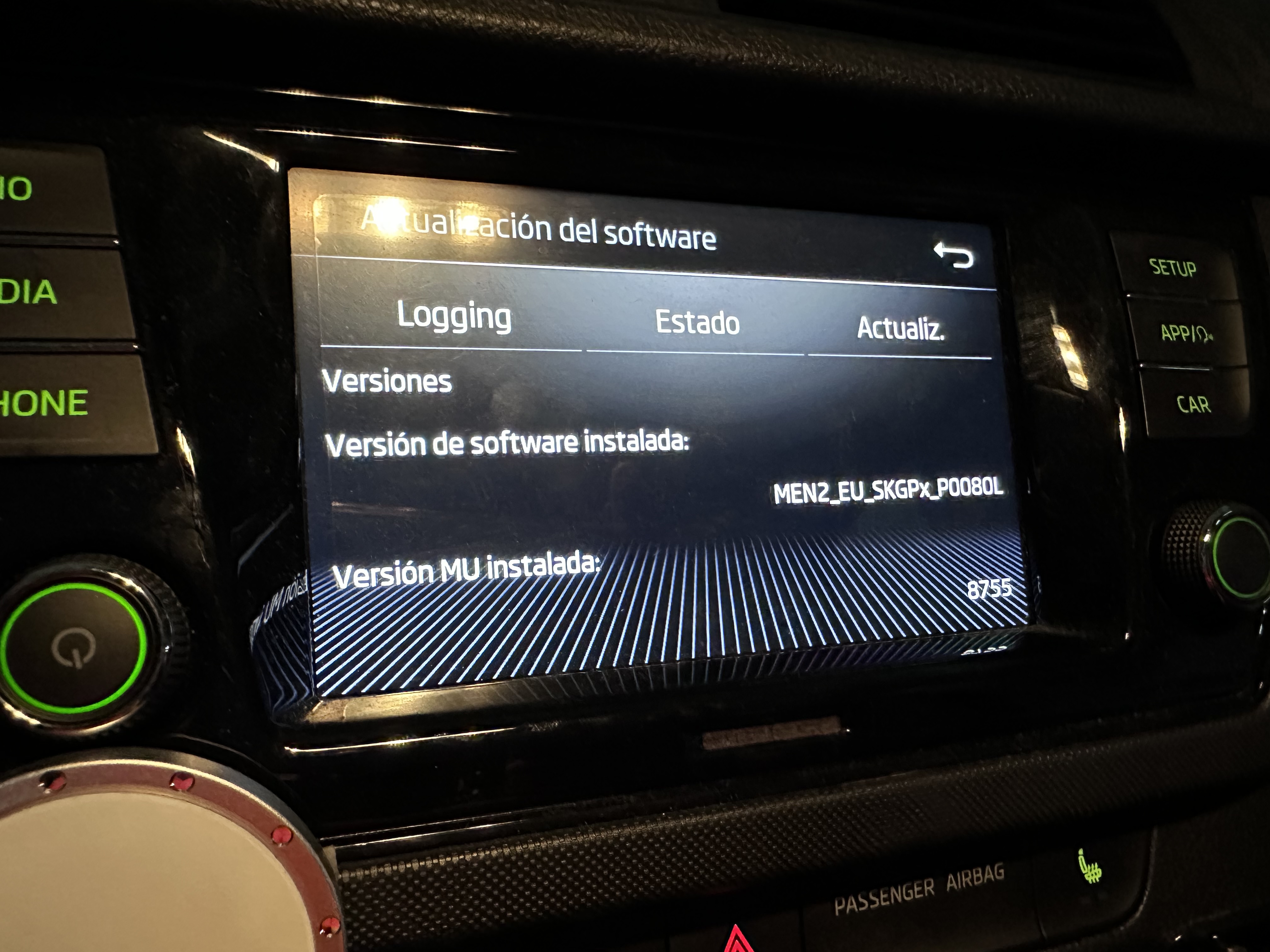

hello, I tried to look for the software number as you indicate that it should be searched for but I only found the following to see if it works, will it have an update?  Is there any way to install smartlink or only by the dealer?
@gruger I don’t know how to view that in my car. Can you give me a step by step guide ?
Your tag of his name didn't work.
But I can answer this, just press and hold on your radio the Menu or Setup button (depending on what you have) for about 10 seconds, and this will only show you the firmware that is inside the radio.
So your engine and all the other control modules will not be in the list, for that you still need VCDS or equivalent.

This is the software that my car is currently running on. Can someone confirm if this is the latest for the 2020 model.
