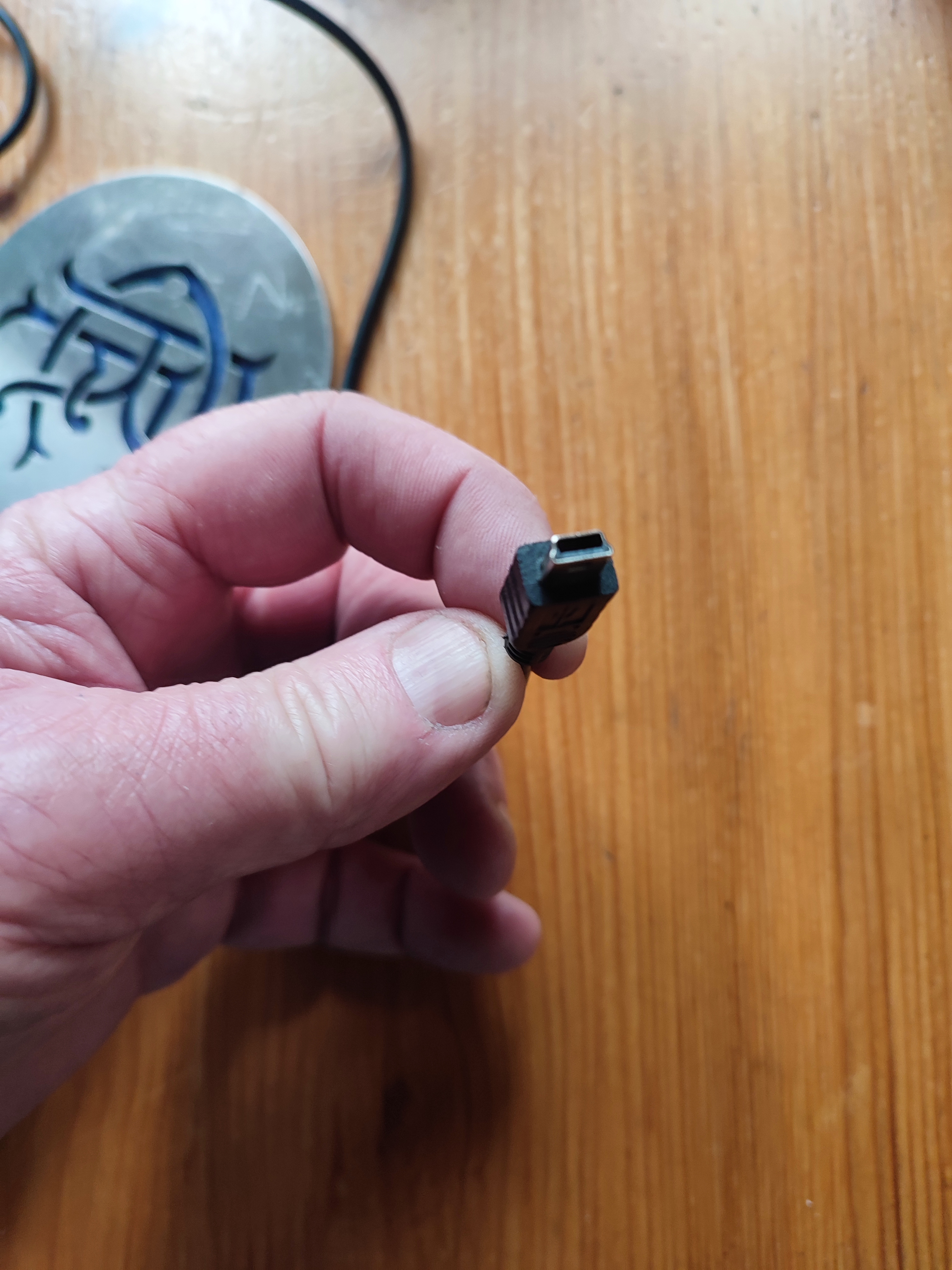

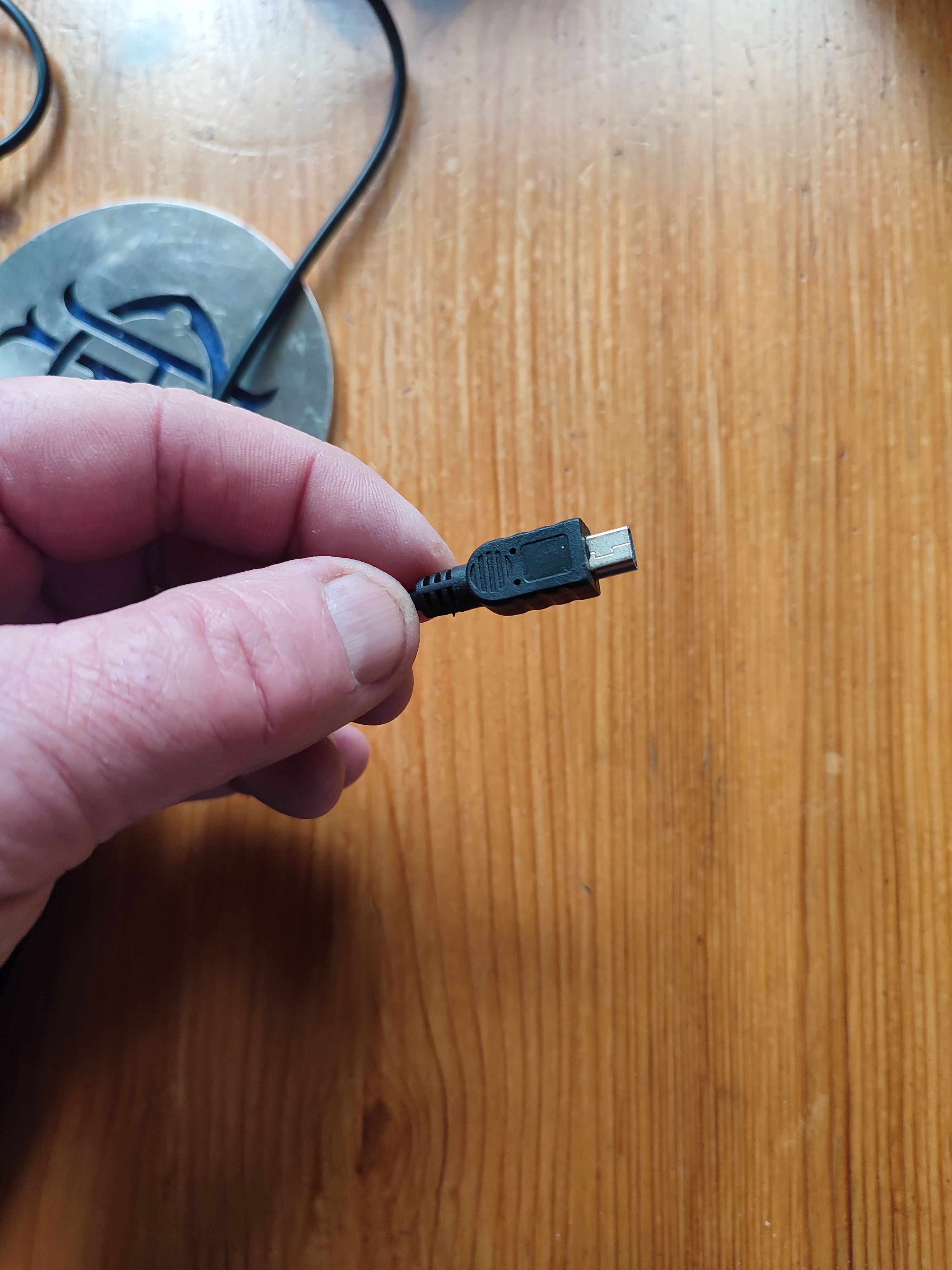

That's exactly what I did with it:
Enjoy the new car 🙂.

Yep, it works fine and so simple to connect. Cable as per Mark’s post.

Can you post the amazon link mate as I'm not sure this will fit my nextbase dash cam.

That appears to be more than one cable. I'm confused sorry.
Can you please explain..
