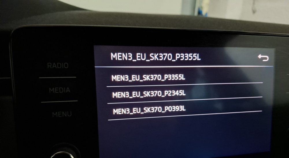

  • There are these updates, but not sure if the higher number will apply to your system.   MEN3_EU_SK370_P0113P_0469 MEN3_EU_SK370_P2135P_0742   MEN3_EU_SK370_P1185L_1760 ME

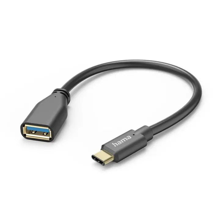

I had both versions in their folders on the usb, i had to buy usb c to usb a otg adapter to attach my usb stick.

I went from the bottom one to second and top one is latest(1800) dont know exact version number. (Check image that i posted above)
You can download only two versions SK370:
Edited by CrazySkoda

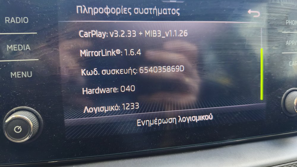

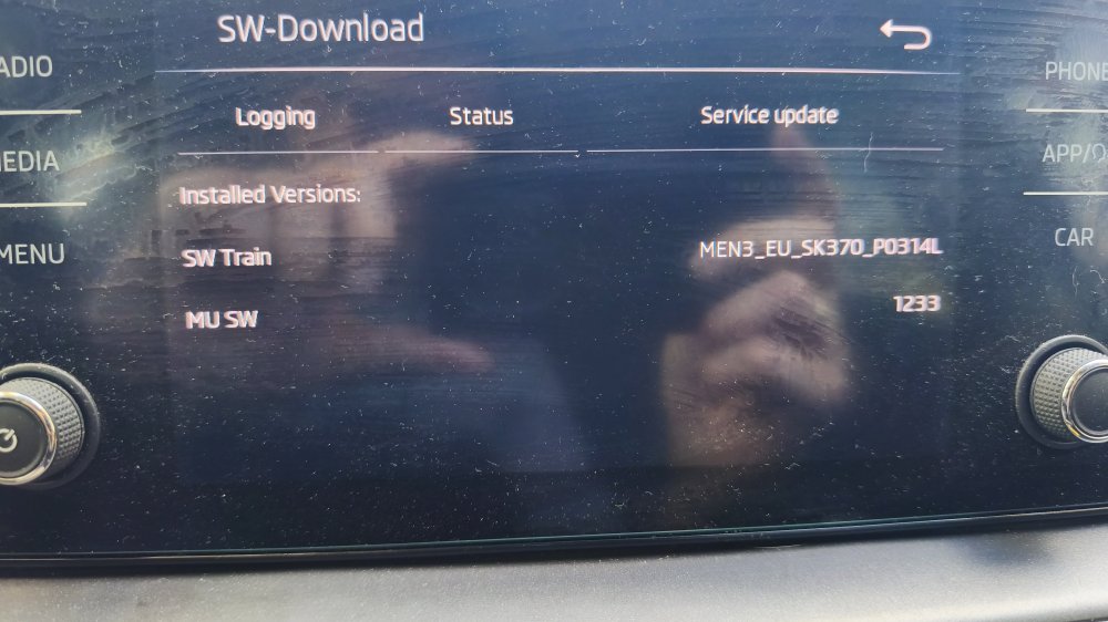

Hello to all, i have the following MIB3 Bolero system in my 2021 Skoda Scala.
Can i upgrade the unit to MEN3_EU_SK370_P2345L that i found in MIB Helper?
You can go with P2345L version in between, then to the latest: P3355L (1800)

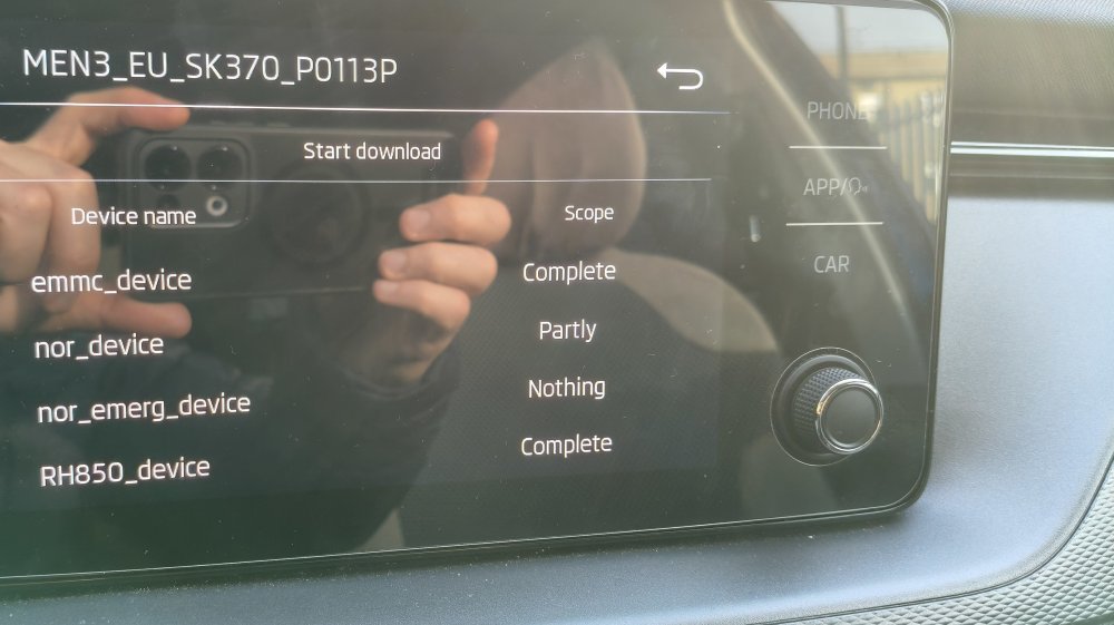

quando inserisco la USB drive sull'ingresso USB e avvio il caricamento del firmware SK370_P0113P mi compare la situazione in foto.
Lì dove è scritto Partly o Nothing, cosa significa?
Nell'attuale software installato in corrispondenza di quelle voci (e ad altre successive) c'è scritto "OK" .
Ho il timore di fare un errore installando il nuovo firmware che potrebbe risultare non completo.
Cosa mi dite?
Grazie.
Edited by CiccioSkoda51
That means that there is no newer version of that part in firmware. Had the same thing when i was updating fw.
You can update without problems!

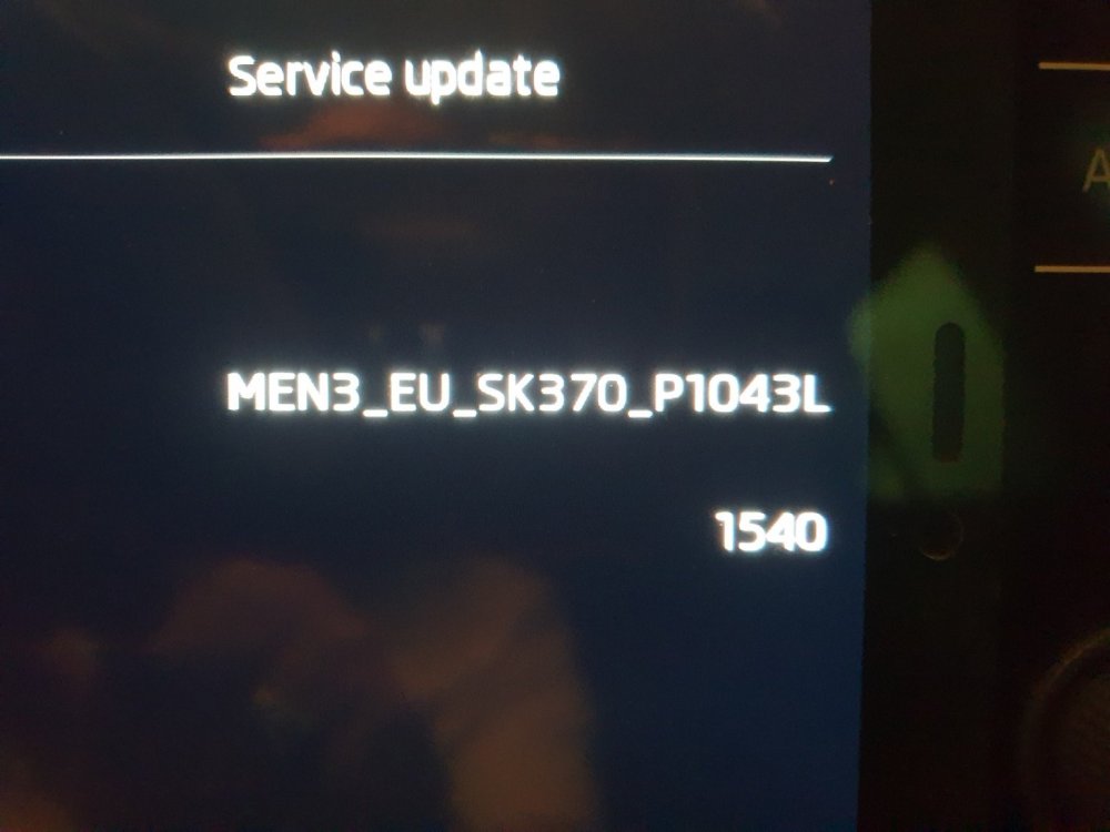

Skoda scala 2021
version 1540
ive used a 4,8,16g flash drive fat32 in usb a / b
try version 1800 / 1798 / 1790 /1760
but car did not detect update
Edited by llcoolr

Hi, i think that you need to use USB C OTG adapter instead, 1779038745225499889115722866658.jpg
Yes i did
12 minutes ago, llcoolr said:
Yes i did
Please try to unzip the content from the folder to the root of usb instead?
Check this out if you havent already. Thats the correct steps to update:
https://youtu.be/o0RIdpKQ2b8?is=Yn6CeyB0U3i_uPQ1
do engine need to run to update ?
I dont think so, havent run my engine when updating. But i know that i needed to buy USB OTG, normal usb a to usb c didnt work. Is there difference or it was just bad cable. I dont know. Try other cables or usb drives if you have?

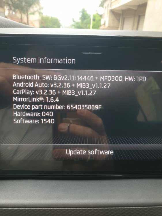

Now worked
So im in 1540
What steps i need to follow according to my unite

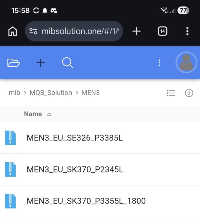

P3355L is 1800v and its latest on mibsolution
You can go middle one, and then download the 1800 if you want, or stick to 3225l which is 1798v
Successful update to 1760
Will trst if android auto still have problems
