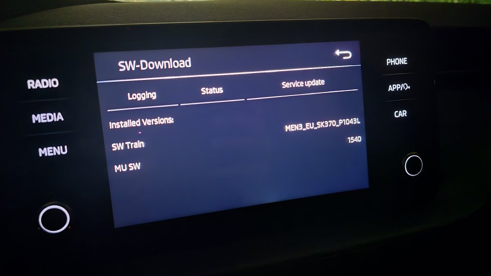

Hello all,
owner of a Skoda Kamiq model. SW Train is MEN_EU_SK370_P1043L, MU 1540 (I saw a couple of other folks having the same starting version in this thread). I have the usual connectivity issue with newer android version (older phones can connect alright).
My understanding is that I will have to sequentially go through the following updates (based on an earlier post, let me know if I'm wrong):
1st Update: MEN3_EU_SK370_P1185L, MU 1540
Then: MEN3_EU_SK370_P3225L, MU 1798
Then: MEN3_EU_SK370_P3355L, MU 1800
Can anyone priv me with instructions/files?

Hello everyone, I also have a Scala 2021 vehicle and I want to update the system.
My current version is MEN3_EU_SK370_P1043L, MU 1540.
I would be very grateful if you could share the files. Also, what should the installation order be, and do I need anything else?
Thank you very much.
