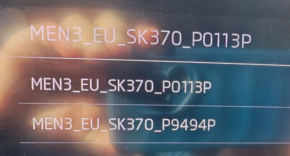

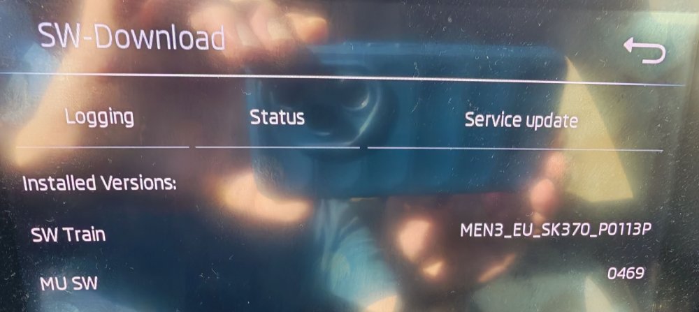

Hi! I would to know if there is a new update for Mib3 Bolero, i’ve attached the picture with version.
Thanks

There isn’t update?
5 hours ago, Tiry said:
There isn’t update?
Nope. This is the last version AFAIK.
