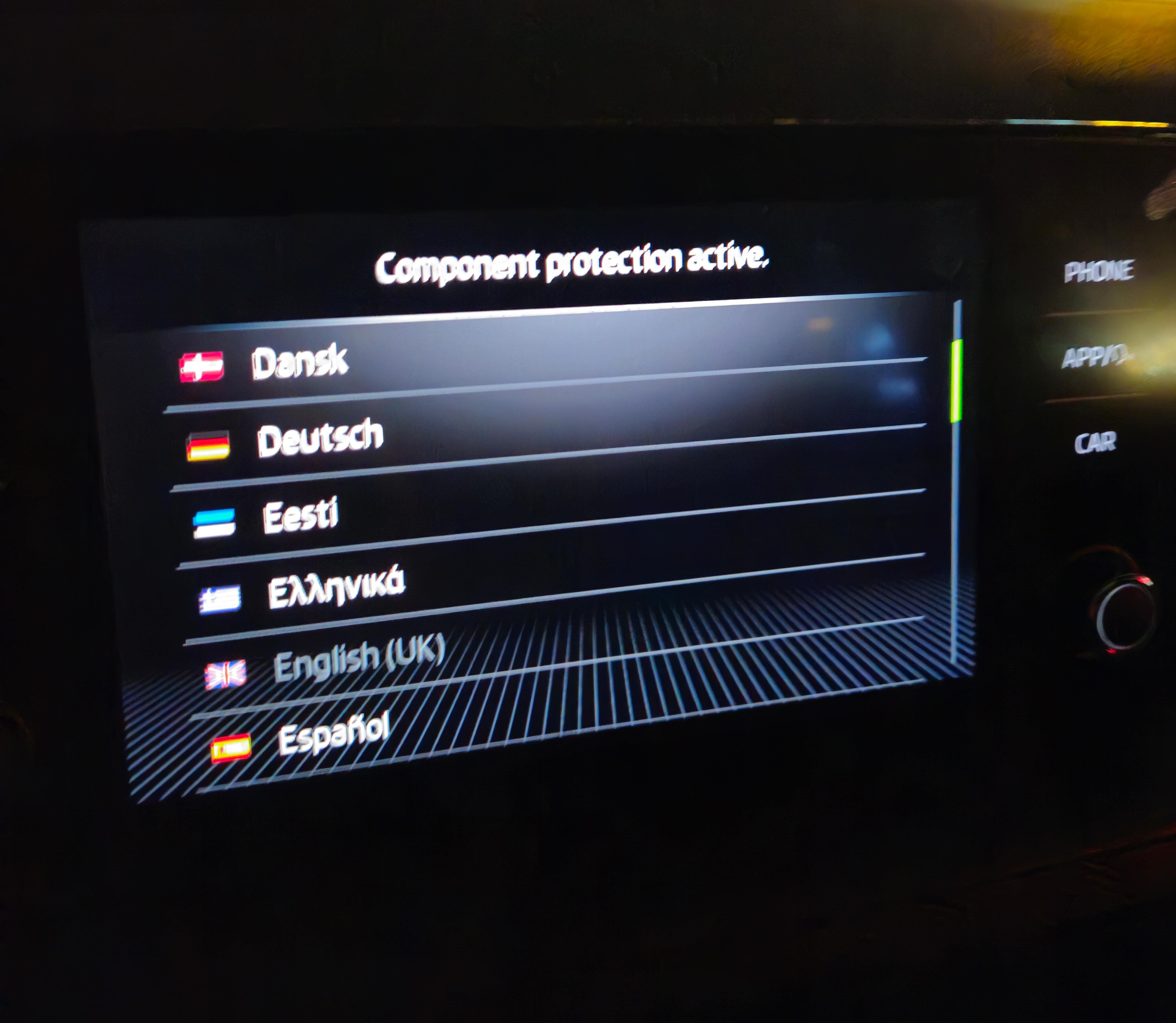

After updating my multimedia to SW 1800, I have a problem. After one week of updating, an error message like "Component Protection Active" appears on the screen. I quickly searched the internet and found some possible solutions, but it was for the MIB2 type multimedia, not for this.
Do any of you guys know how I can remove this error?

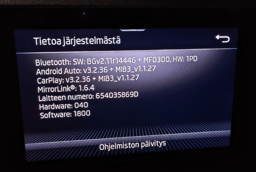

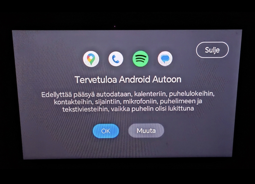

    I just updated to 1800, I have a Skoda Slavia in India with the Bolero system. I can confirm that the issue with S23 Ultra is finally resolved! Attaching images.

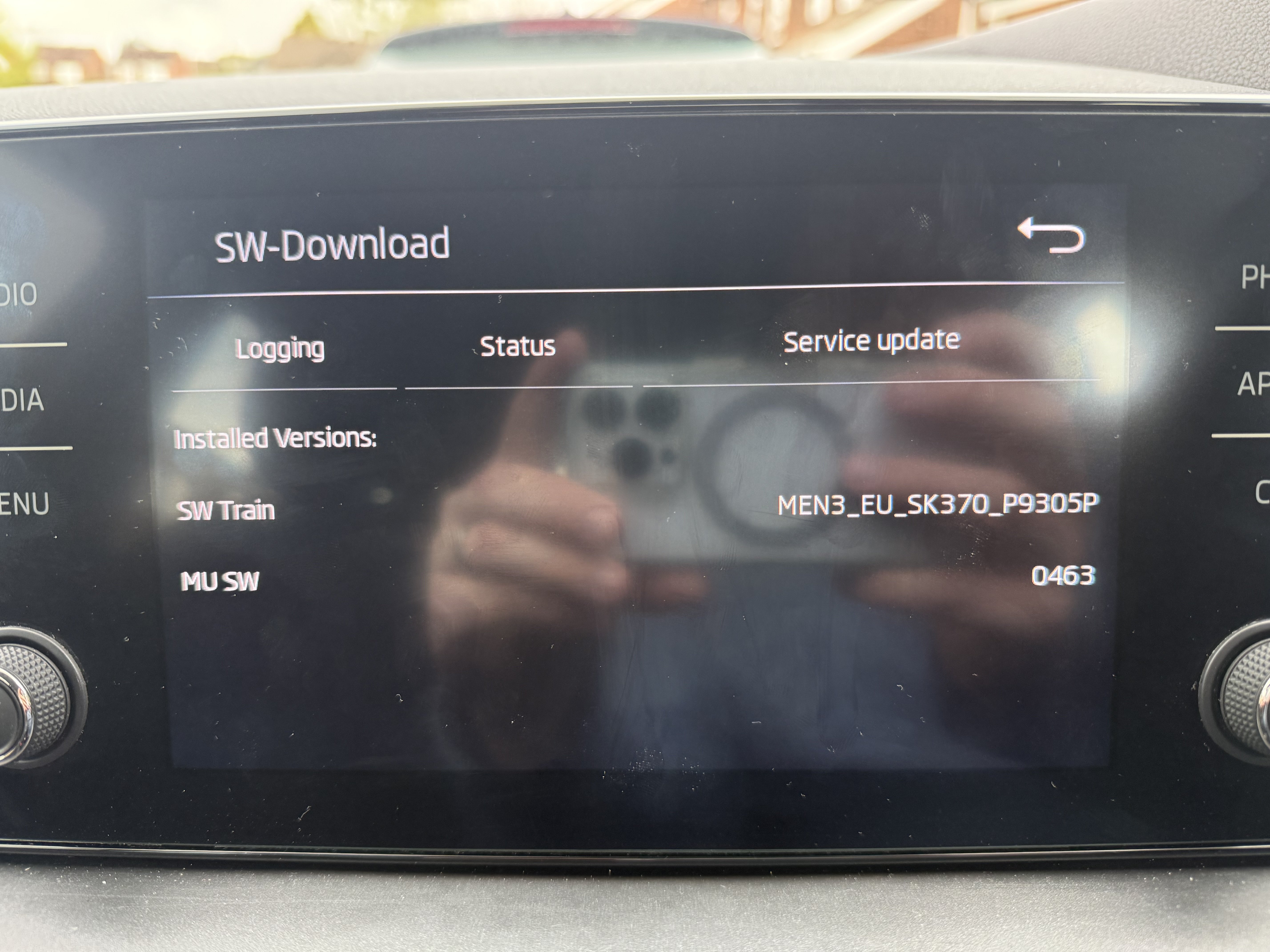

I love this thread. I have Scala 2019 with Swing, but SW TRAIN seems totally identical to Bolero. I have MEN3_EU_SK370_P9305P_MU0463, so what I have read, I need to install:
MEN3_EU_SK370_P0113P MU0469 -> MEN3_EU_SK370_P2131P MU0741 -> MEN3_EU_SK370_P2345L_MU1790 -> MEN3_EU_SK370_P2345L_MU1790 -> MEN3_EU_SK370_P3225L_MU1798 - > MEN3_EU_SK370_P3355L_MU1800
Am I right?
But where I can I get these FWs? I would love to send PM, but i guess, I need as a newbie to make another 19 posts?
Thank you
UPDATE: So I found on the internet all these FWs. Problem is - car doesn't see P0113P update. I was desperate, so I downloaded all these FW (everyone has own folder) together to flashdrive. Car see only two of them - P2345L and P3225L. When I try to choose of them, I see less than a second loading screen and nothing happens.
Edited by PeskyPerson
UPDATE2 (sorry, missing EDIT button) - So my Scala see only FW ending L. Any idea what is causing this? I have P9305P (MU0463) with activated wireless mirrorlink.
Well, without seeing P0113P MU0469 and P2131P MU0741, later "L" updates are unattainable.
UPDATE3 (last one) - Got it - MIB3_V1 - I can't get new FW than 742 with Wireless AA and old version. Well, still can't update to 742, but I guess, I don't have to deal with compatibility issues with some phones with versions 17xx and for now, wiping cash on my Vivo seems to fix wireless AA issues for now.

On 09/01/2024 at 18:15, tatutee said:
Hi again! I'm answering my own question here. So, I can confirm, that after updating to 1800 AA, after over a year, now FINALLY works on cable normally! I'm opening a beer now! Thanks for this forum! 😎 👍🏻

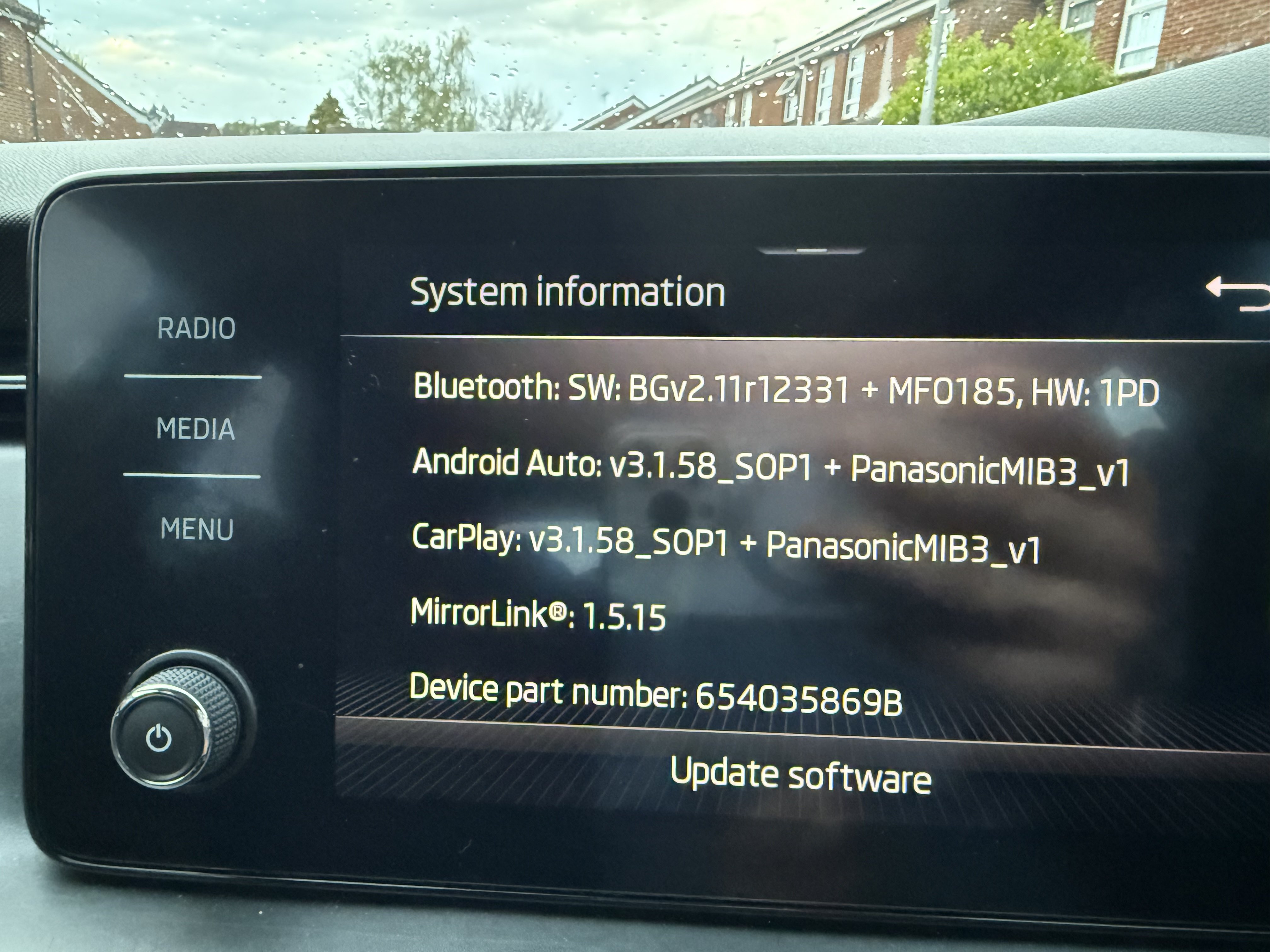

Hi,
I’ve been reading through these forums and found lots of useful info but cannot seem to get the firmware to be recognised by my car. I have a Scala SE 2019 and the infotainment seems to randomly freeze and reboot multiple times during a drive. I’m on version 463 and have read I should go to 469 then 741 and 742. I’ve seen people bricking the unit going past that so I’d rather not try any higher.
I found some files online but cannot get them recognised by my car on a USB formatted both Fat32 and exFAT. Does anyone have any other download or tips? I’ve seen something about a metainfo file but none of the downloads I have this file there. (Attached software versions screens from my Bolero unit)

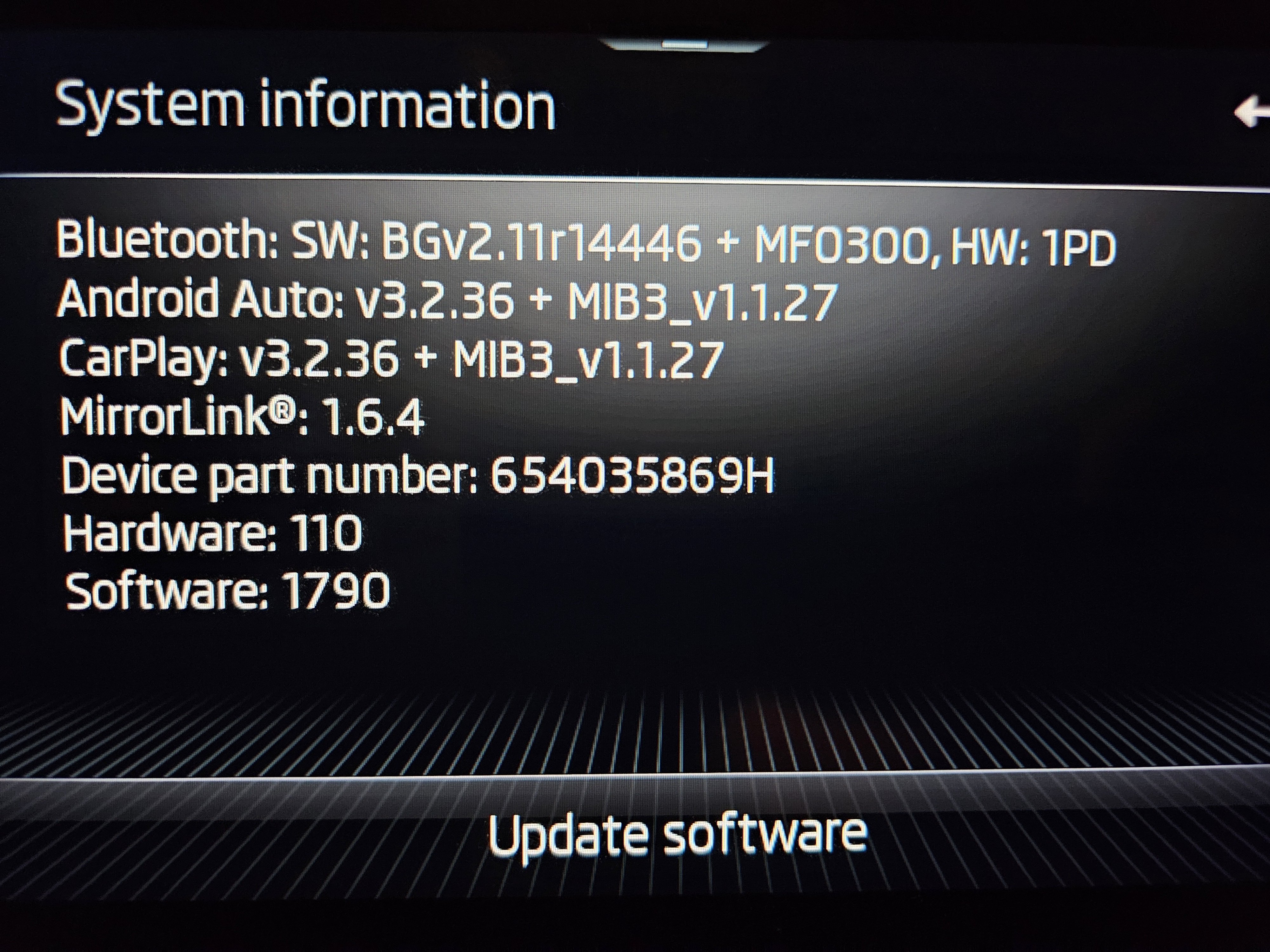

Hello,
Hi! How did you solve the problem with the USB-C device not being recognized? I have the same firmware as you (MEN3_EU_SK370_P2345L_1790) and I want to update to MEN3_EU_SK370_P3355L_1800, but my 32GB USB-C flash drive is not being recognized...
To large storage. Try 4 gb.
Hi, I tried to delete all the partitions of the 32 GB USB stick, created a single 4 GB partition in FAT32, copied the DATA and META folders to the main directory, but the radio still doesn't recognize it. Any other ideas?
It is in the topic but as I remember folders data and meta should be in folder named by fw, not in root of drive.
Great, thank you! That was the answer I was looking for! I confirm that by copying DATA and META into a folder named FW, the radio recognizes the USB stick and the availability of the update! 👌👍
I still couldn’t get it working! Any chance you can send a screenshot of the folder structure on your USB drive? And did it work with partitioning your drive to a smaller one?
I used a 32 GB USB-C stick, and using the Windows Disk Management tool (WIN + R, diskmgmt.msc), I first deleted the existing partition and then created a new 4 GB one formatted in FAT32. At that point, I downloaded firmware version 1800 from mibsolution.one (though the link hasn't been working since yesterday).
I extracted the downloaded file and found two folders: META and DATA. I created a folder called FW on the USB stick and copied the two folders inside it. Then I went to my car, turned it on, removed the USB stick I usually use for music, inserted the one with the update, turned on the radio, waited about a minute, and the update process started
Perfect. Thanks for that. I’ll give it a go and see if I can get it working.

Hallo,
i would also update my software from 0469 to the latest available version (ambition). Where can i find those FW? I saw that you got it in the forum here.
My connection issues (cable and bluetooth) with android smartphones are there from the beginning (2019) where i got the Scala (1.0 TSI 85 kW/ DKRF). In android auto (see smartphone) you are able to activate developer options. In former times i used software from AAAD/ Android Auto Apps Downloader. There i was able to use different navigation-software. Do you know Fermata-Auto from XDA?

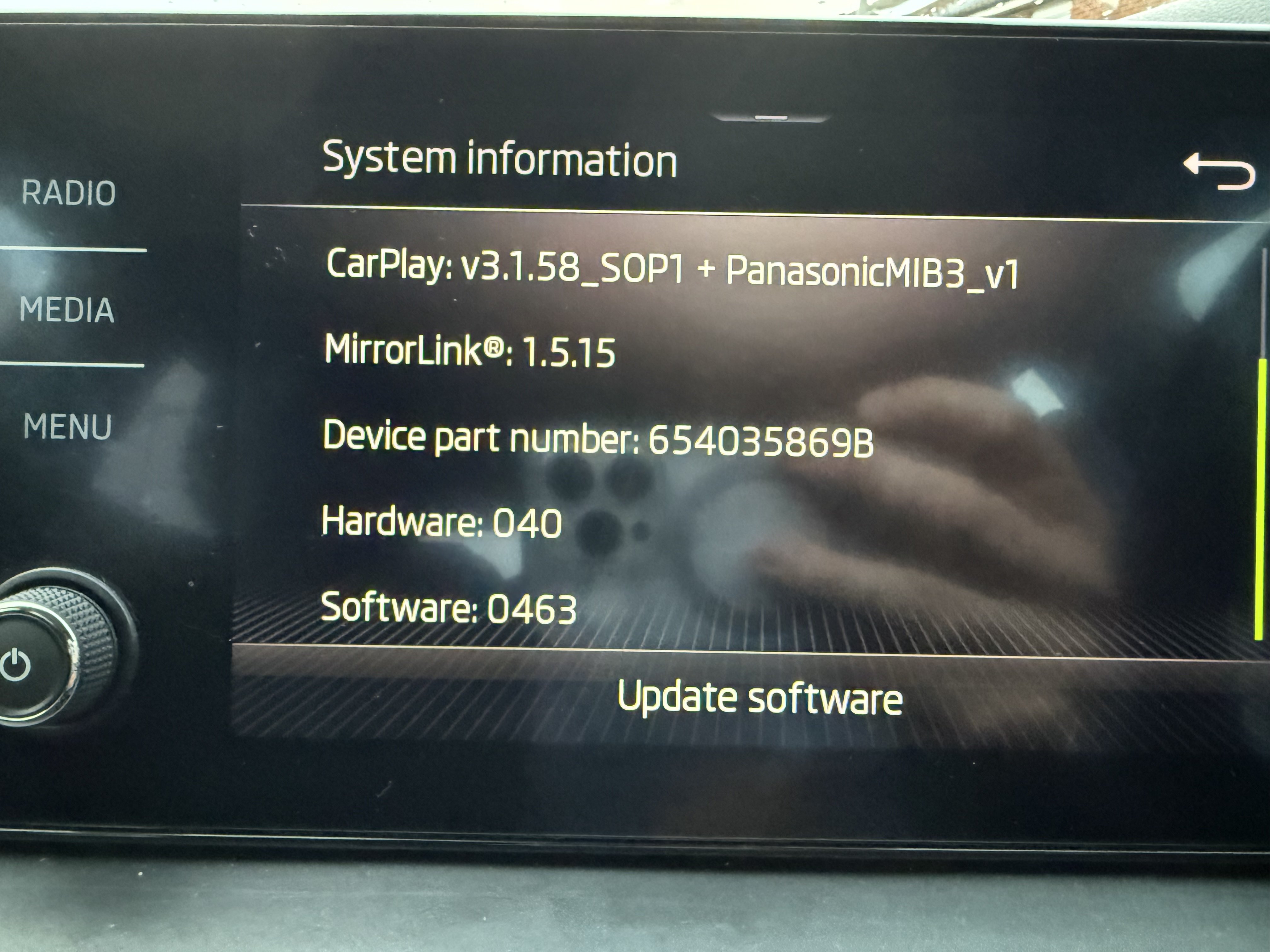

Here is my current firmware info:
SW Train: MEN3_EU_SK370_P9494P
MU SW: 0464
Bluetooth: SW: BGv2.11r12331 + MF0185, HW: 1PD
Android Auto: v3.1.58_SOP1 + PanasonicMIB3_v1
Carplay: v3.1.58_SOP1 + PanasonicMIB3_v1
Teilenummer Gerät: 654035869B
Thank you very much!

Can someone give me also a note where to get it?
I think that Software 0472 is the latest version, isn it?
