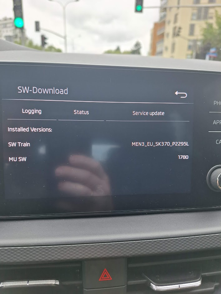

    I just updated to 1800, I have a Skoda Slavia in India with the Bolero system. I can confirm that the issue with S23 Ultra is finally resolved! Attaching images.

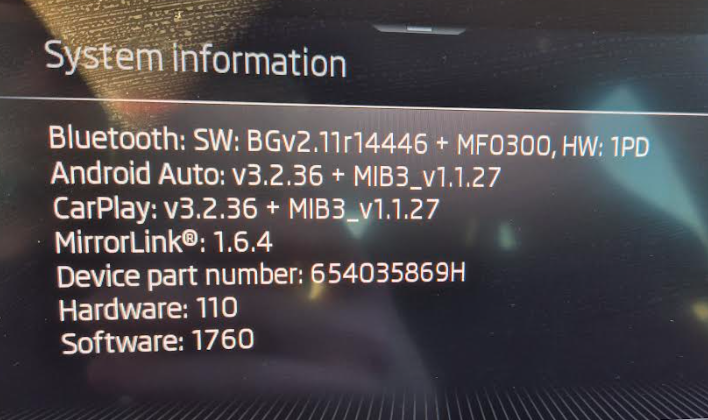

Hello, can you please help me?
I have škoda Scala 2019 with this infotainment version.
The car has problems with my phone Motorola edge 50. It is still disconnecting and wrote problem with hfp. The another problem is with radio, sometimes is bad signal, but on another car the signal is ok. And the last problem is after turn off engine and turn on are not showing data about last drive on maxi dot.
Please is possibly resolve it with update infotainment? And is possible install version 1800? By mib-helper the last official version is 1760.
Thank you.

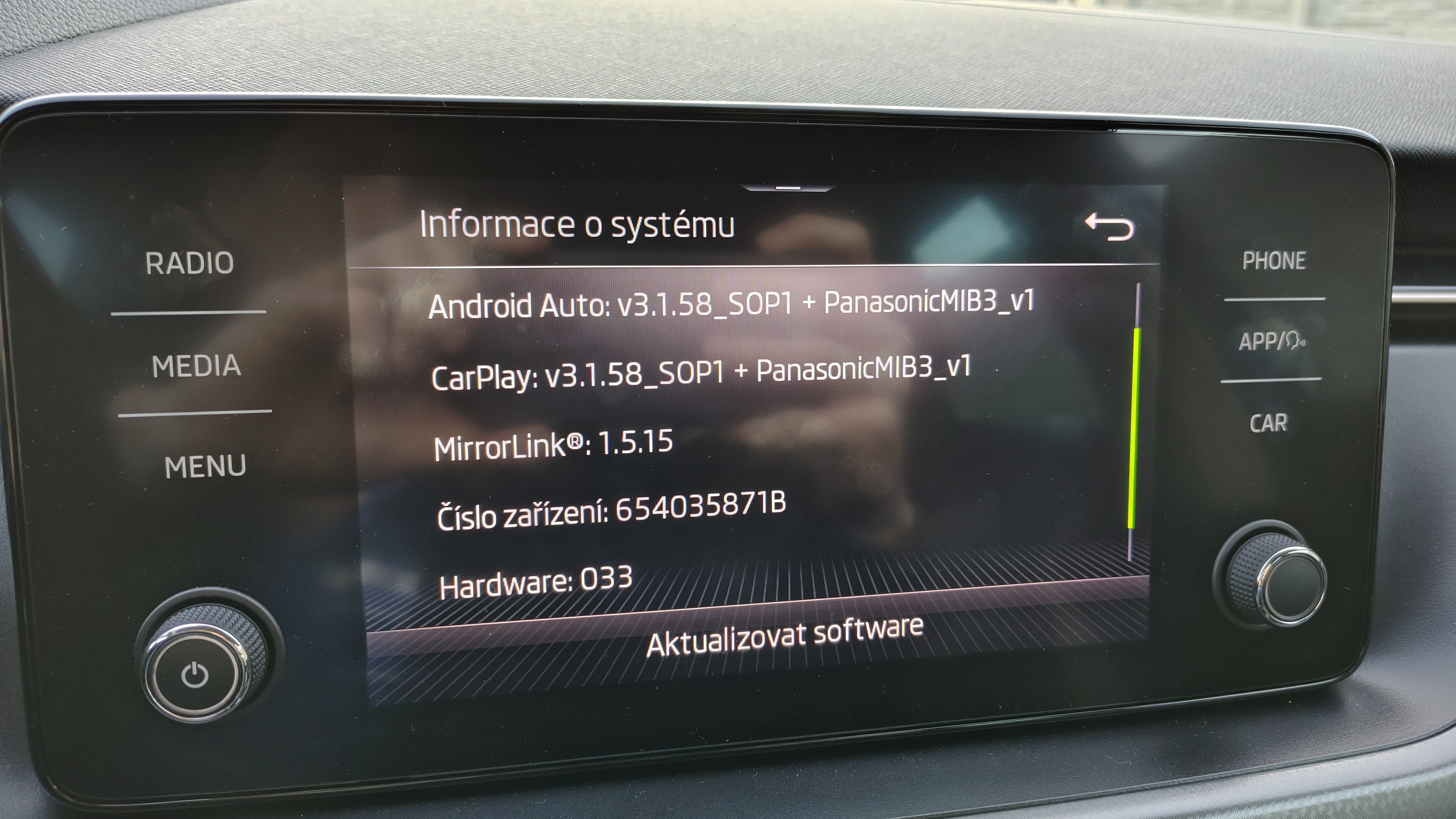

On 13/10/2023 at 06:55, kuyon said:

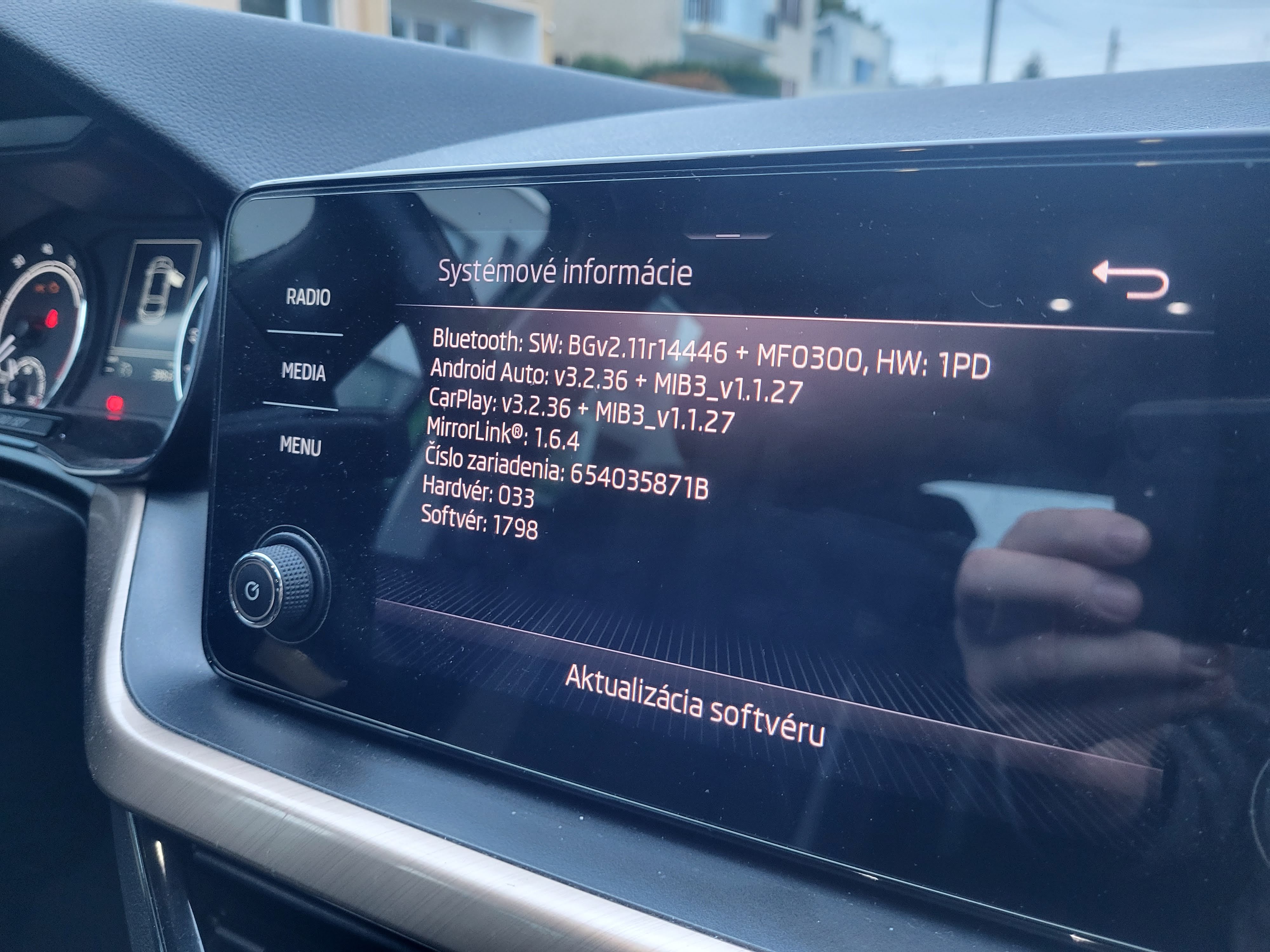

AHello, I'm from Slovakia.  I followed this link:
https://www.drive2.ru/l/650934799095051499/
Everything went well.  My goal is to activate the wireless android car after purchasing the official activation key here:
https://eshop.skoda-auto.sk/sk_SK/smartlink-wlan/p/6VA054830B
I requested the activation of wireless WLAN in the official service.
Unfortunately, the activation was unsuccessful after several attempts.  The detected bug is said to be higher installed software 1798.
My car is from 4/2019 and this model has the latest official software 742.

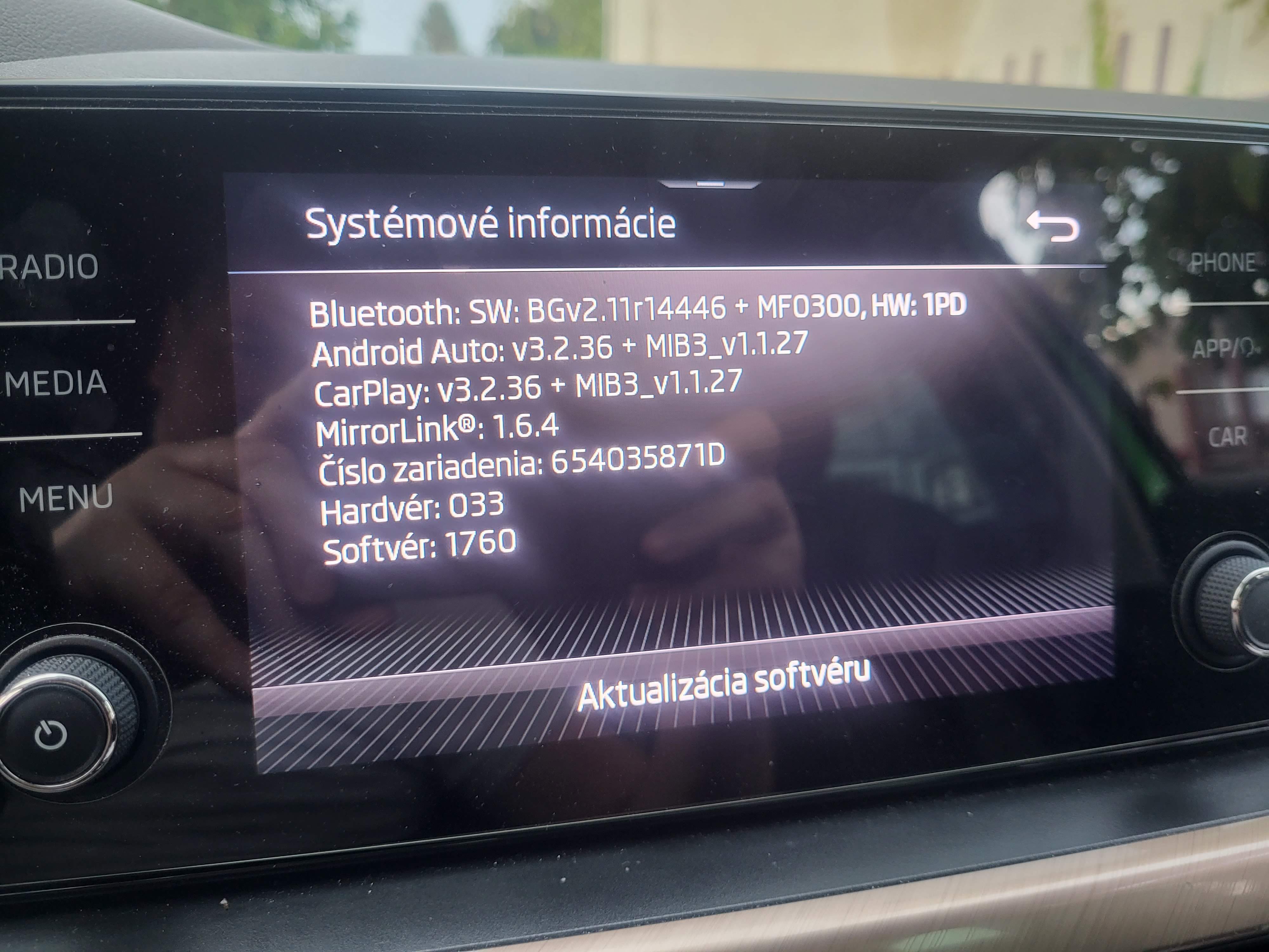

After returning from service I reinstalled my MIB3 unit to version 1760 successfully.
The problem is that after formatting the USB I can't see the 742 software file. I don't understand when I've already successfully installed it once before.
Friends, I need file 742 or older from another source for testing, so that the system in the car can see it on USB and be able to install it.
Can any of you send it to me?
PS:Please note that I tried to change the final letter P to L without success
My source files where the 742 USB software does not see
https://disk.yandex.ru/d/1V1uBTc8ssc3zA
I am sending a picture guide: 1. The USB, when plugged into the car, sees these files without the 742 version.
2. View all files saved on USB on mobile or PC
3. and 4. The picture shows the different installed versions in MIB 3
Hi,
if I understand correctly, you updated the version on 1798 for car from 2019. And after went back to 742 for some reason. Can you please tell me why.
In another post you wrote that the max version is 742.
I would like ask you, is possible to update higher version than 742? For example 1760 or 1800?

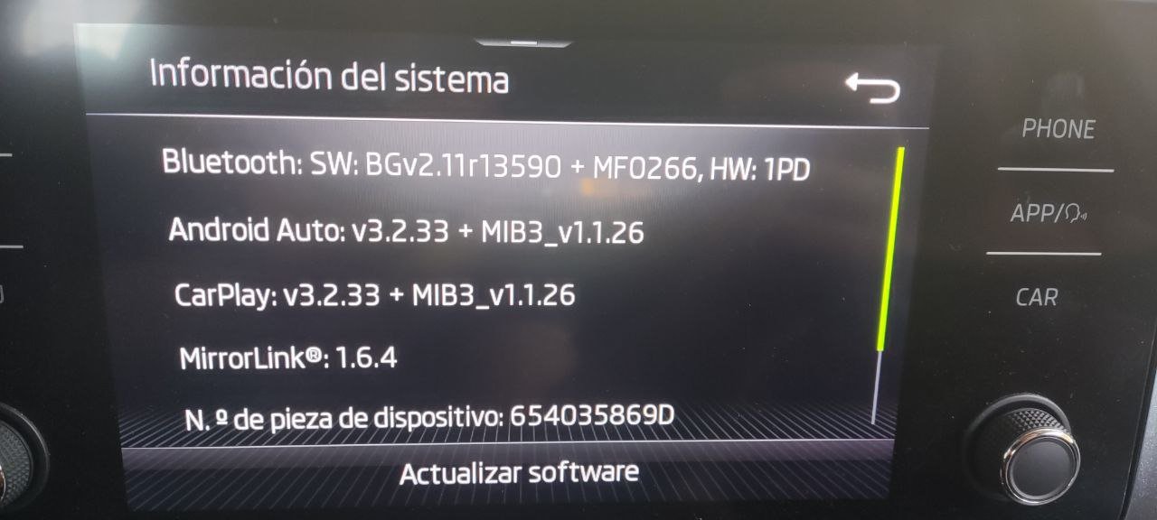

Hello, I have bought a 2021 Skoda Kamiq and I wanted to update the Bolero system because I have freezes and disconnections. I am posting photos of the system I have and what software you recommend I install, thank you.

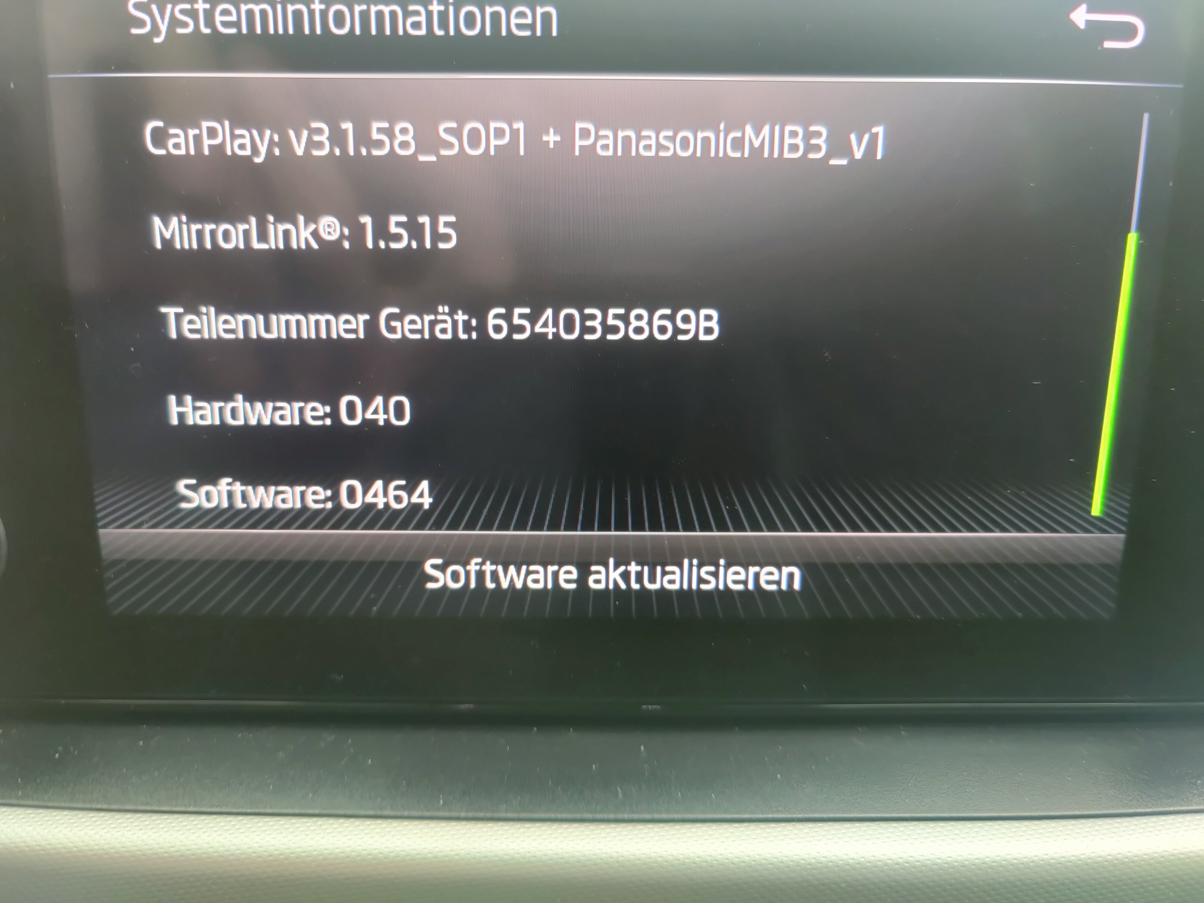

Hello,
I have 2020 Kamiq with
MEN3_EU_SK370_P9494P_0464
HW: 040
Could I ask you for files to update to maximum supported firmware?
@varooom maybe you are able to help?
Thanks :)

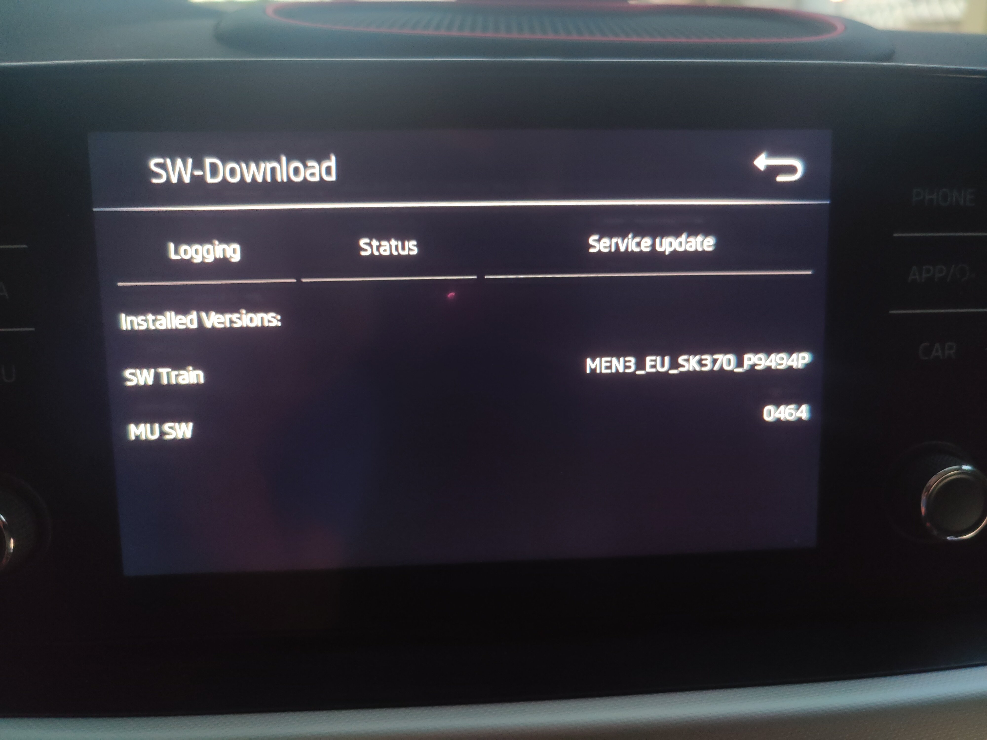

On 07/08/2025 at 10:27, ziolek33 said:
Hello,
HW: 040
Thanks :)

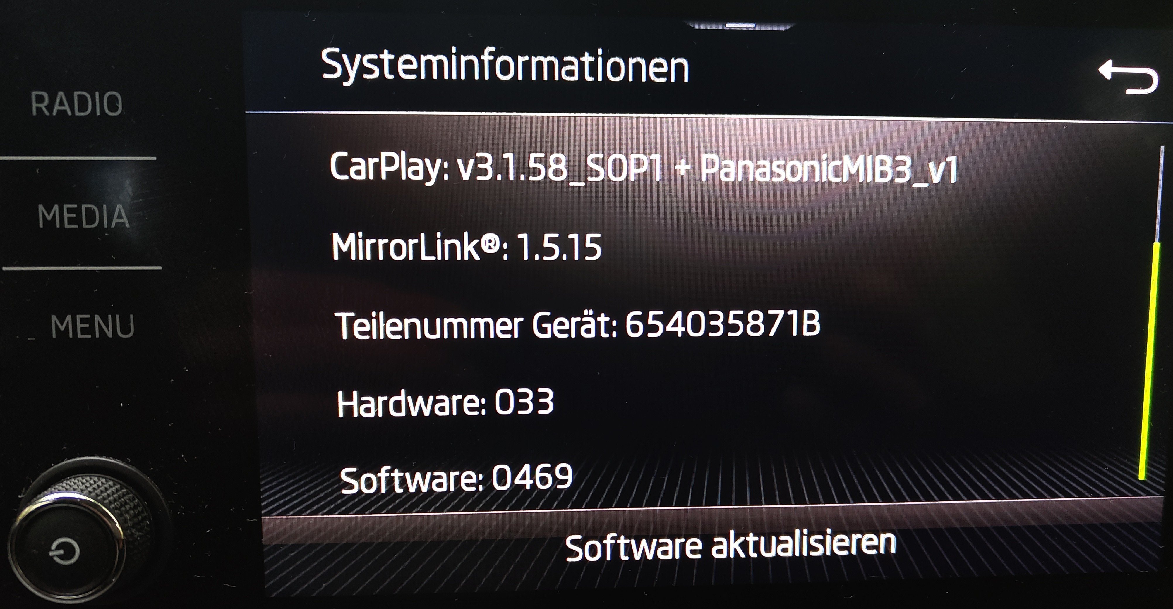

Hello,
I also have a Kamiq 2020 HW 040, 654035871B. I managed to upgrade MIB3 from version 464 to 1800.
My procedure: 0464 => 0469 => 0741 => 1790 => 1798 => 1800
Download from OneDrive: MEN3_EU_SK370

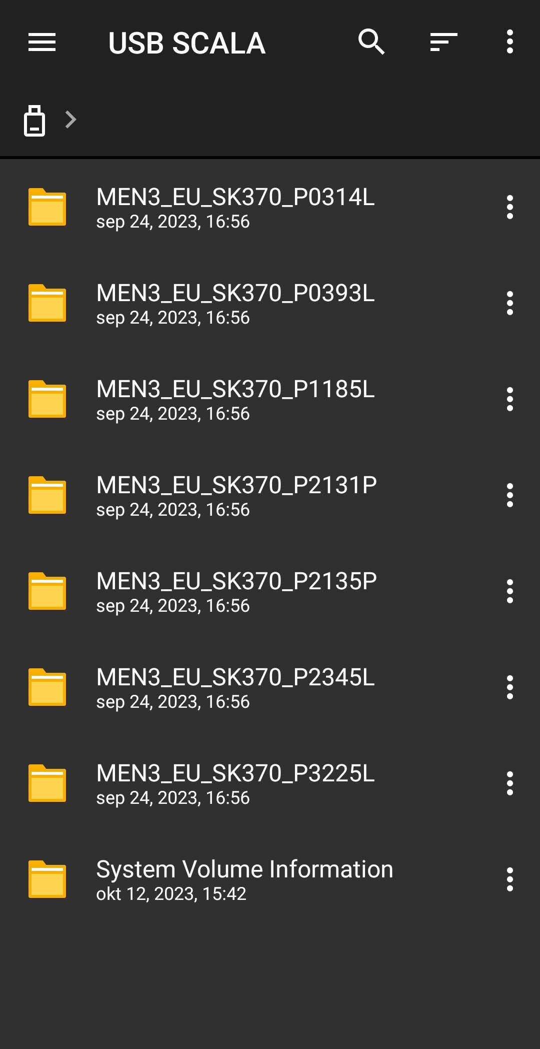

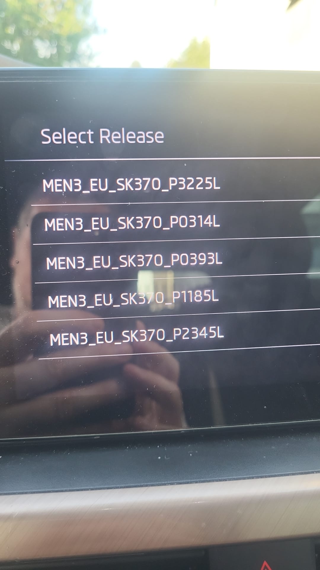

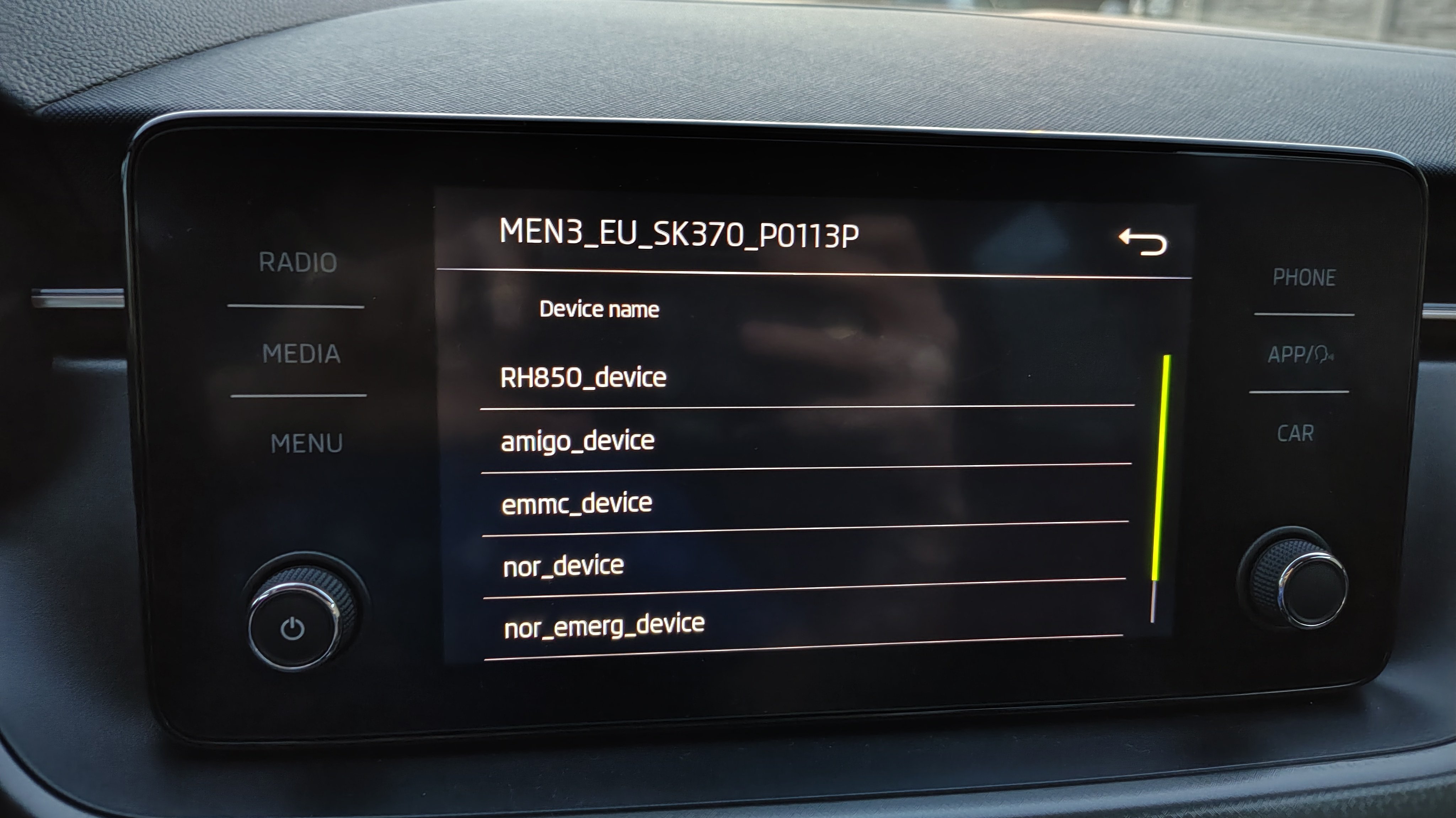

Hello,
I have a Scala 2020 and my android auto (wired) is not working after getting a new phone (oneplus nord 5).
I read that it may be because my bolero system fw is old.
I checked with mib-helper.
My version is Firmware version: P0113P
According to MiB helper Latest official firmware update is: MEN3_EU_SK370_P1185L
I have the files for P1185L on a FAT32 usb stick.
When i try to do the update nothing happens. The car finds the files on the usb but when i press on it nothing just happens (see video).
Can anybody help? What am i doing wrong?

i don.t thnik you got the correct firmware.
469 is update to 741+742 - the last official firmware for your hardware.
you are trying to update direct to 1800, a version for different hardware.
Edited by andreiro221
What would be the correct update? I thought what I had is the correct as it was recommended by mib-helper.
Currently what my MIB has is:
SW Train MEN3_EU_SK370_P0113P
MU SW 0469
What was said before: 469 is update to 741+742 - the last official firmware for your hardware.
