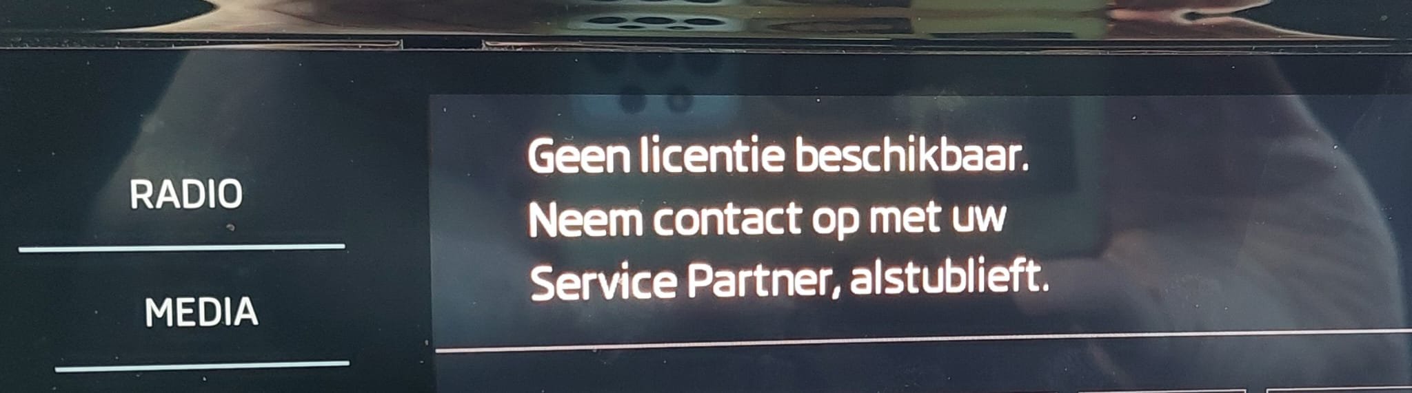

Hi All,
I've upgraded my infotainment but Skoda Connect doesn't work.
I've done removal of Skoda Connect account through the My Skoda app. And also put the infotainment back to Factory Default.
After adding the car in My Skoda app, recreating Skoda Connect account. It tries to activate my car. But the car doesn't accept the Code on that site and put in Car screen keypad.

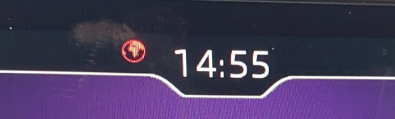

When I press  the Info or Repair buttons (not sure about translation but it's the two button next to ceiling light with the  'i' and the 'tool') it gives this message;
Is it possible to downgrade the software to see if Skoda Connect picks up again?

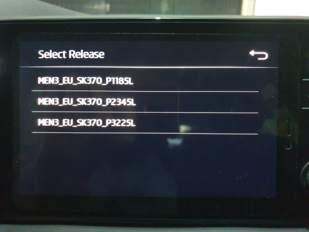

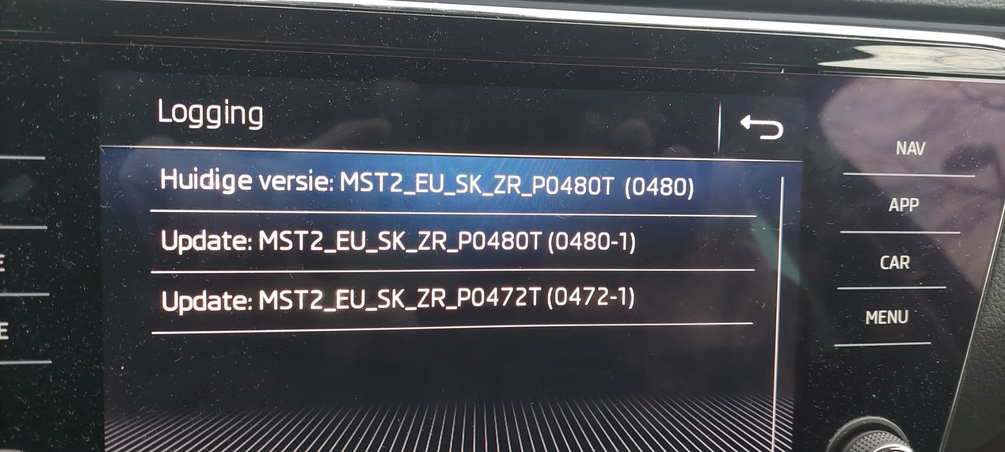

I have MST2_EU_SK_ZR_P0478T available to me, although my original firmware was MST2_EU_SK_ZR_P0472T.
I assume this red sphere also indicates something is wrong?
Thanks for helping out!
gr. Tom

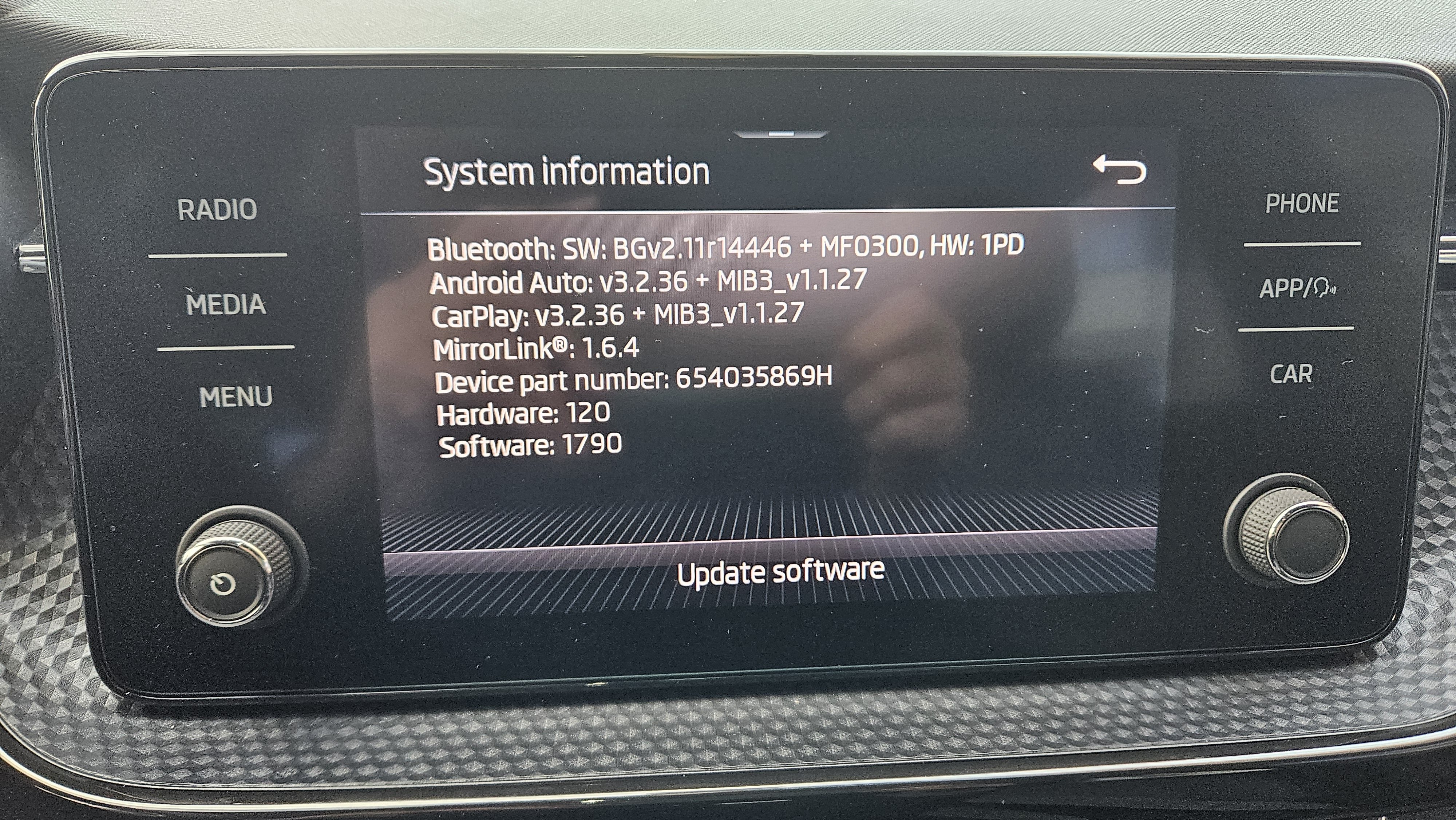

Hello,
I got Kushaq 2023 in UAE which seems to be made in India. I guess it is India specific model.
With my Samsung S23 Android Auto only works in wireless mode but NOT via cable. I tried different cables. Also I found that there no issue with other phones like Oneplus 12, even Samsung A53.
Following is my SW Details
I have ready that many people have updated to 1800 and their issue was resolved. My local service center simply refused stating that there no update.
Since I have read this thread carefully, I have few queries. Any help will be really appreciated.
1) I need to update to 1798 then 1800 - Is my assumption correct?
2) I need to format USB with exFAT or FAT32. I have 128GB Type C USB drive. - Can I make smaller partition of exFAT or FAT32 ?
3) Can I just put car in ignition on and do update? I did not understand "Battery on charger" thing.
4) How long update takes ? From 1790 to 1798 and 1798 to 1800.
5) Can anyone share again latest update files for 1798 and 1800
Many Thanks in advance.

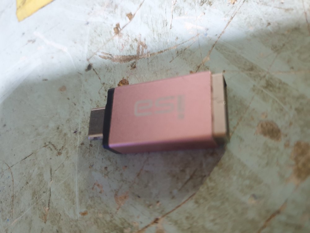

1. I updated immediately from 1310 to 1800 without intermediate updates. Everything became OK. 2. Use an OTG adapter and a 4 G flash drive (I did this) 3. Connect the charger to the car battery. When the voltage drops, the process may stall at an incomprehensible stage. 4. See point 1 – the whole process took about 20 minutes. 5. There is a file (MEN3_EU_SK370_P3355L_1800). Where to pour it?

Thanks for quick reply.
I have 128GB USB with Type C , I did make exFAT partition of 16GB out of it.
It is not getting recognized.
I do not have charger to connect to battery ,but will voltage drop in just 20 mins.
Can I run with ignition on?
I got files from link in earlier posts.

So I updated with ignition on , first to 1798 and then 1800.
I can confirm that Android Auto is working with my S23 via Cable and also via wireless.
This was really bugging me since I bought this car last year !
Many Thanks for this community.

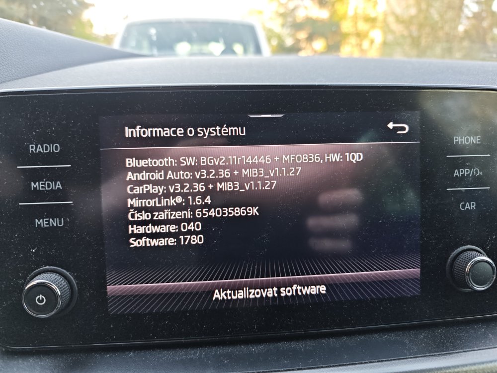

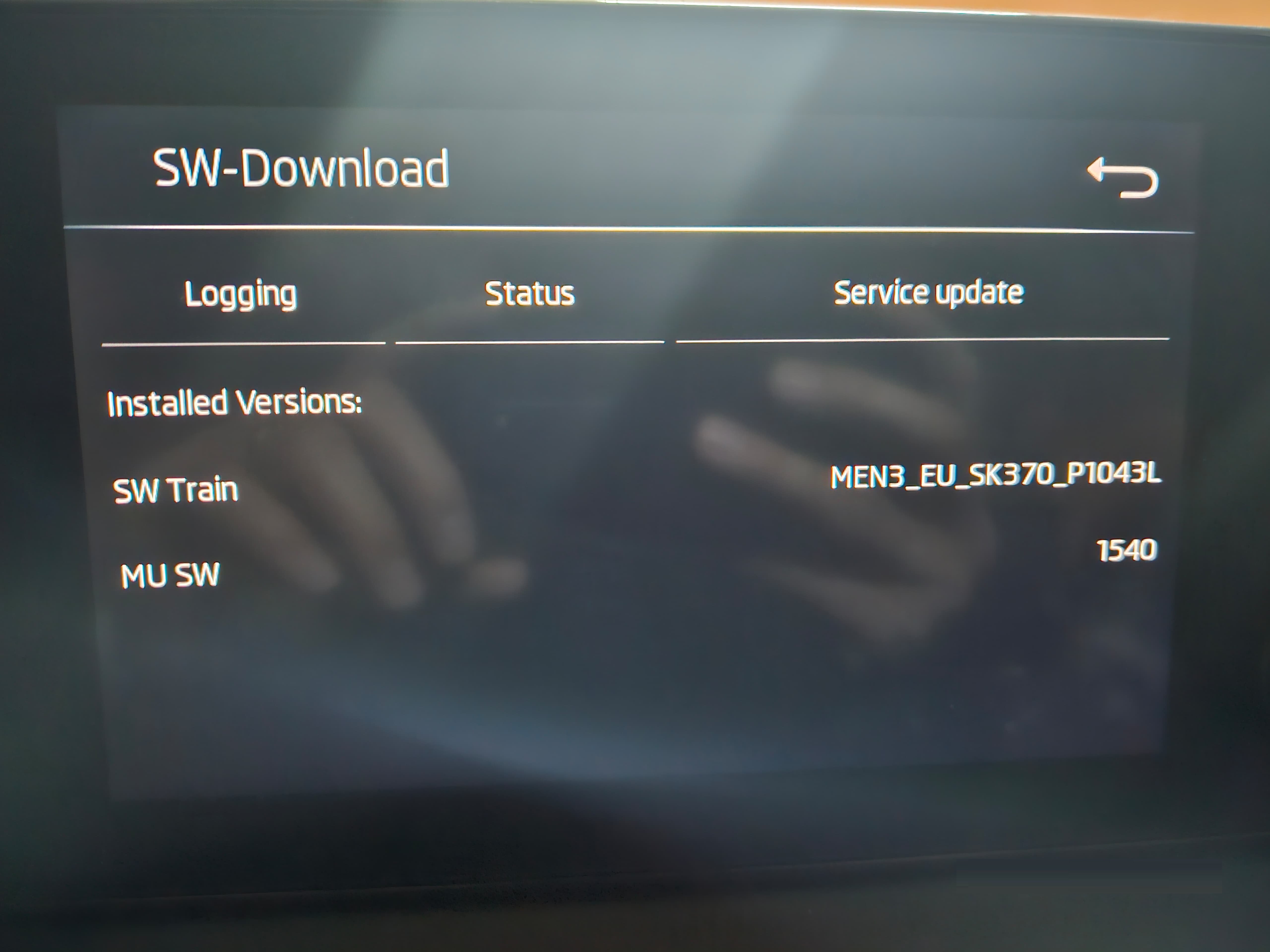

Hi everyone,
I read all of the messages on this topic. Everything is clear, but the version of my car seems unique. Only one guy mentioned the same version, and no one replied to his message on this topic.
My car's current version is MEN3_EU_SK370_P1043L and its MU SW is 1540. My question is; to which latest version can I update from the current one? And I want to learn if we need or if is it a suggestion to update every version step by step until the latest one.
Thank you very much for your help!
On 25/02/2025 at 10:25, dnzhi said:
Hi everyone,
I would also like to know the answer to this.
I would try to update directly to 1800. Yours fw version seems to be somwhere between 1310 and 1760, as they are available on the Internet.

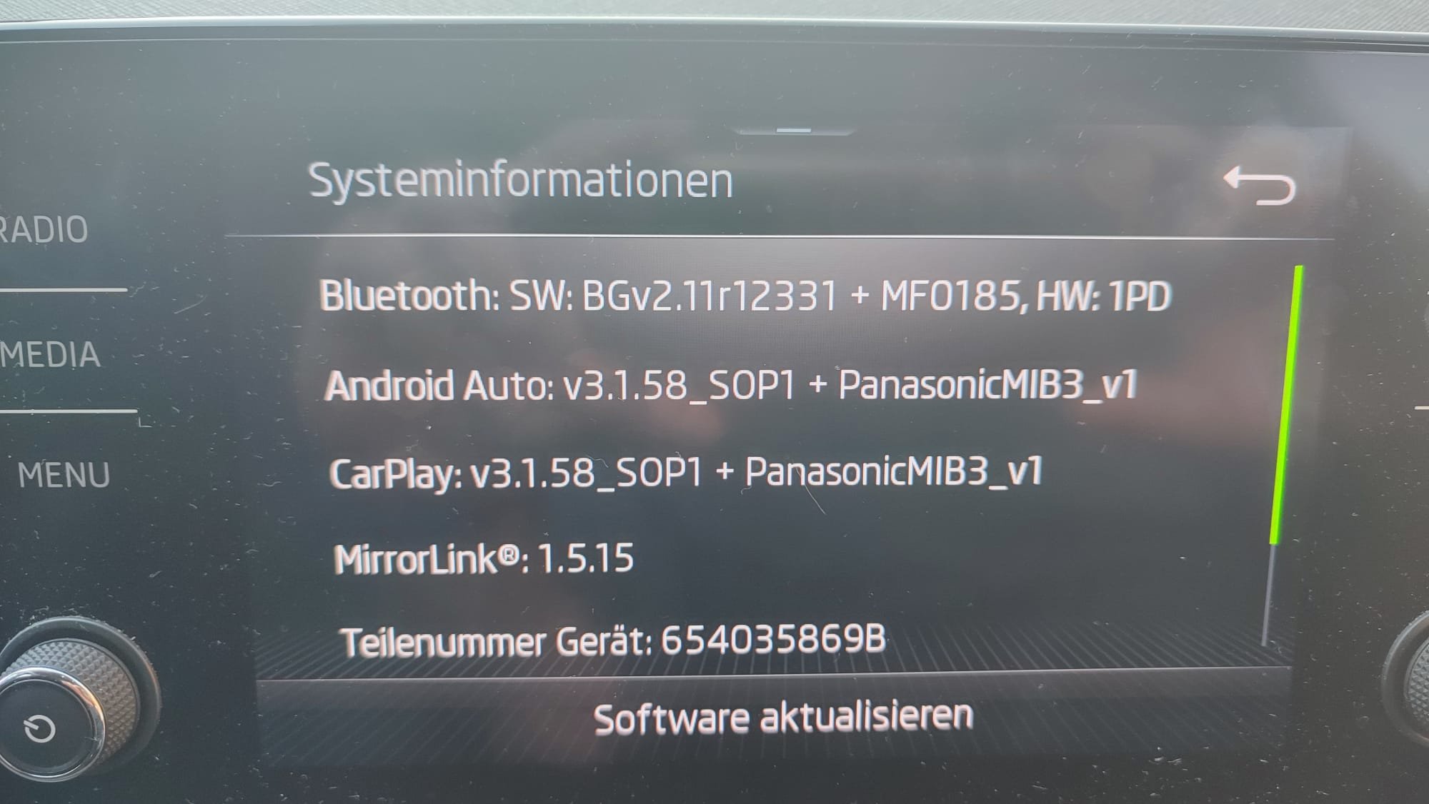

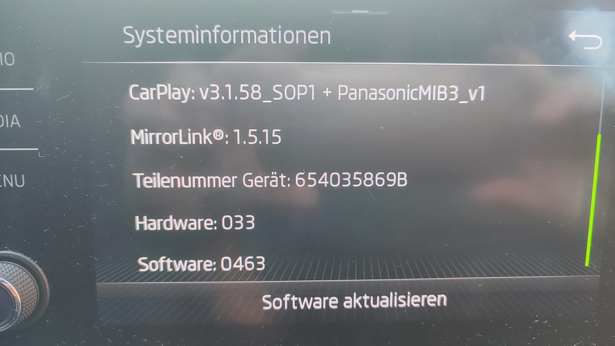

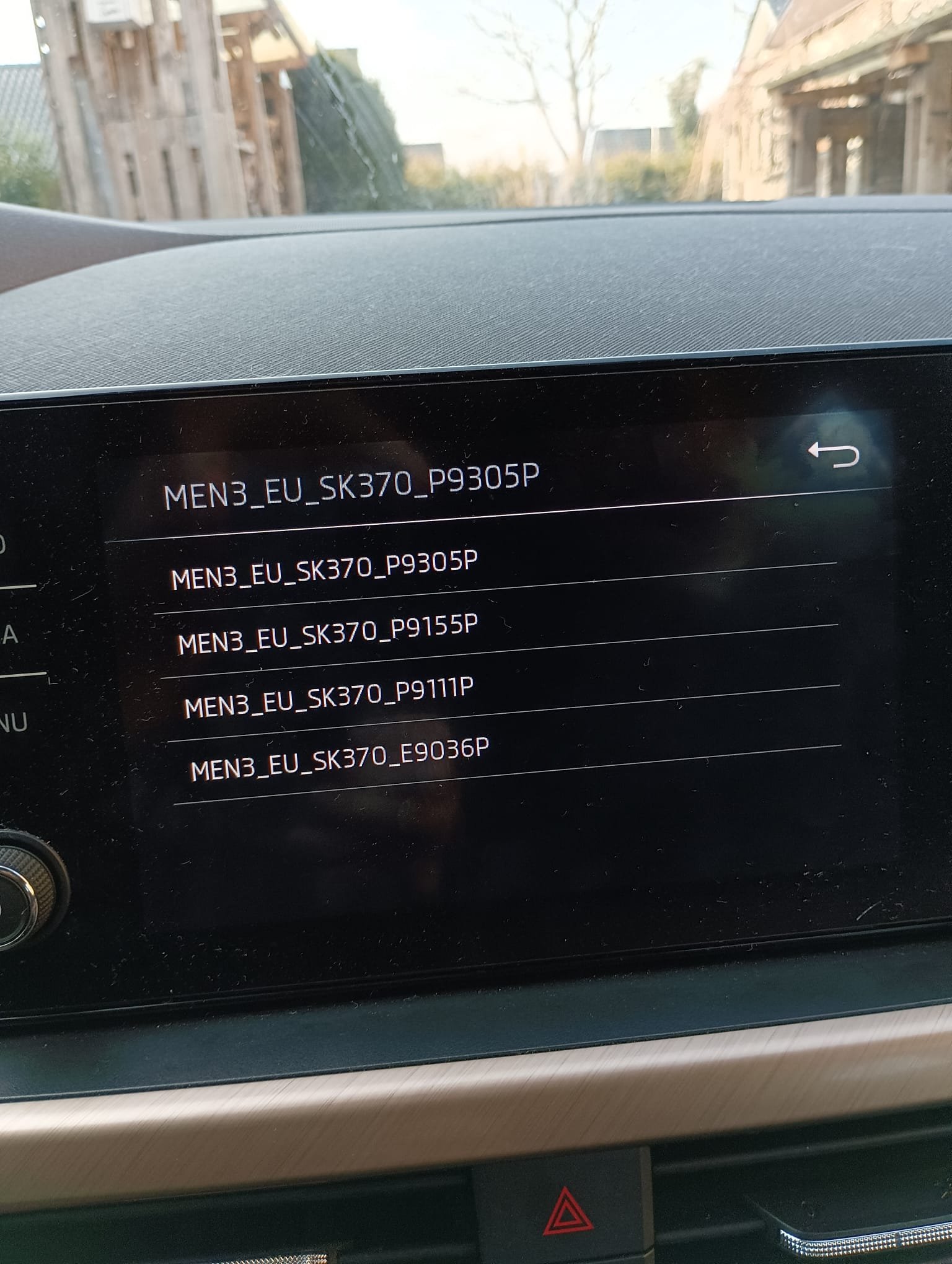

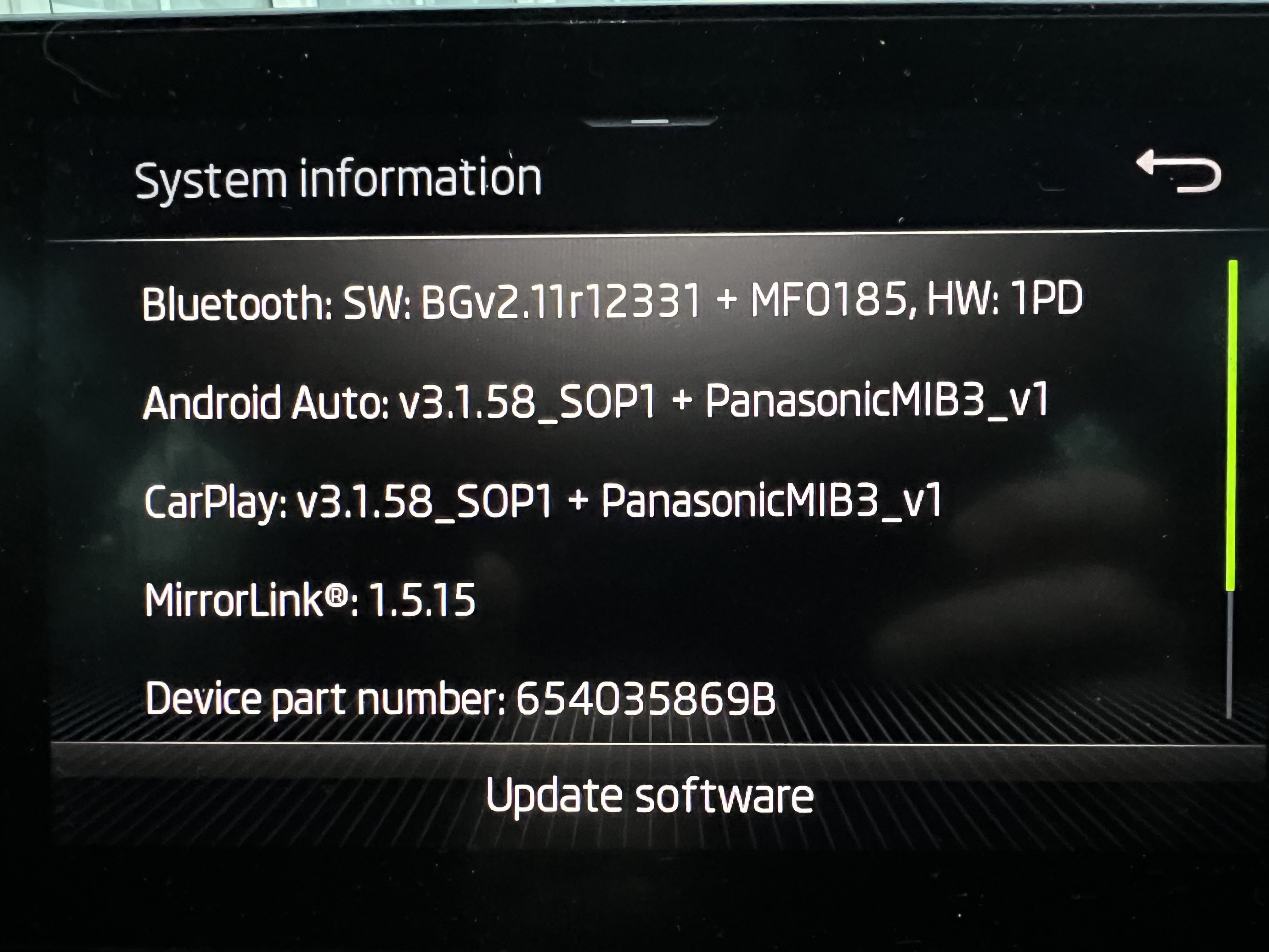

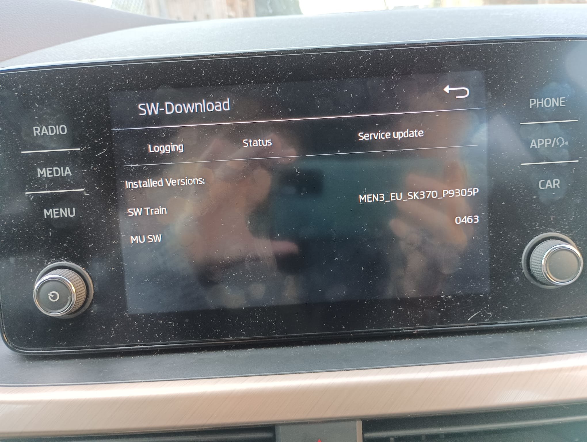

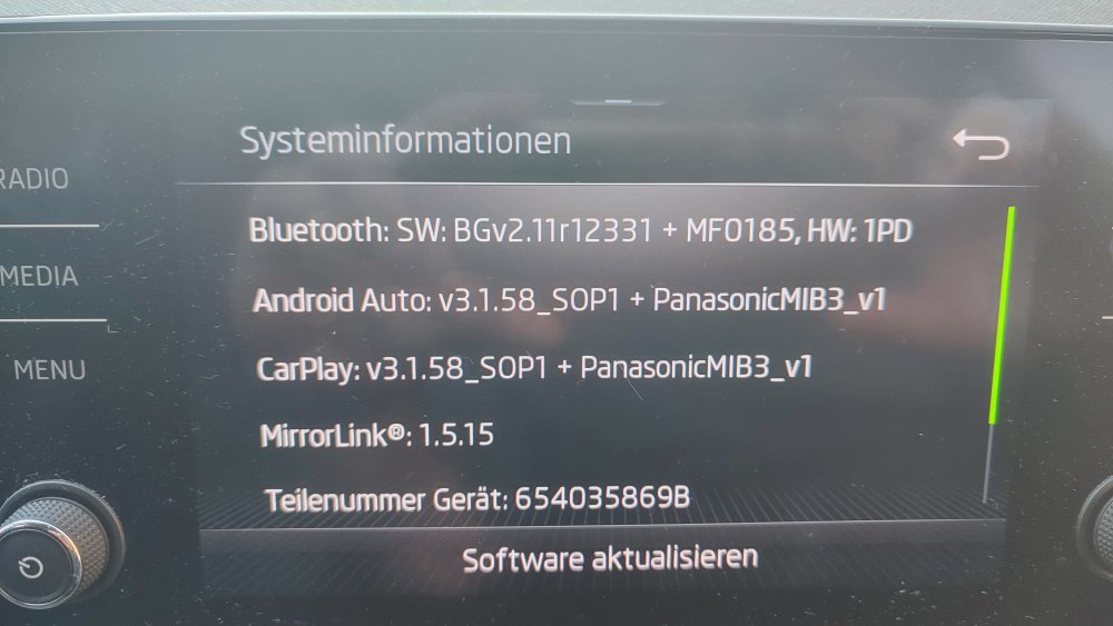

Hi all,
I have a Skoda Scala built in 2019 and a Bolero radio.
Version: MEN3_EU_SK370_P9305P MU 0463
My questions:
  1. Up to which last version number can I update the radio?
  2. In what order do I have to install the versions?
  3. Where can I get the versions and is there an installation manual?
Thanks and best regards
Nilz

19 hours ago, Nilz said:
Hi all,
My questions:
Nilz
Sytem-Info
Current Version:
Logging:
Have you read this topis ? All answers are in it.

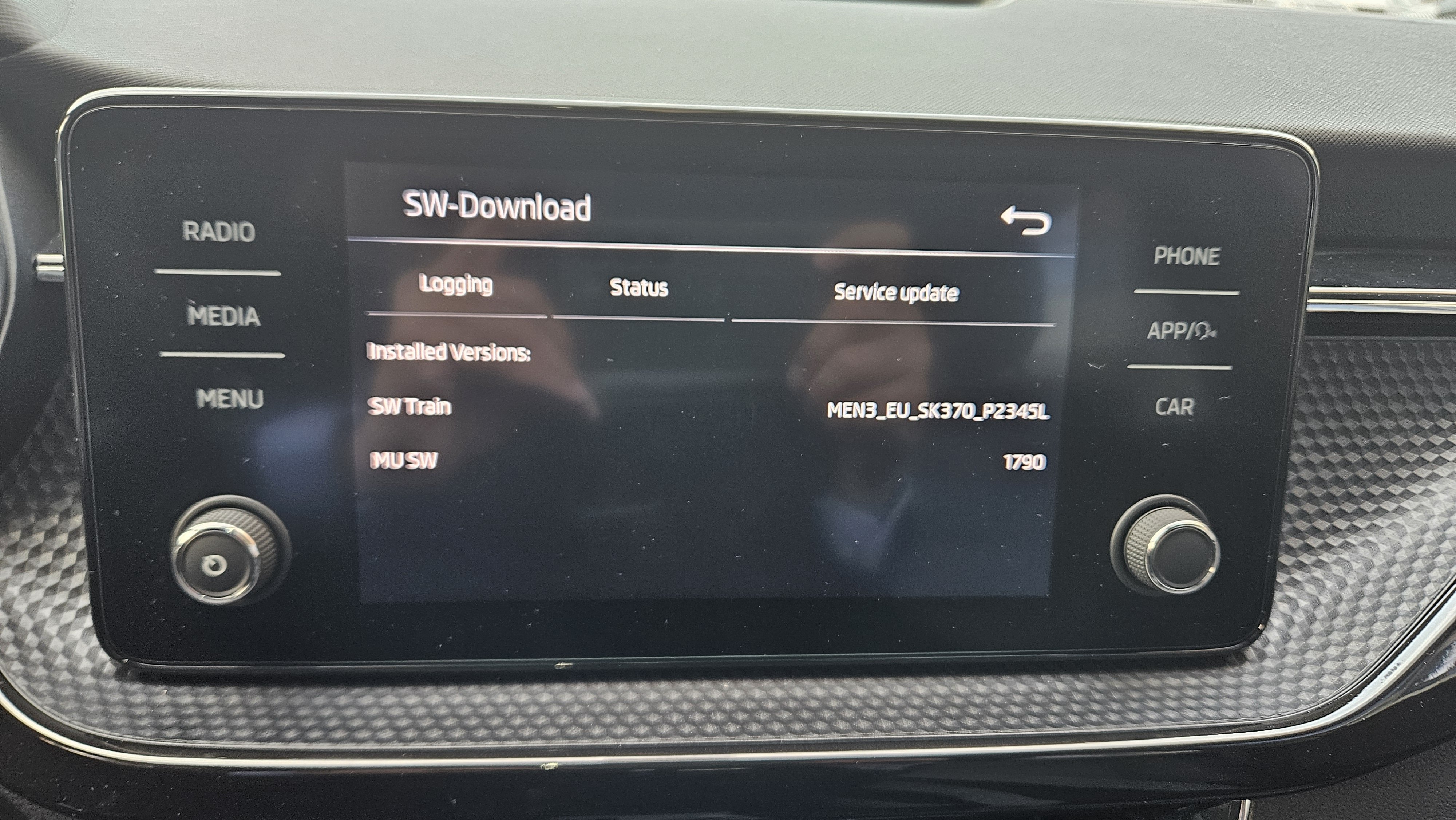

Hello all. I wanted to update the topic.
I updated this strange software to version 1760 > 1790 >1798 and 1800. No errors appeared during these updates.
AA just worked flawlessly on version 1800.
