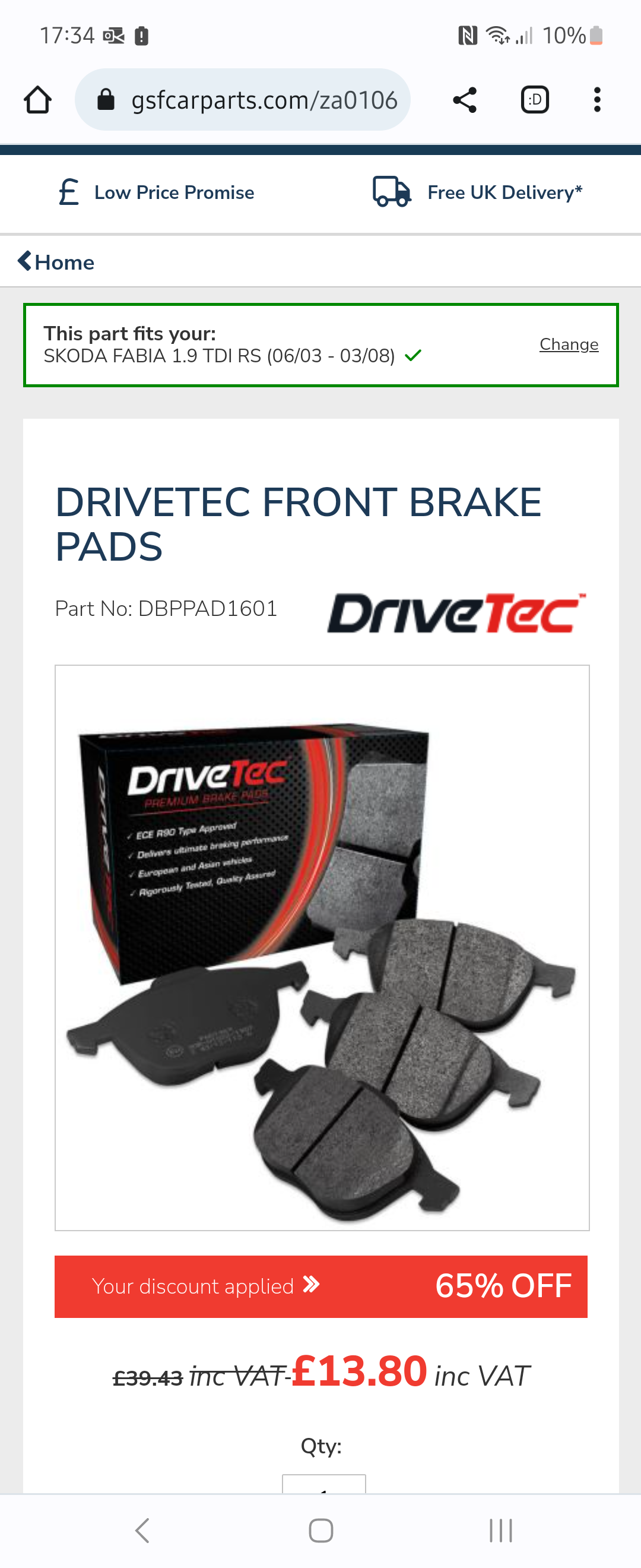

They look like genuine pads, I'll try send you a picture of the style I currently have, and the style they sent
  • Sponsor
Cool, GSF part number of what you've been given would be handy too.

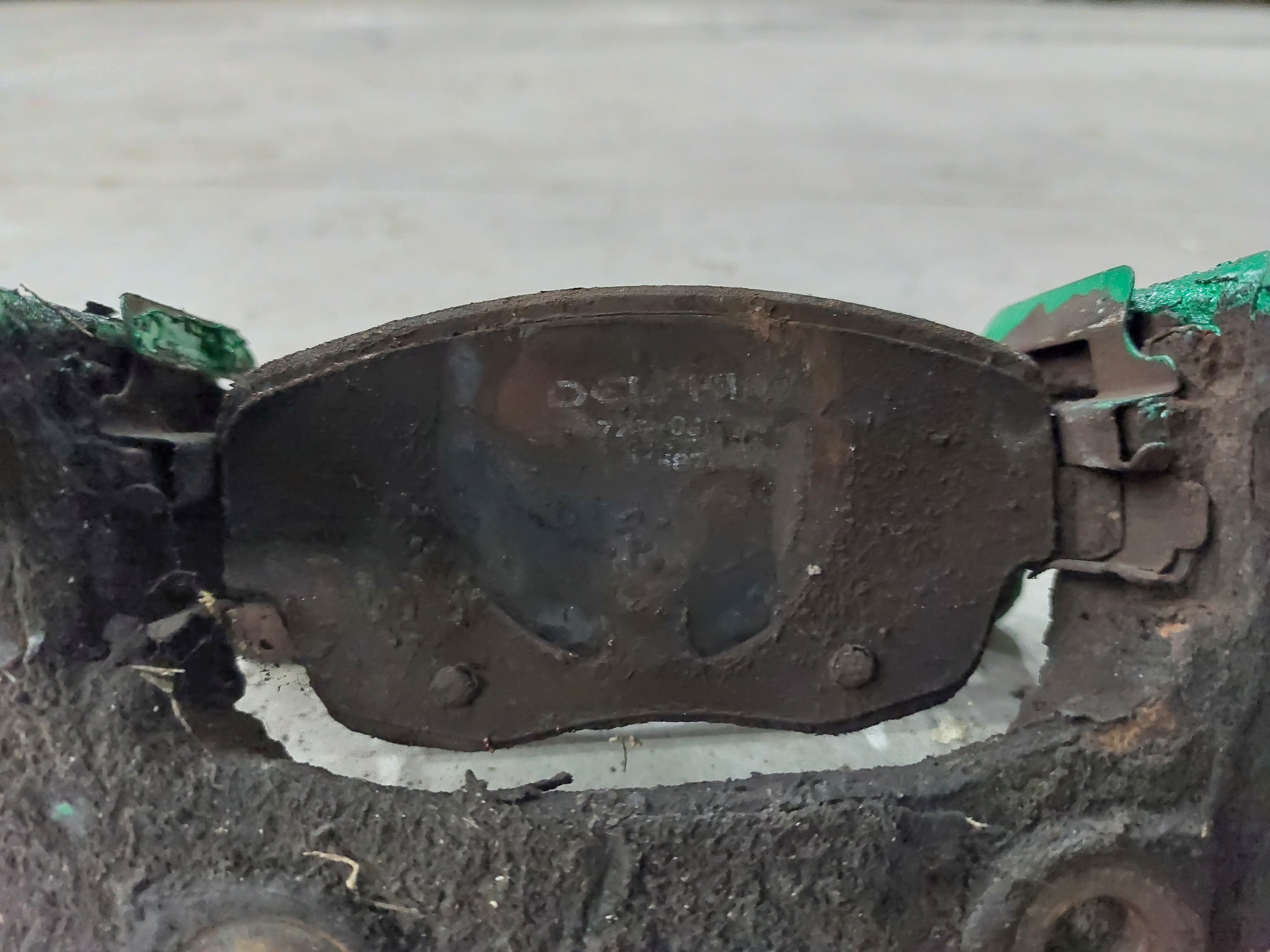

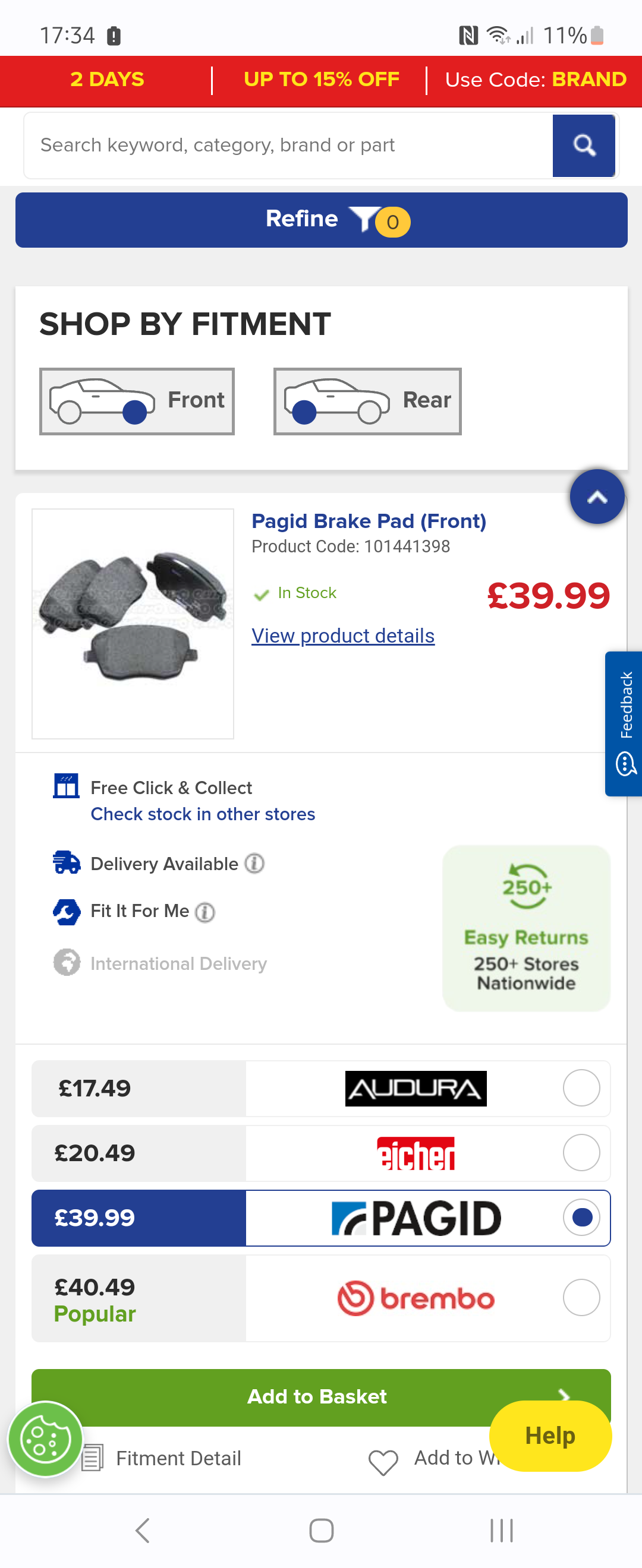

So the pads that are currently fitted look like the pagid shape, and the GSF ones the drive tech shape.
The part no is DBPPAD1601 for gsf
  • Sponsor
Looks like you do have standard (288) brakes I think, and GSF have duff info in their system.
Is there any marking cast into the calipers, possibly the code "DS3"?
A VRS has the same front calipers as my tool eater, Lucas calipers for 288mm discs, GSF have given you pads for ATE pattern calipers which won't fit.

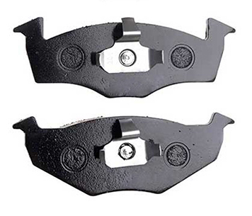

So what style of pads will i need, the pagid ones I put up?
  • Sponsor
First two results here show you what genuine ones of the correct part number look like. Prices seem OK too. 6Q0698151D for sale | eBay
Perfect, thankyou dude

First is one for your vrs no hook
Second is the ate ones
You've already been sorted but this might help someone in the future
28 minutes ago, sepulchrave said:
I meant what I said and said what I meant.

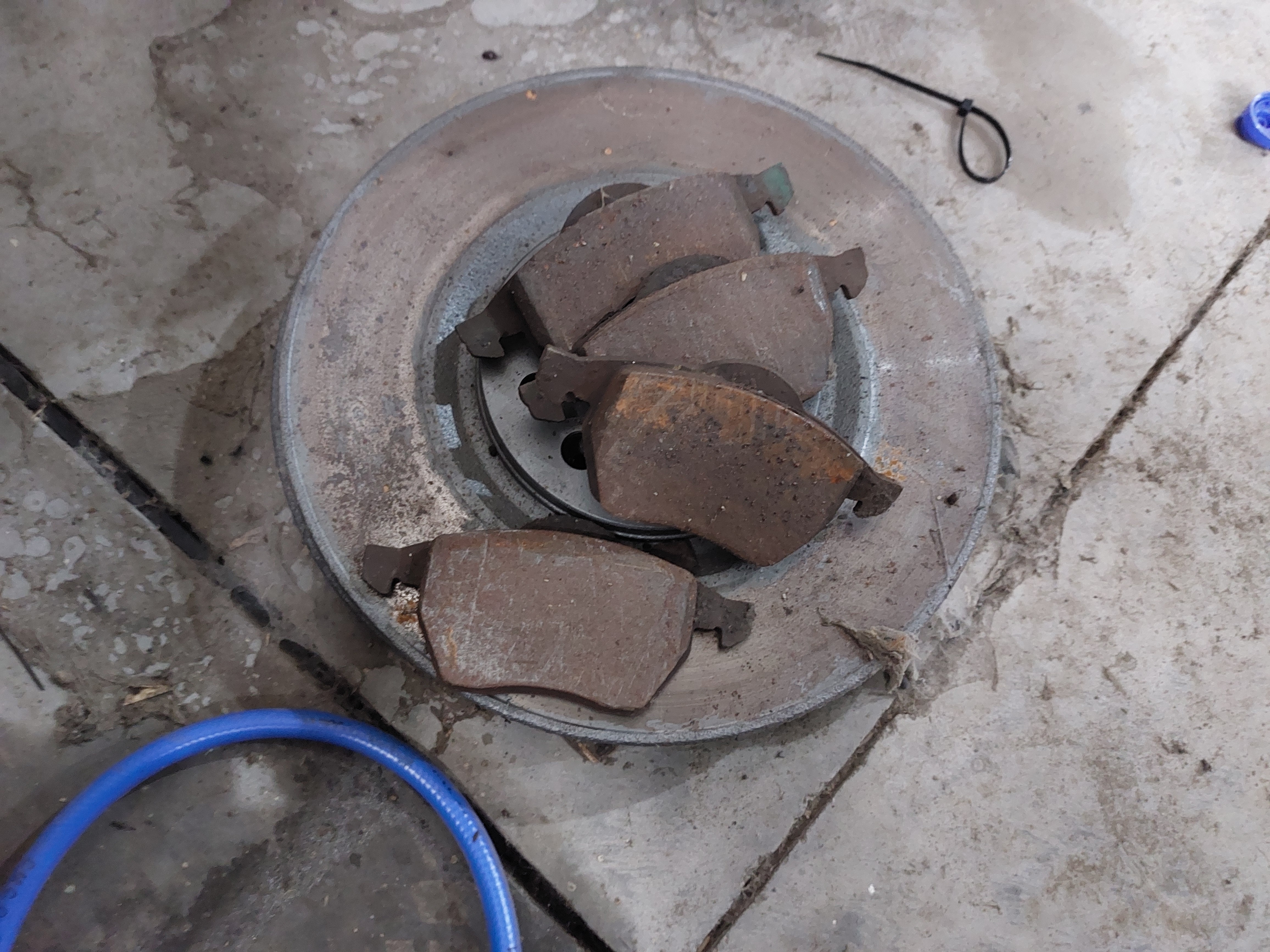

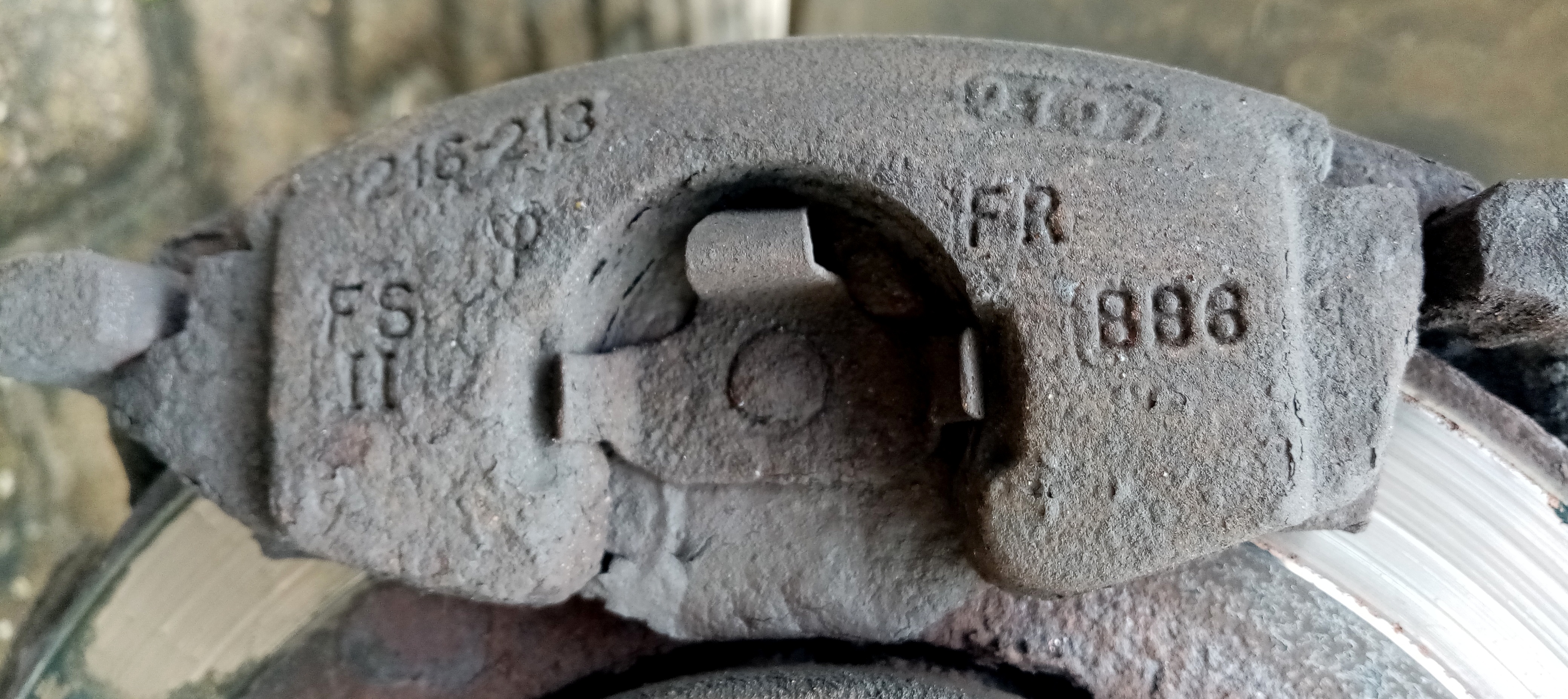

Any idea what front pads I'll need for calipers like this or have I got to take the wheel off again and measure the disc? Websites aren't clear with the stock photos they use 😒
07 plate 1.2 12 valve
I'm thinking ATE type
  • Sponsor
Looks like an FSII caliper which goes with 239mm discs, and pads which are different shapes inner vs outer.
If you have a pic of the other side of those pads it might be easier to be sure, but the backplates do look different.
