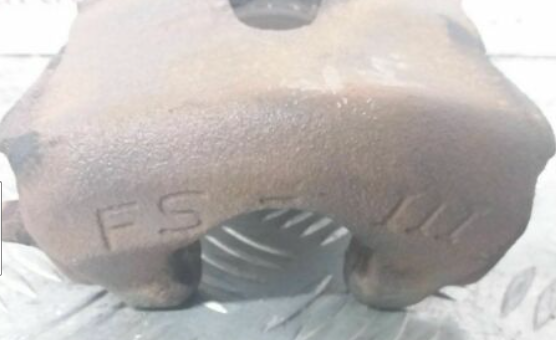

Looks like an FSII caliper which goes with 239mm discs, and pads which are different shapes inner vs outer.
If you have a pic of the other side of those pads it might be easier to be sure, but the backplates do look different.
According to Jurid on autodoc, the Fabia MK1 1.2 petrol 64HP (ie. AZQ/BME) uses 256mm front discs.

If @LesCM19would like certainty (though the caliper already provides that, FSIIIs correlate with 256mm discs), he could message me his VIN.
  • Sponsor
FSIII calipers of the time tended to be a bit more 'loud and proud' at self identification in my experience.
My partner has a mk1 1.2 12V with 239mm discs, as does @AnnoyingPentium's I think?

That's ok, but the FSIII also uses 256mm or 280mm discs depending on application.
  • Sponsor
Only 256mm in Fabia, Ken, which is what this thread is about.
No 280mm disc FSIII options in mk1 or mk2 Fabia AFAIK.
I think I've told you this before.

The photo of the fs3 caliper was not one that is on a car with 239mm discs.
Please stop messing the thread up with irrelevance.

@LesCM19  Your front brake PR code is 1LB.
FS2 calipers, 239mm discs, pad part number for genuine is 6N0 698 151C.
Info from partslink24, filtered by your VIN.

Either can have either mate, I believe, that's why it's tricky.
Our car is AZQ engine, pentium's and les's are BME
