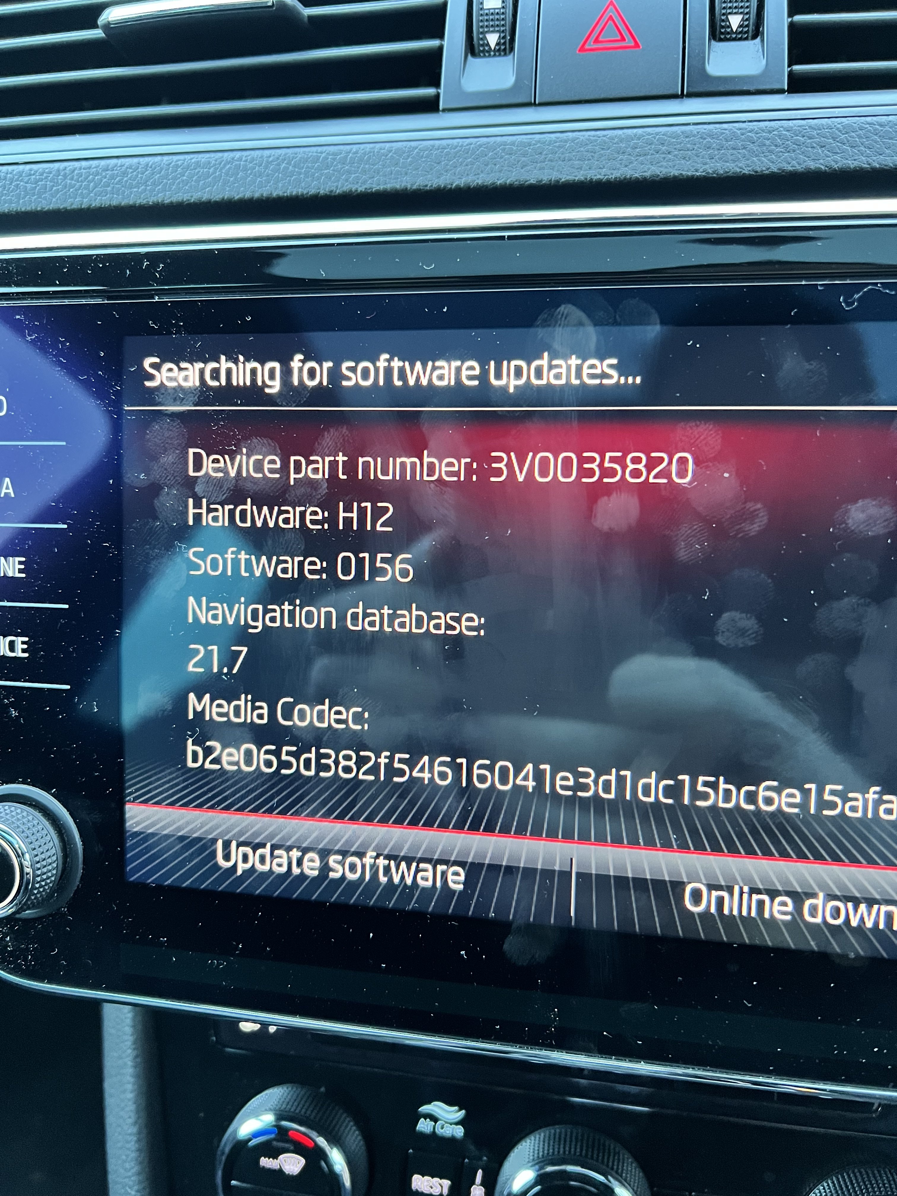

Update my car from 0156 to 0306

Hey, @JR RS thank you. But i have a very old Version MOI3_EU_SKMQB_P1560P firmware - MIB-Helper.com  and want to Update to MOI3_EU_SKMQB_P32400P firmware - MIB-Helper.com . But the Problem is i have upgrade Step by Step and not from the oldest to the newest because the SW Train is not supportet. And i can not find any Download link for the Versions between. right ? That was my Question.. hopefully @varooom or @Lennart can help me ?
 MOI3_EU_SKMQB_P1560P (MU: 0156, details)
 MOI3_EU_SKMQB_P27600P (MU: 0276, details)
 MOI3_EU_SKMQB_P27800P (MU: 0278, details)
 MOI3_EU_SKMQB_P30603P (MU: 0306, details)
 MOI3_EU_SKMQB_P30800P (MU: 0308, details)
 MOI3_EU_SKMQB_P32400P (MU: 0324, details)
Have you searched through https://www.drive2.ru?
I'm pretty sure almost everything will be there 😅

Hi Everyone,
I'm Alfred from the Netherlands and driving my Superb iV Combi 2020 with an Columbus MIB3 with much pleasure.
I have exact the same situation as Lenard and want tot update from 0156 to 0324. The only software I can find is the 0308 and 0324 version from MIB-Helper.com.
But I still need the 0238, 0268, 0278 and 0306 version software.
Does anybody know where to get these versions?
Thanks a lot!
