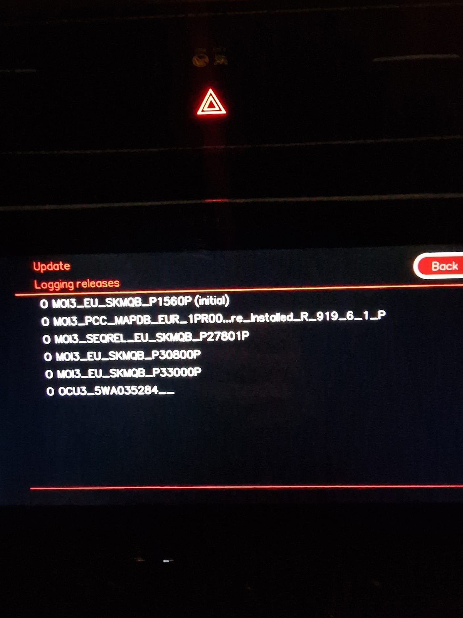

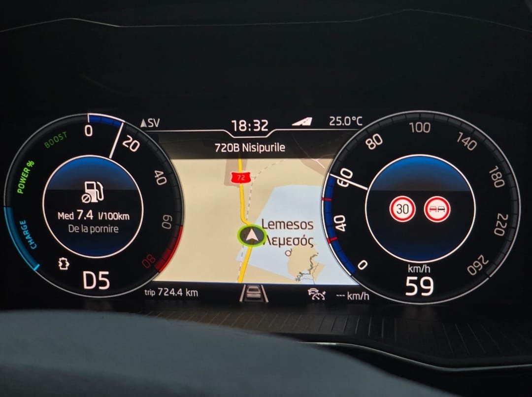

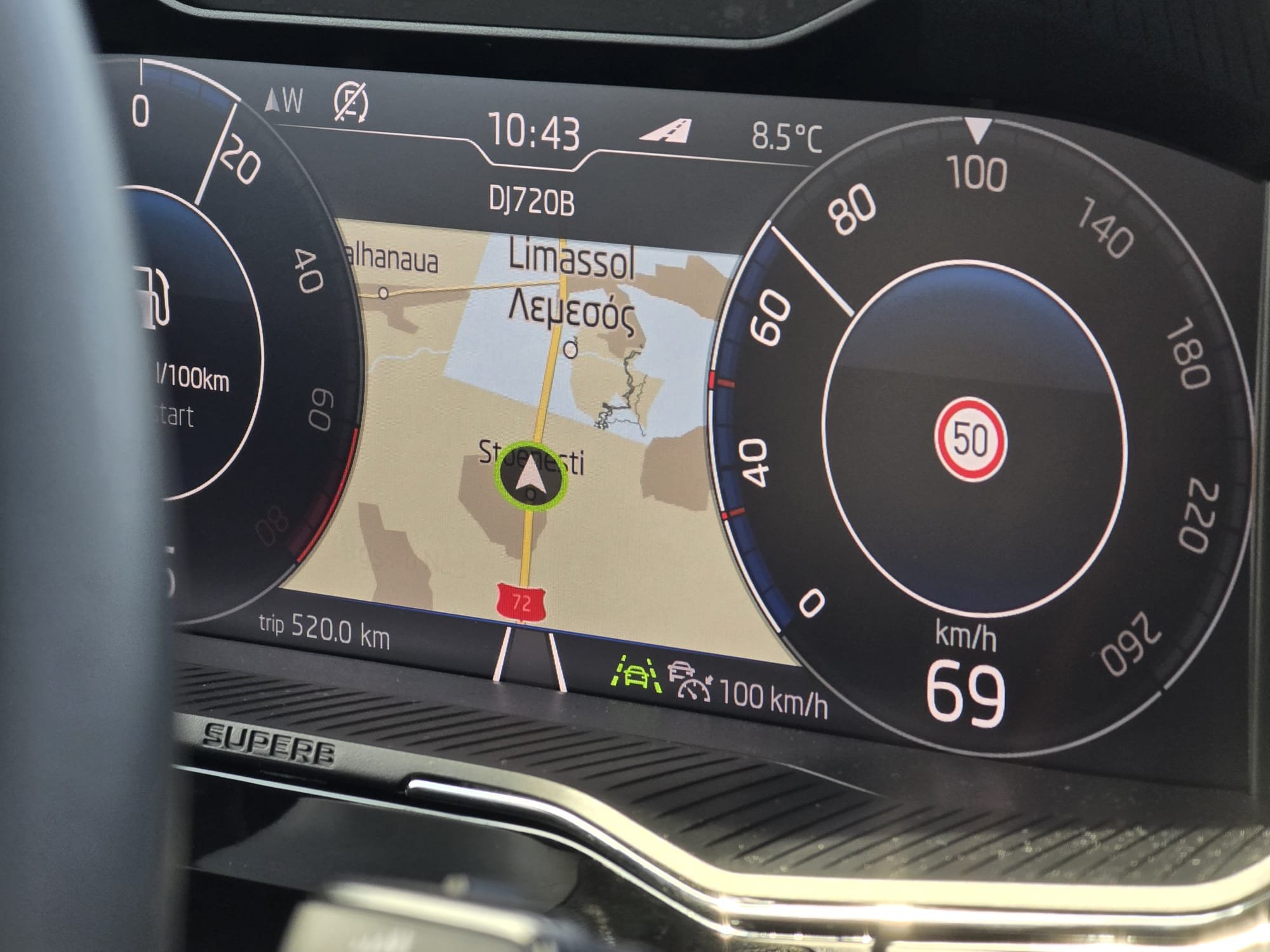

I bought a Superb 3 iV MY2020 last year and I got it with SW 0330 already installed. Everything is working good, except for some issues with the maps:
1. Maps are stuck on 23.6 - can't get them updated neither with Infotainment Online Subscription nor with Offline Update via USB Stick
2. Some maps are completely missing for couple Eastern Europe countries ( ex. Hungary, Serbia )
3. Various cities from Cyprus appear when driving in Romanian countryside areas  ( please see second and third photo )
My question is: can I do anything at this point to solve this issue or my MIB3 unit is bricked?
Please see the first photo with the update history.

On 13/01/2025 at 22:46, AlexNec said:
Hi folks,
Missed this - so you’re downloading the maps onto a USB but they’re not uploading to the car? It’s a lot of data so people do reports a few hours-worth of driving around for the maps to update.
How long have you given it?
