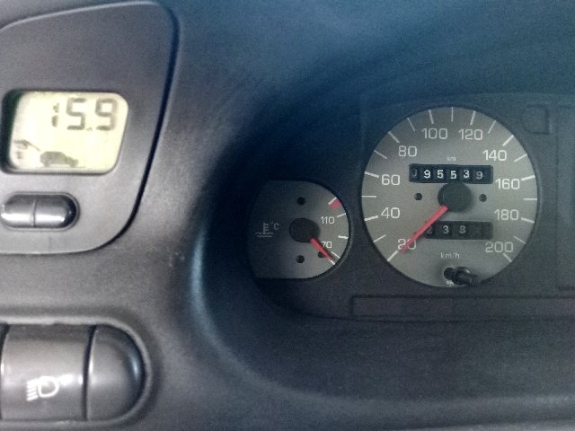

95539 Km (238,3 in the Trip meter) so 238 Km distance which i could push things a bit more in Mountain Roads till 4100 rpm
the Total consumption is 15,9 litres which is 6,69 ltr/ 100 Km Average
and the Ø indication in the TC-6 agrees.

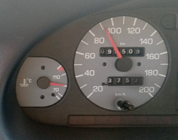

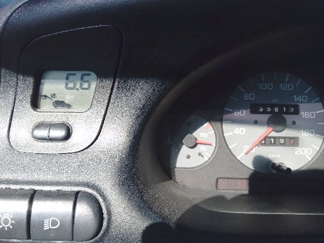

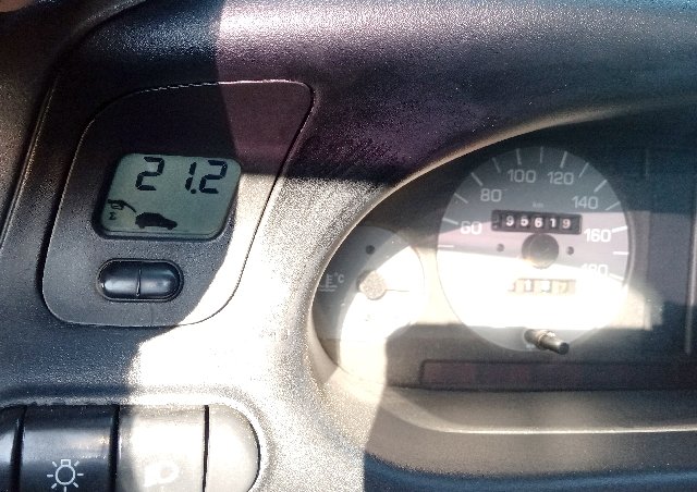

Next stop was 95619 Km (318,7 in the Trip meter) so 318 Km distance
the Total consumption was 21,2 litres which is 6,66 ltr/ 100 Km Average, both very good results !
As you can see i had problem taking photos,the sun's angle didn't help at all-was a hot day and i had not enough patience.

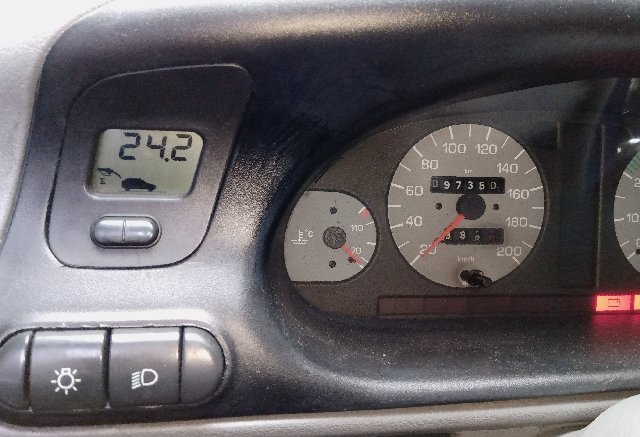

Arrived inside the centre of the town and
i had 97350 Km so the distance was 163 Km (with 2 persons and one click heavier luggages in Mountain roads, National highway and some heavy traffic till i reach my house), the Total consumption was 24,2 ltr so i consumed 10,3 ltr of fuel so the Average was 6,31 ltr/ 100 Km (44.767 British MPG) a very good result.
I forgot to take an Average Ø photo because i was tired and suffered a lot to find a parking space.
I made 30 kilometres in City traffic, refuel to the top, zeroed everything and now it's time for a Spring season test all in City.
