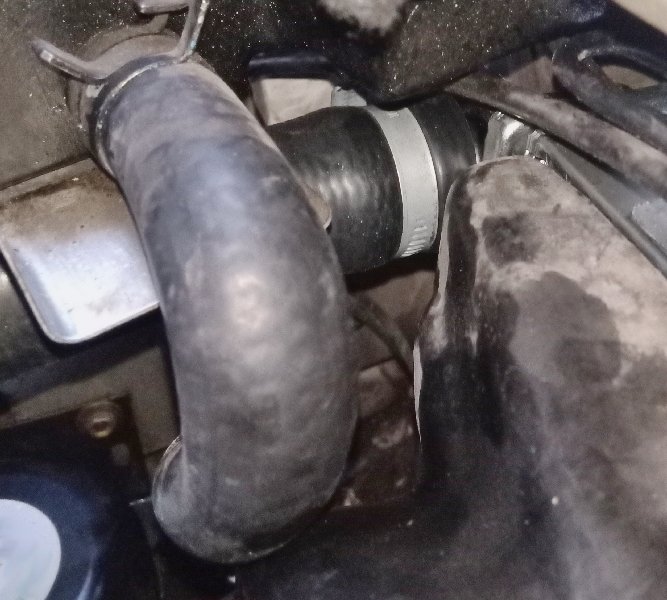

  • It was very unfortunate to encounter a problem like this after all the work done. But, when tightening the clamps around the radiator hoses, I've always thought that something like this could hap
  • D.FYLAKTOS
    D.FYLAKTOS
    I had a spare hose in my self plus new clamps The part code for the hose is 6U0121101   Is already installed with new clamps plus new coolant, the air removed procedure is done pl
  • Breezy_Pete
    Breezy_Pete
    Make a prominent mark on the radiator plastic that will allow regular inspection for any axial movement. I think friction will be your friend here and it won't move unless something dramatic happens l

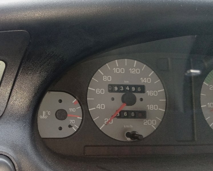

A made a quick test at Saturday, everything is fine but today i will take some photos from the instrument cluster gauge to see the position of the needle (same route-same hour) if it's one click lower and pay attention to hear when the radiator fan will start spinning for first time.
On such an old design and build of engine and cooling system, even the mighty Germans and VW, I think you worry too much about the dictates of VW and their confused and altered coolant regime. Yes it's best to stick with same make and model and formula of coolant as much as possible but as long as they mix and tolerate each other and are both suitable for your use things should be fine.
Normally I would think the needle on the gauge might no tell you much but you have such previous testing and information if anyone can notice a difference from such it will be you. When the fan operates might be more of a (rough) indicator, the later the better.

Here is as it looked after the installation.
I will check the screws on the clamp in the end and back in the thermostat after few days (contraction-dilation circles).

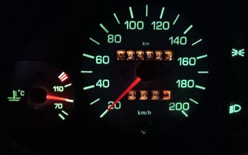

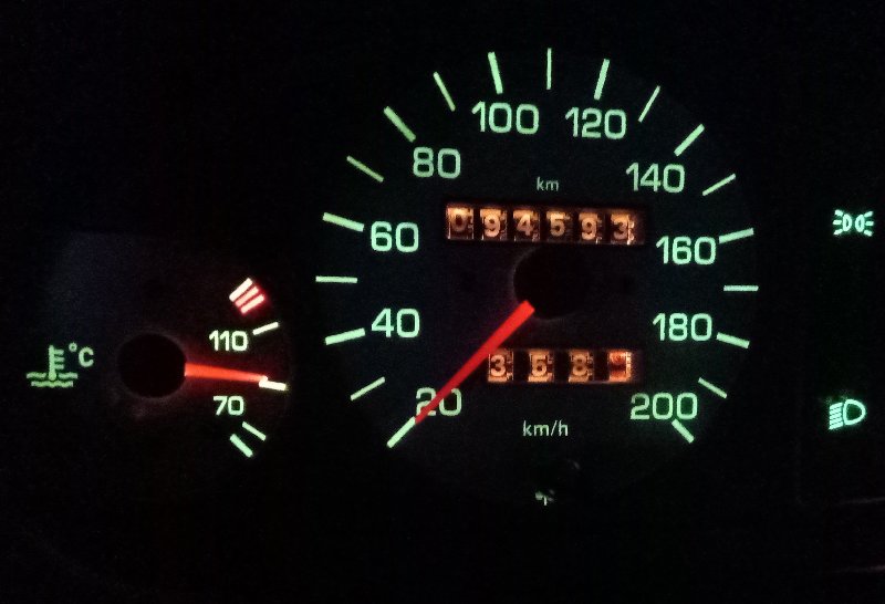

I also took some pictures from the cluster gauge to make a comparison with the previous situation but for sure now with the new radiator things are better.

With the factory radiator

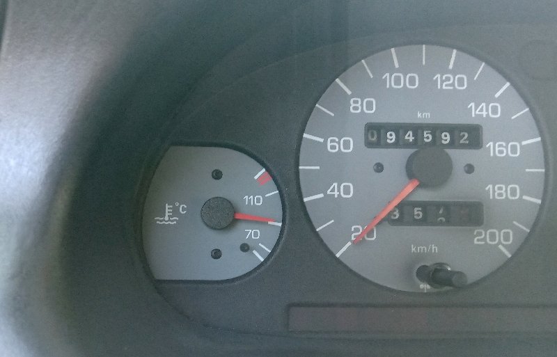

and with the new Aftermarket.
The new is tested for few days an only in City driving.
Allowing for camera angles and other possible variation I would say needle is the same which makes sense.

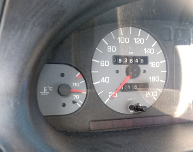

Here are some other photos, arrived at work with outside temperature 26 'C, parked and waited till the radiator fan stops, took a photo (the indication is one tiny click lower that the previous situation).
In purpose i let the car idling for more till the radiator fan start spinning again, i let it for more time (no incoming air to the radiator) to push it to see the maximum that the needle will reach
and stayed there, that was the end of the test.
