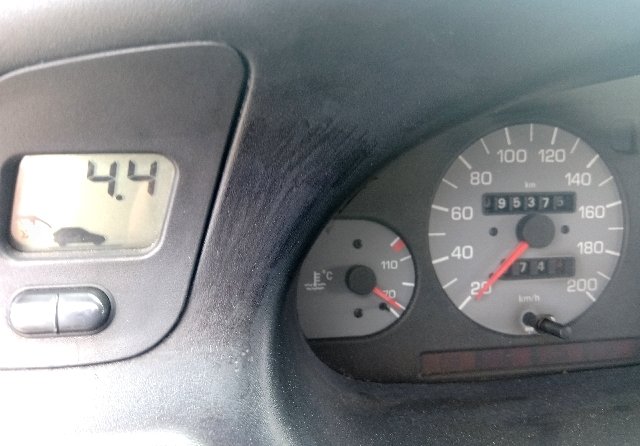

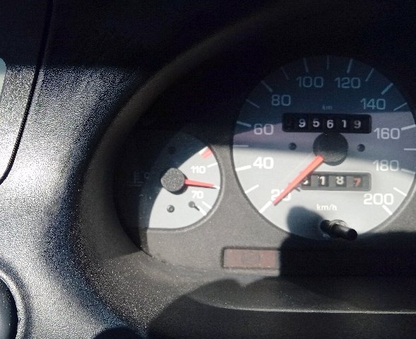

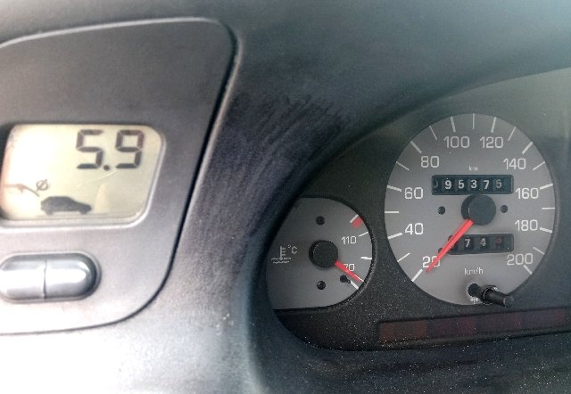

Since this system is my ''nightmare'' i pay attention every day to the temperature gauge in dashboard plus very often i check the connections, signs of coolant leak etc.
Thursday noon while i was on the road to work i noticed that the needle raised at 100 'C and first signs of ''smoke'' came out from the grille, my first reactions was a ''Not AGAIN", turn the alarm on, moved to the right and when i cam out i saw this:
I was extremely angry not because i would be late at work plus i couldn't imagine the cause of this since i had changed the coolant recently-check the hoses, the clamps, i had a new expansion tank plus new cap etc.

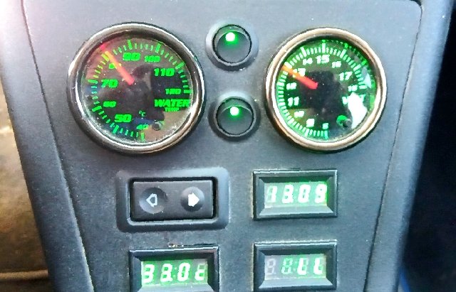

Here is a yesterday's photo, the engine bay was cleaned this afternoon and i checked for leaks, none was found.

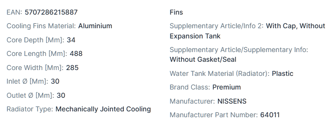

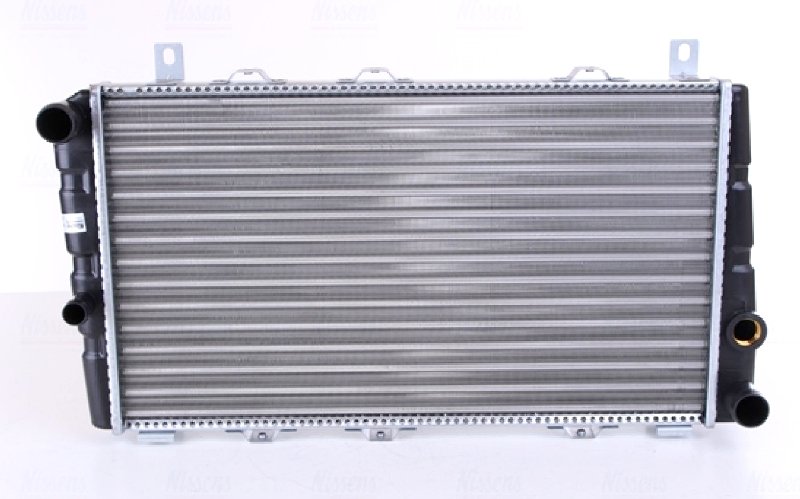

For sure i didn't wanted VIKA, other brands as Mahle-Valeo-AVA were not available for the same day, I will install the NISSEN 64011 ,part code 6U0121251.
For antifreeze the same HEPU G12, i will post later the whole cost and relative matters.

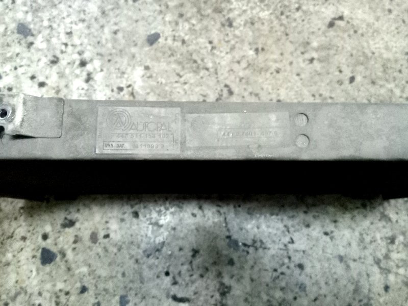

Here is the original radiator AUTOPAL, old and dusty when removed.

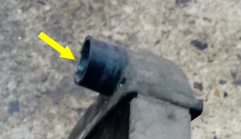

Before 2 years at least the half socked broke

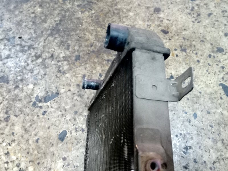

plus one piece more
so the water hose had no bulge for support and was easy someday to slip outside.
