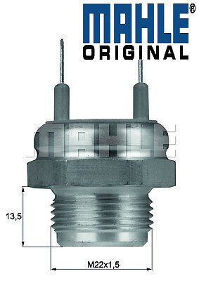

Mahle with 2, here is an example:
https://i.ebayimg.com/images/g/NPMAAOSwl7Fm6yfy/s-l400.jpg
i never had 3 prone in my Felicia, never saw one in the market.

So you have the ALEX AC with the cut 1st speed, great, ideal candidate for my circuitry.
The ALEX AC system has 2 speeds
Speed 1 is controlled by AC
Speed 2 is controlled by AC (high refrigerant pressure) and the thermoswitch

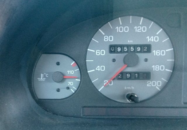

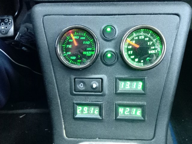

An unofficial comparison of what the cluster gauge shows and what the aftermarket in the console (it's sensor is after the expansion tank's hose to the radiator).
and
The photos are taken immediately when i stopped the car.
As you can see they don't match.

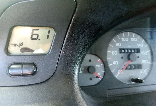

The next measurement is after a Mountain Route (lot of curbs in an uphill and then downhill) till final destination at noon.

EXACTLY AS I'VE SAID.
90C is way higher than the midline on the gauge as reported by ECT sensor

The car is off, below the digital meter says 13,13 volt.
I can not rely 100% on the factory cluster gauge but on the other hand the aftermarket on the central console isn't something expensive as a GReddy or AEM.

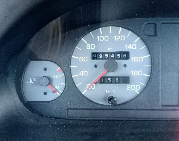

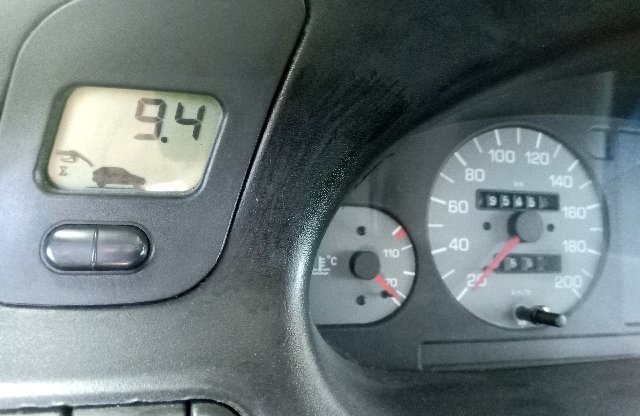

95456 Km (155,3 in the Trip meter) so the distance was 81 Km in Mountain Roads.
Keep in mind that the car had: 2 persons, 2 valises, 3 sport bags and a 3/4 full tank in a hot sumemr day.
The Total consumption is 9,4 litres which is Average 6,06 ltr/Km or 46.61 British MPG (Excellent result) 🤩
The Ø indication in the TC-6 agrees.
