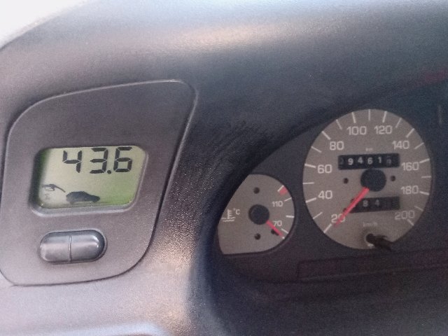

I use the TC-6 and the Total indication (with the Greek letter Σ) to compare the fuel consumption.
94592 Km and i had 40,5 litres
94619 Km and i had 43,6 litres
This was in City Traffic only, It's not the distance for which you can draw correct conclusions, it was 11.48 ltr/Km or 24.61 British MPG (not bad)

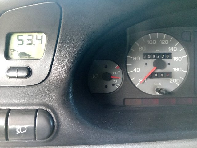

After a while i had to make a trip (National Highway and Mountain Route but not in high rpm)
94778 Km and i had 53,4 litres ,that’s 6.16 ltr/Km or 45.86 British MPG (very good)

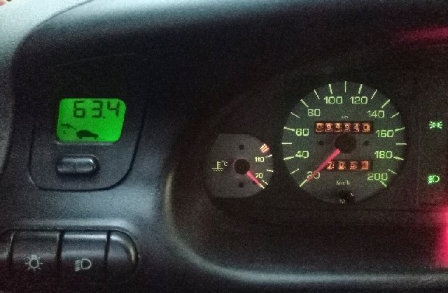

While returning from the trip:
94940 Km and i had 63,4 litres ,that’s 6.13 ltr/Km or 46.08 British MPG (very good)

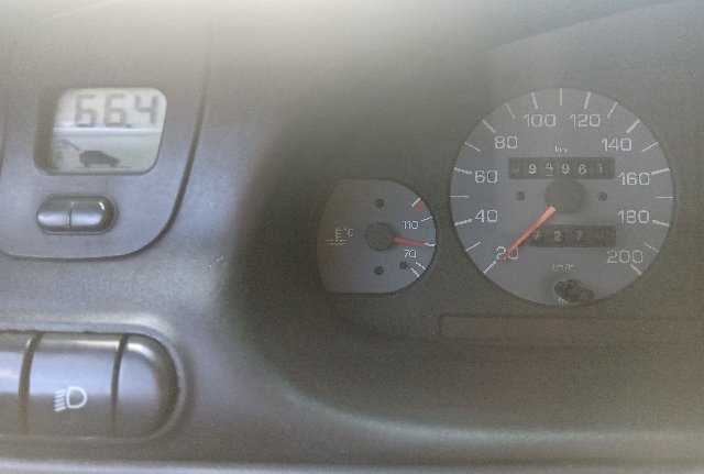

Then the City Traffic started and unfortunately the fuel consumption start rising.
94948 Km and i had 64,4 litres
94957 Km and i had 65,5 litres
94961 Km and i had 66,4 litres
94972 Km and i had 67,2 litres, that's 11,87 ltr/Km or 23.80 British MPG (not so good).

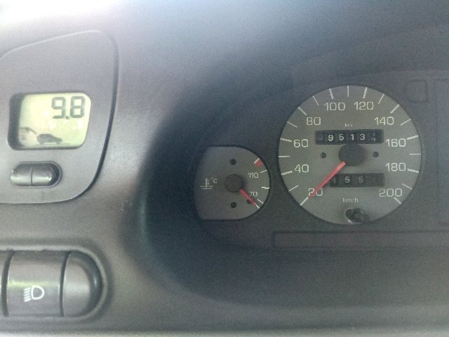

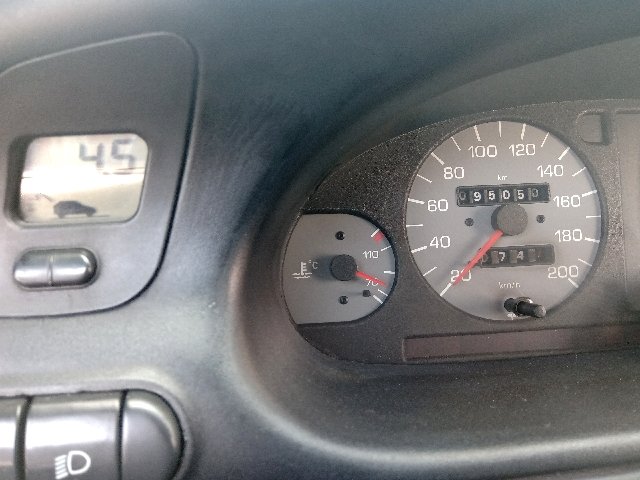

I had 94972 Km and i had 67,2 litres then 94976 Km and i had 67,6 litres (that's only 4 km distance so i don't count this), refuel to the top and zeroing the TC-6 because the trip begins.
2 adults, gas tank full and some luggages in the trunk, Highway (100-110 km speed) and Mountain Roads.
95050 Km and i had 4,5 litres (Total fuel consumption) which means 75 km distance so fuel consumption % was 6,08 ltr/km or 46.46 British MPG (excellent).
Few luggages added and some light traffic, Highway (110-120 km speed) and Mountain Roads, 95133 Km and i had 9,8 litres (Total fuel consumption) which means 83 km distance so fuel consumption % was
6,38 or 44.28 British MPG (very good).

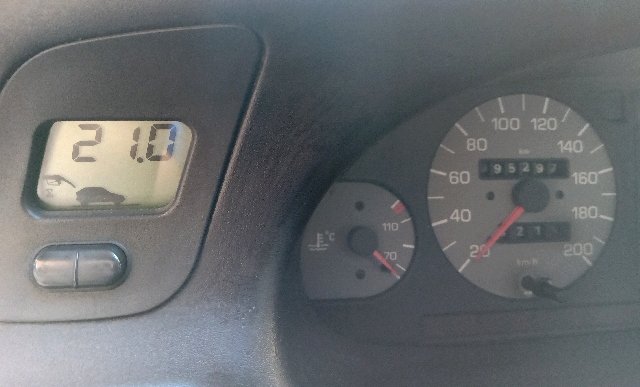

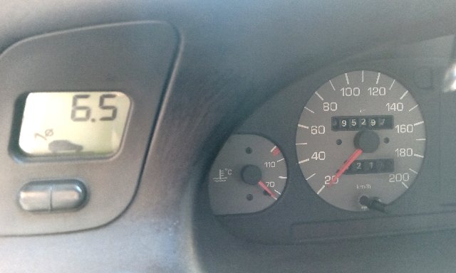

95297 Km and i had 21 litres which means from the 94976 Km i have travelled 321 Km distance (according to the Trip meter is 321,1) the Total fuel consumption was 6,54 ltr/km or 43.19 British MPG.
The % function of the TC-6 agrees with this number, shows 6.5 % litres.
The last 16 kilometres were in traffic under hot sun (keep in mind in car were 2 persons with luggages) and this ruined a bit the Fuel Consumption but i had no time to take a picture right before the traffic started because my wife was grouching "this is dangerous, don't let the steering wheel" etc. 😆
