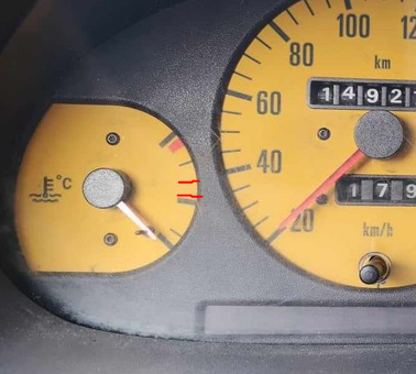

The first line is where the thermostat fully opens
The second line is where the fan will kick on
And on the middle grey line is where theoretically the second speed would initiate.
So yes, I got over the worry about Felicia's temp.
I let it heat up and let my new rad do its job.
I only worry above the middle grey line, which I haven't gotten to till this day. Soooooo.....

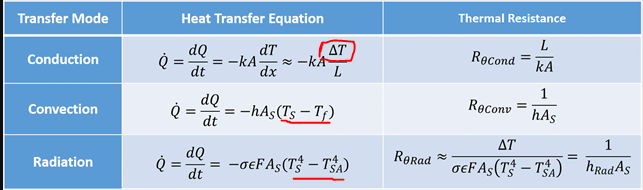

Back to shcool,i left the desk in the middle of the 80's but now we have Google search.
In coolant systems, ΔT (delta T) represents the temperature difference between two points, typically the inlet and outlet temperatures of the coolant. It's a crucial measurement for assessing the efficiency of heat transfer within the cooling system.
Temperature Difference:
ΔT is calculated by subtracting the lower temperature from the higher temperature.
Cooling System Efficiency:
In a car's cooling system, a larger ΔT might indicate that the radiator is effectively removing heat from the engine coolant. Conversely, a smaller ΔT could suggest a problem with the radiator or other components, preventing proper heat dissipation.
Monitoring and Diagnostics:
ΔT is a key indicator used in diagnostics to identify issues like a faulty thermostat, a clogged radiator, or other cooling system problems.
What about ΔΤ between the rad and ambient air

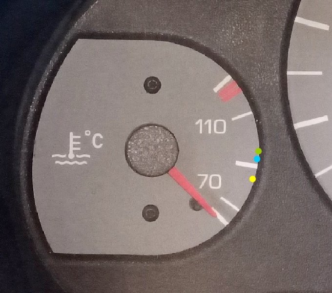

The gause on the cluster was showing false indications due to detritus on the lower part of the coolant sensor, i also have posted a depiction of this somewhere in the forum.
I found it by personal search.
City Traffic: The temperature rises, the thermostat open for 1st time and the needle drops to the Yellow dot.
The driving continues, the needle rising, stays for long time in the white factory line and in Summer after some time reaches the Blue dot and the fan start spinning for a while.
The meddle drops and if i stay in traffic for long time then again the above.
From a recent trip, Highway at noon.
The latest months only one (1) time i saw the needle to reach the Green dot, was in a Mountain Route in the top of the uphill with thinner air but after a while dropped.
Was 2023 (old radiator and G11) when after a trip involved in a hard City Traffic and in a red light i saw the needle reaching that green dot but after the radiator fan stopped return to normal.
I have seen the needle in the 100 'C but that was 5 years ago with lot of problems back then, since that time never again.
Edited by D.FYLAKTOS
