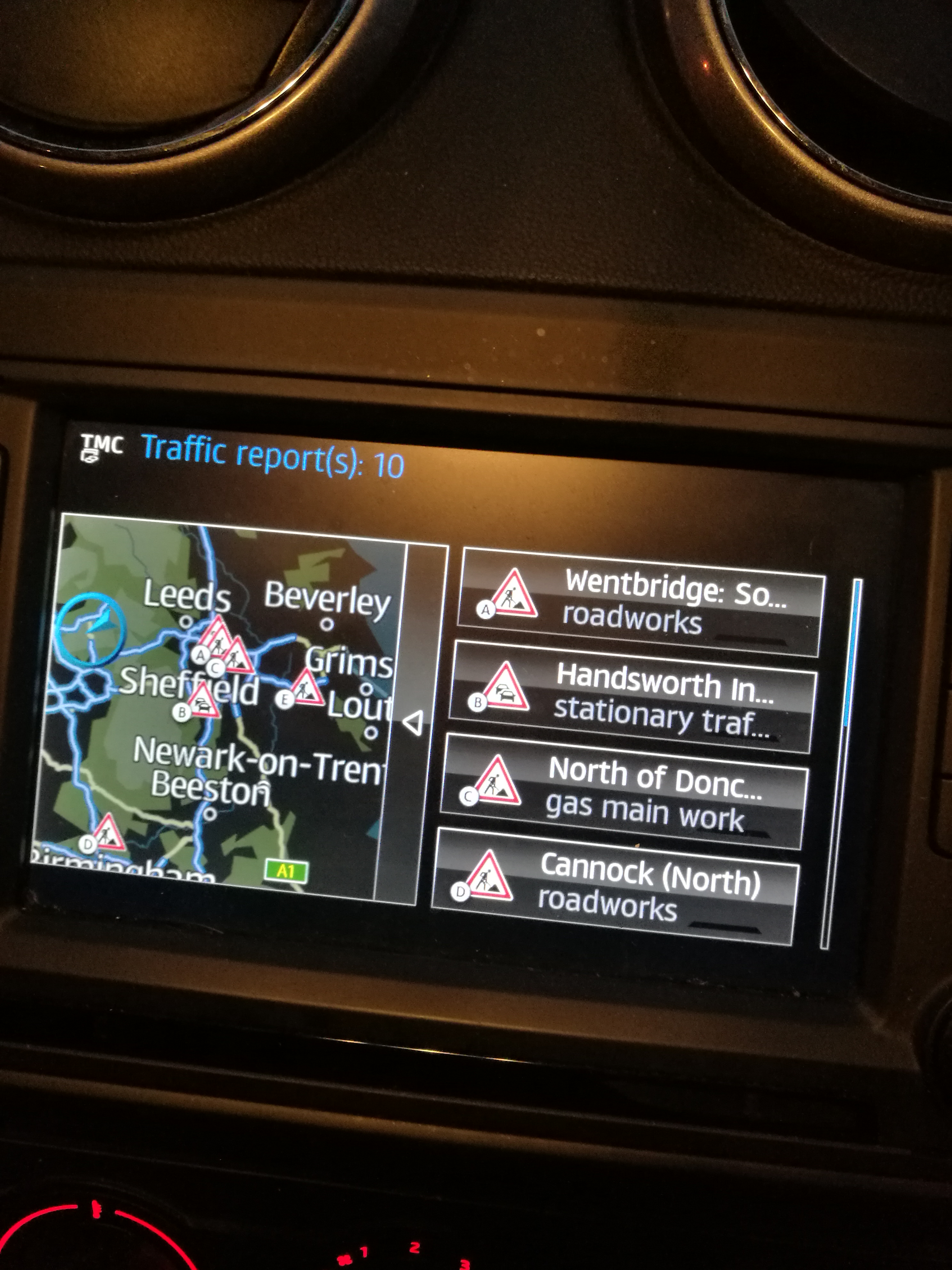

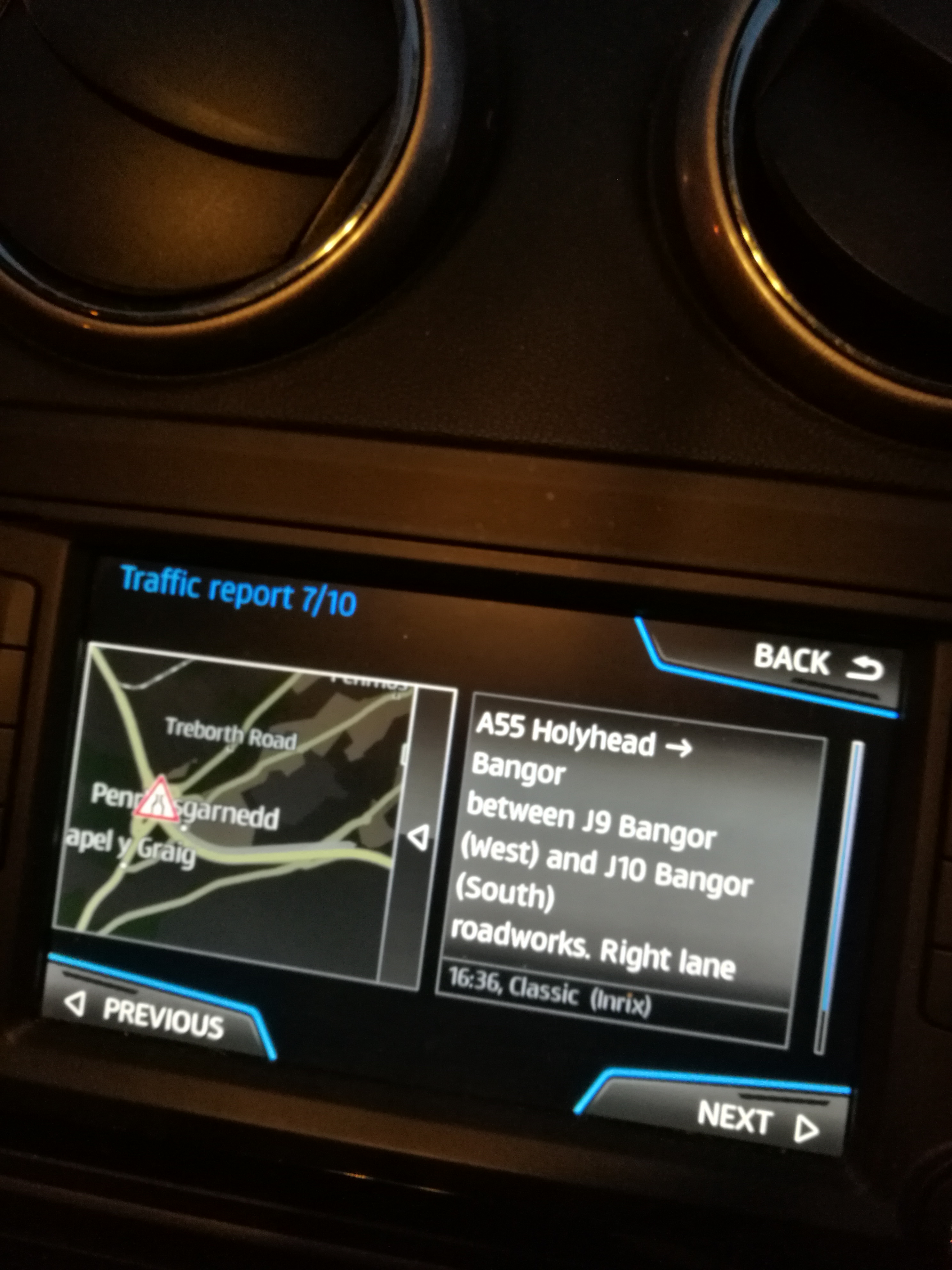

    I’m just letting any VW owners that may be lurking here know that I successfully reactivated the TMC on my mib 2 high using 32782 in the 5F module using OBD11 pro.
  • if YOU had contracted the third party, then yes, BUT it was Audi who contracted a third party to provide the service to YOU. Therefore it IS to do with them.
  • I think the vehicle age thing is a red herring. The dealer is spoke to checked his (newer) Golf which had the same problem.  He had checked their “hub” for any information and nothing was forthcoming
I see I already sent you a reply🤔... saying similar in July. Feels like you are nearly there.
Back up and running...
Massive thanks to @Tellfor all your help.
Yes it was rookie error of copying @Pcbbc version 2 mod unzipped into the route directory of the card rather than a copy and replace within the file structure of the maps directory. Thus it was only seeing the original files not those which were deposited to one side.
Being a Seat you had to do the workaround of moving forward the overall.nds file. That had been done why the V14 maps were working but not the mod.
Then it instantly worked once the mod files went in the right place by an overwrite copy. Nothing special about mib2 standards Seats other than the overall.nds workaround copy if the updated maps are newer than the original. In this case they were.

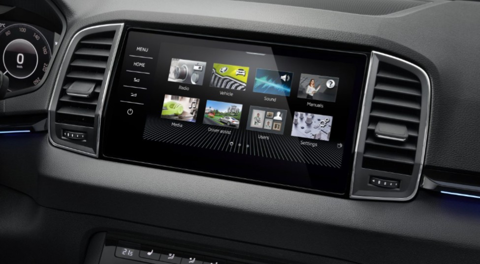

Hi Tell,
I have USB-A with the touch screen, no physical buttons, it looks like the attached image.
I can update the Nav over an SD card but the Nav data is stored in the unit and not held on a SD card. So is that MIB2 high?
Does this unit have RDS-TMC capability?
As I mentioned before, the coding in the Karoq is currently 32771. In my Audi the coding was 32783 changed to 32782. So I'm a little confused 🤔.
Thanks.
41 minutes ago, El Dingo said:
Hi Tell,
Thanks.
It's a mib2 high.
The coding should be set to 32782
Your current coding indexes groups of TMC providers. Online + VW TMCPro. Change to 32782 it brings in Inrix plus the kitchen sink... a group of others. I've closed down the laptop so can't paste them in.

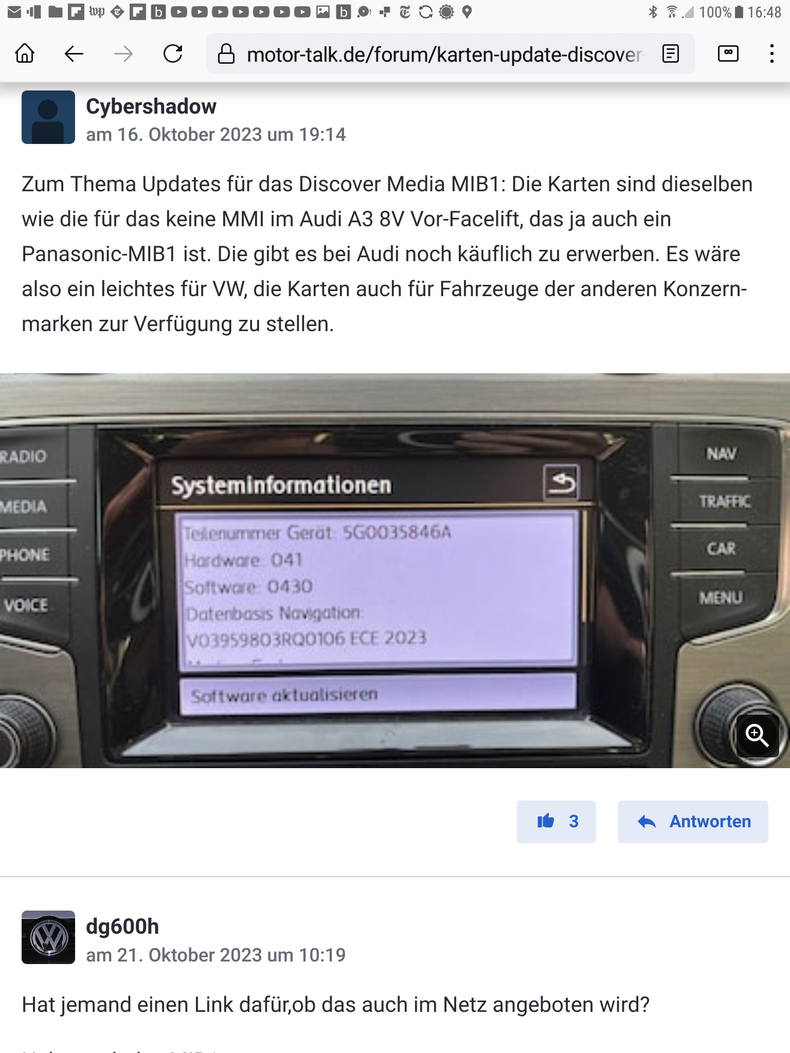

I'm new for the topic. Is it possible to modify MIB1 SD cards, to get traffic updates from a different provider not TMC? I have Discover Media 1 with 14" screen,
TMC does NOT stand for TrafficMaster.  TMC (Traffic Message Channel) is the method used to deliver traffic updates over RDS, regardless of the service provider (TrafficMaster, INRIX, etc).
No idea about MIB1 maps, sorry.
We were very lucky with the MIB2 platforms that the map data already included both providers (although it was removed from the MIB2 Standard maps when they switched over to TomTom). Some other VAG navigation platforms (RNSE for example) were not so lucky.
Ah possible. On the thread it was said mib1 here but I wasn't totally clear whether mib1 standard or mib1 high. Back on the Seat side a new Audi map for mib1 has dropped as the youngsters say so I got them to test out the 14 TMC group whilst they were updating to 2023 maps. Yes with VCDS / OBDELEVEN that standard coding group fix works.. . as muttered on the thread.
Link here since I reckon some nifty map update can be made to breath new life into old mib1 maps as well as Inrix on these unit, mib1 map update here:
https://www.seatcupra.net/forums/threads/updating-the-inbuilt-mib2-satnav-mib2-tricks-and-mib1.388586/page-138#post-5050968
Confirmation that recoding 15 to 14 works here for Inrix on mib1:
https://www.seatcupra.net/forums/threads/updating-the-inbuilt-mib2-satnav-mib2-tricks-and-mib1.388586/page-139#post-5051436
I pass on the Skoda map update procedure for mib1 but you can put the newer contents on a 16gb mib2 card... we had established that on the thread. Seat Mapcare for mib1 procedure is covered... Skoda I pass on but you can either way recode the TMC group from 15 to 14.
That's another Audi map that is interchangeable... we like that.
re reading I'd try the simple code change 15 to 14 first with a reboot.
The update does indeed work on a Discovery Media from this... badically its @MartiniB list extended on but not made available by VW / Skoda or Seat.
