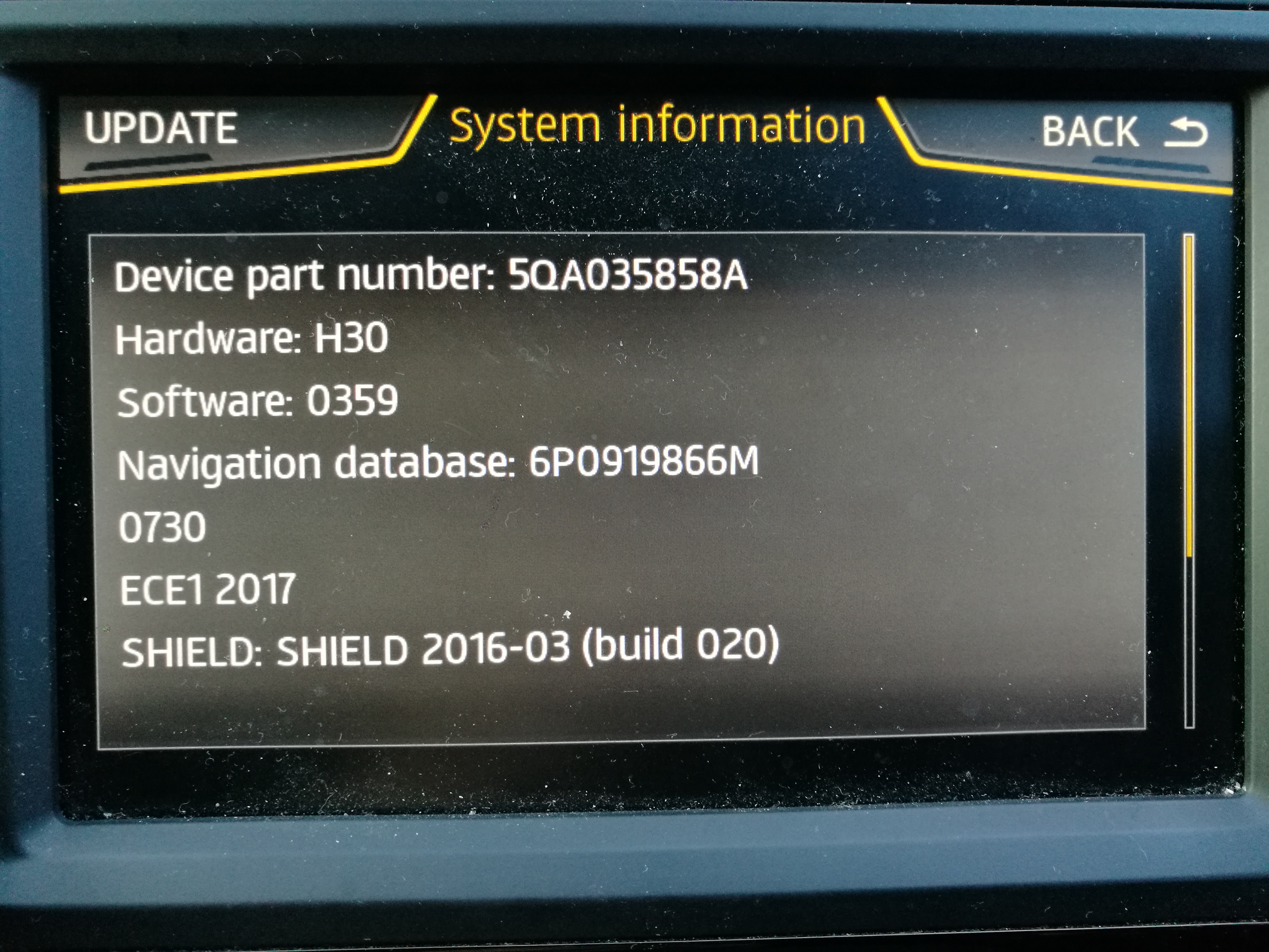

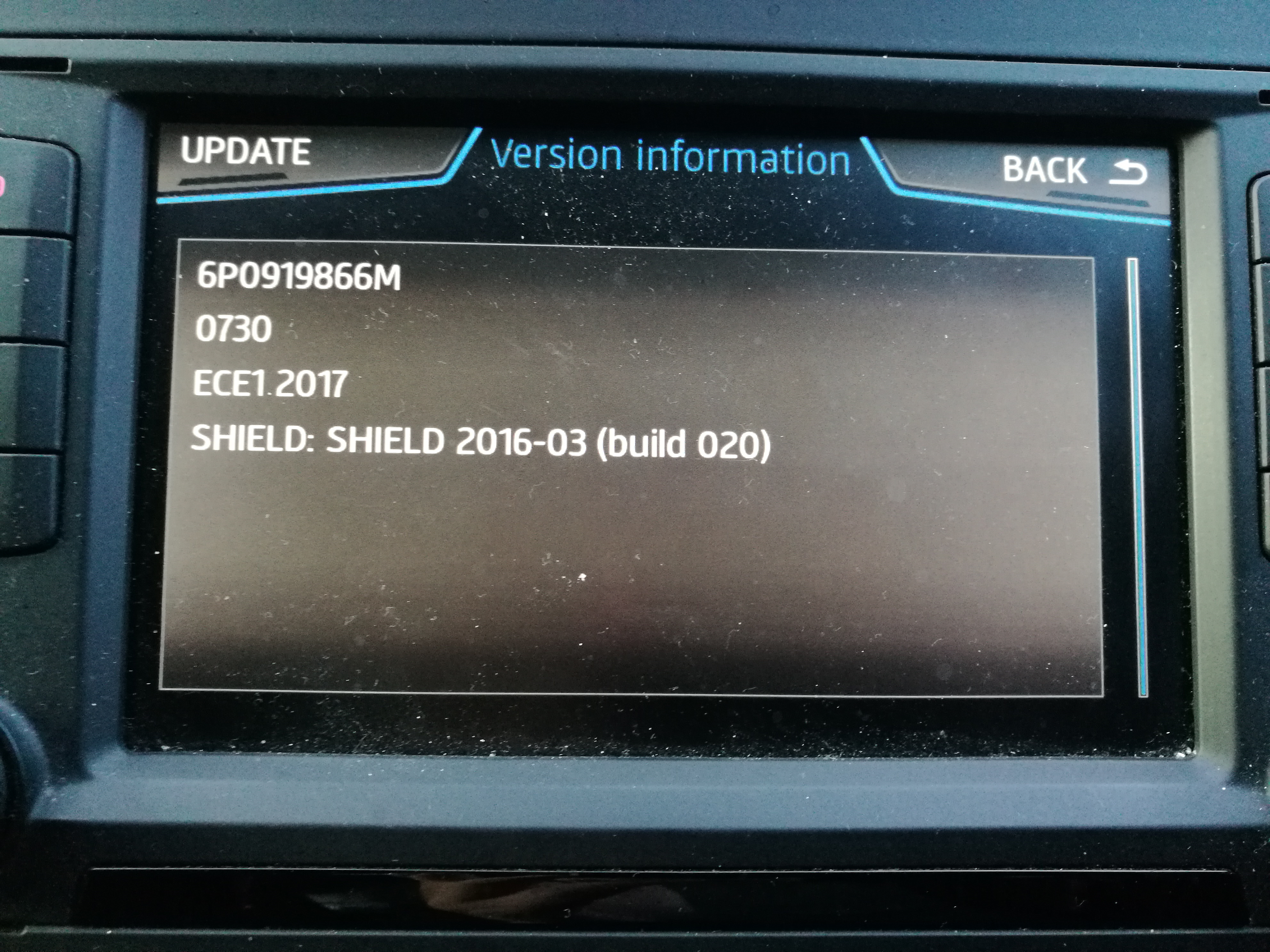

Hi, I've been following this thread since April shortly after TMC stopped working in the hope of a workaround.
I can see that some workarounds have been found but as I am not familiar with some of the technical stuff I thought I'd provide my info in the hope that I fit into one of the solutions!
I have 66 plate Seat Ibiza with maps v4 (basically the original)
I've read about codings and software etc & wondered if there is anything I can do with my particular SD card and if so how do I go about doing it (either myself or via a 3rd party).
I've uploaded a couple of photos of my system info in the hope that this helps!
Thank you in advance,
Ben.
Ben.
You can do it yourself as I covered on the SeatCupra thread:
https://www.seatcupra.net/forums/threads/updating-the-inbuilt-mib2-satnav-mib2-tricks-and-lost-mib1-card-solution.388586/page-136#post-5037297
Yours is a Mib2 standard but with mapcare.
You need to apply the Seat workaround as well as outlined since you are on V4 of the maps and V12 is an upgrade. Take a back up copy of the map before you start. If using a Mac use Cleanmydrive. Use the b. option produced by Pcbbc in that link no coding is required.
Basically back up card.
Download V12 maps.
Copy V12 maps to the card.
Apply the Seat workaround... this
The workaround for that is the standard one:
Steps:
  1. Download the latest standard MIB2 maps
  2. on the infotainment go to settings, safely remove, sd1 card
  3. remove sd1 card from glove box slot
  4. long press on the on / off to reboot it a couple of times
  5. insert sd card in to computer
  6. copy and paste all contents to a directory on your computer
  7. Format the SD card keep it as fat32 and leave format settings as default in file explorer (don't forget to push the card lock mechanism to off) (ditto in a MAC or delete all from the SD card)
  8. Copy the new downloaded map version to the SD card (after unzipping it)
  9. Replace /maps/EEC/EEC_WLD/OVERALL.NDS on the SD CARD with the one from the original SD card
  10. eject the sd card (on a MAC run CleanMyDrive on the SD card - then eject)
  11. Inserted the card into the card 1 slot in glove box whilst infotainment is off
  12. power on and go to navigation
Then apply b. of that link to the card.
Quite a few people have got it working on Seats now. The only wrinkle for Seat's is the "workaround" 1-12 above that isn't required on VWs and Skodas. Seat never got life long mapcare so that avoids it.
BTW other success ones are on this thread:
https://www.seatcupra.net/forums/threads/tmc-not-working.472987/
Mib2 High you do as published on Briskoda board no change, Mib2 standard (card based system, 6P descriptor as above in the picture means it's a Seat Mib2 standard, you use the published stuff here plus the workaround)... clear as mud. That's how I detected it's a Seat Mib2 standard and not Mib1 or a Mib2 High (Plus in Seat's terming of the unit).
