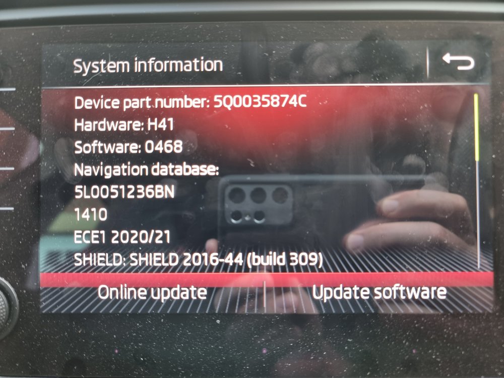

You need to check which infotainment unit you have installed as there are 2 different methods to make TMC work again. If you have the Columbus unit installed then the code change should be all that is needed and it should work. On the other hand, if you have the Amundsen unit installed ( which is what I suspect is your issue ) then any code change will be a complete waste of time. In order for the Amundsen unit to get TMC working again you will need to download the older version map and patch posted earlier in this thread and revert to your original 32771 code. I do stand corrected if my suspicion is wrong though.
I'd assumed we were on the right route from the start. If the maps are on an SD card on that year then it's a Amundsen (which is a mib2 standard) then it's the other route without coding using the Pcbbc posted fix of old maps with revised module (development of bigade1 method) in the posts above. If no SD card and you got maps on the system, that year then it's just coding. The Pcbbc method for the Columbus (which is a mib2 high) shown above as well that is just the coding method you have done, that splits into two, 14 code you use if your car didn't come with connect services and the head contained 15 as the TMC code or the revised 5 character code if it had the 5 character code (connect services). That latter solution fixes VWs mib2 high units which can have a different 5 character code starting point. Turned up on the thread. Older mib1 high units can be fixed with the 14 coding, that turned up on the thread as well.
A photo of the map release used in the system, firmware release code etc  also allows people familiar with the units to quickly resolve whether it's a mib2 standard or mib2 high or anything else. I did bring these together for Seatcupra forum in the link above in the posts. All the same solution except for the mib2 standard you have to deploy the "workaround" of copying the overall.nds file if "updating" mib2 standards maps. Seat didn't bless the cars with unlimited mapcare until the final year of mib2s in them... an additional wrinkle. Why I harp on about this in case Seat readers don't do that as well. There is a recovery file I posted up if you fall into that trap which Seat drivers continue to do, not reading the small print. The "workaround" works around not having unlimited mapcare on mib2 on Seats. Mib3 they have fallen inline now.
Other than that it's not toggling some basic parameter or having the station in memory.
Nb. There is one other mib2 standard unit which I think was never fitted to Seat or Skoda where the fix doesn't work. That's signposted above on the thread. You see someone ask for that fix in the text but no follow up.
Edited by Tell
That's my fault, stupidly misidentified which system I have based on how the screen and buttons looked. Apologies for wasting your time.
So I believe I have MIB2 standard, so V12 maps and patch on the SD card.
Thanks
Thanks
That's the one where Pcbbc gave two options. Get your coding back to how it was. You need to overwrite those modules.
If we had the photo earlier 😉. 1410 gives it away as a mib2 standard (Amundsen).

So you are one release I reckon before V12. Probably best to upgrade to that then you need option a. or b.

I have the same device part and hardware numbers as Tazdaz but a different software number.  Can I assume mine is MIB2std  Amundsen ?  I updated my maps in June so different software number is expected.
I also have copies of all the map files since the car was new (MY18) so I could try each update since then and see if the traffic info returns.
