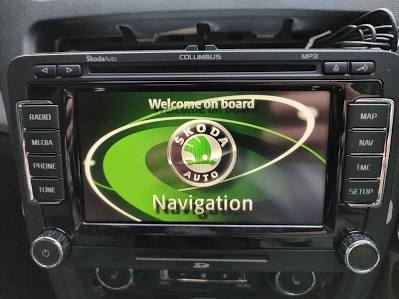

A 2012 superb will be a MK2 with the older RNS510/Columbus navigation unit.
The fix is for the newer nav units fitted to the MK3 Superb.

There is one post on the thread where it's said the coding solution works for a mib1. Suspect that was the Columbus mib1 since that post came in ahead of it being sorted out for the map card based units.
My trick I use when it's not clear what people have is to read the part number of the hardware off a picture of the screen then do an image Google. Sellers often show the label on the unit. Zooming in you get to read the label. A photo shown of the map code installed also quickly gives the game away.
Circa 2015 on to 2020 it will be mib2 standard / high (Amundsen / Columbus) before not mib2. So you might get that mib1 fix on a Columbus unit prior to 2015 or there abouts of that vintage (fee based code 14 rather than 15) if it's one of those.
Mib2 on VW and Audi might have  Delphi rather than Technisat. Looking at the mibsolution firmware library Delphi units didn't get installed in Skoda or Seat.
The check whether it's a Technisat (the one it works with) if it starts with MST2 and ends with T, MST2_EU_??_XX_XXXXT its a Technisat and the solution works. The test posted above. I determined they only appear on Audi and VW.
Edited by Tell
It doesn't help that Skoda used the same name for very different nav units through the generations.
A 2012 Superb will have the older MFD3, also known as the RNS510 or Columbus, which there isn't a fix for.
