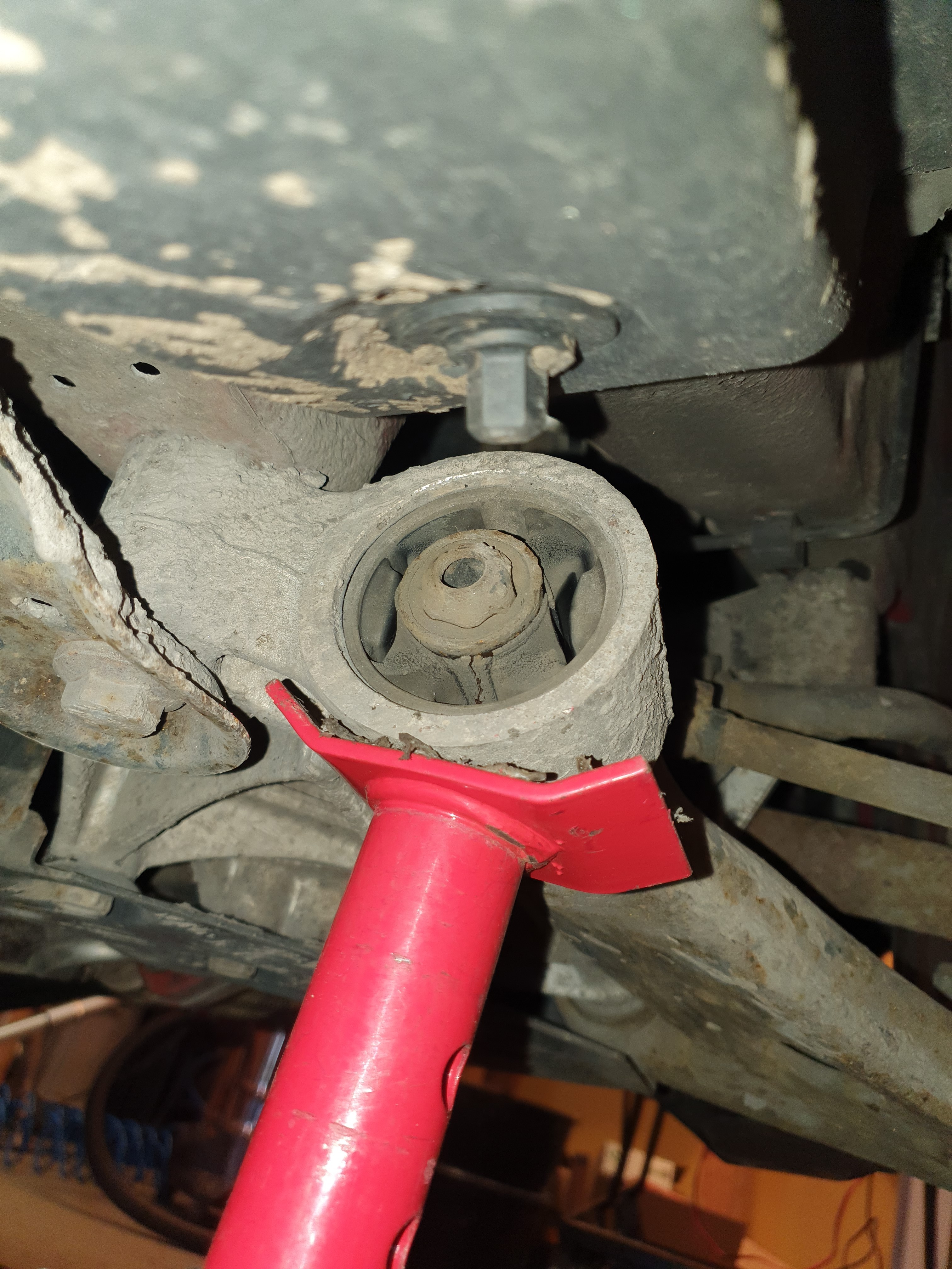

I found a crack in the lower control arm bushing.. Is this enough to cause very uneven wear you think?
bushing1.mkv
Definitely; the toe angle could be all over the place under acceleration and under braking.

Best idea is to refit the wheel (if removed currently), recruit an assistant equipped with gloves and then ask them to rock the wheel about its vertical axis, holding it at 9 and 3 o'clock, while you watch how much movement there really is at that pin/bush interface (video it for later reference).  Then repeat on the other side as a comparison.
Just noticed the pry-bar video; that doesn't look like much movement to me. Compare to other side.
Sorry I was a little sloppy and forgot to mention the attached video. Did you reply to the post in regards to the video, or just to the written question in text?
I didn't look at the video, but a pry bar will not apply the same sorts of dynamic loads as the car will.
Thanks. I tried it. When rocking the wheels as you described that bushing / pin doesn't move at all on either of the sides.
And I don't think its any play in the steering ball joint neither. When the steering wheel is locked you can rock it a little, but the klonk-sound comes from firther inside, steering gear..? so I think those are nice.
I also tested prying the control arm bushing on the opposite side the same way as the first one, and it was more solid.. But still as you said, it doesn't move much. When comparing with ppl on youtube that replace the bushing, mine still looks OK.
