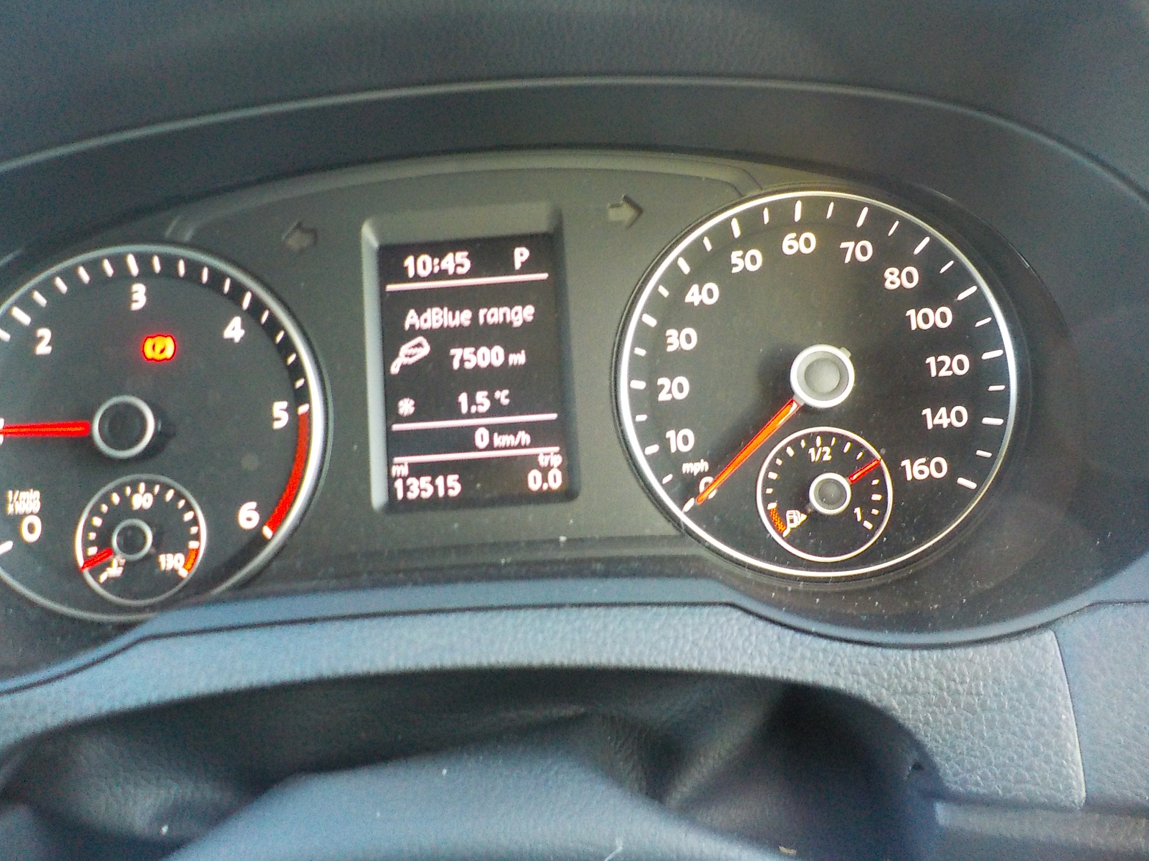

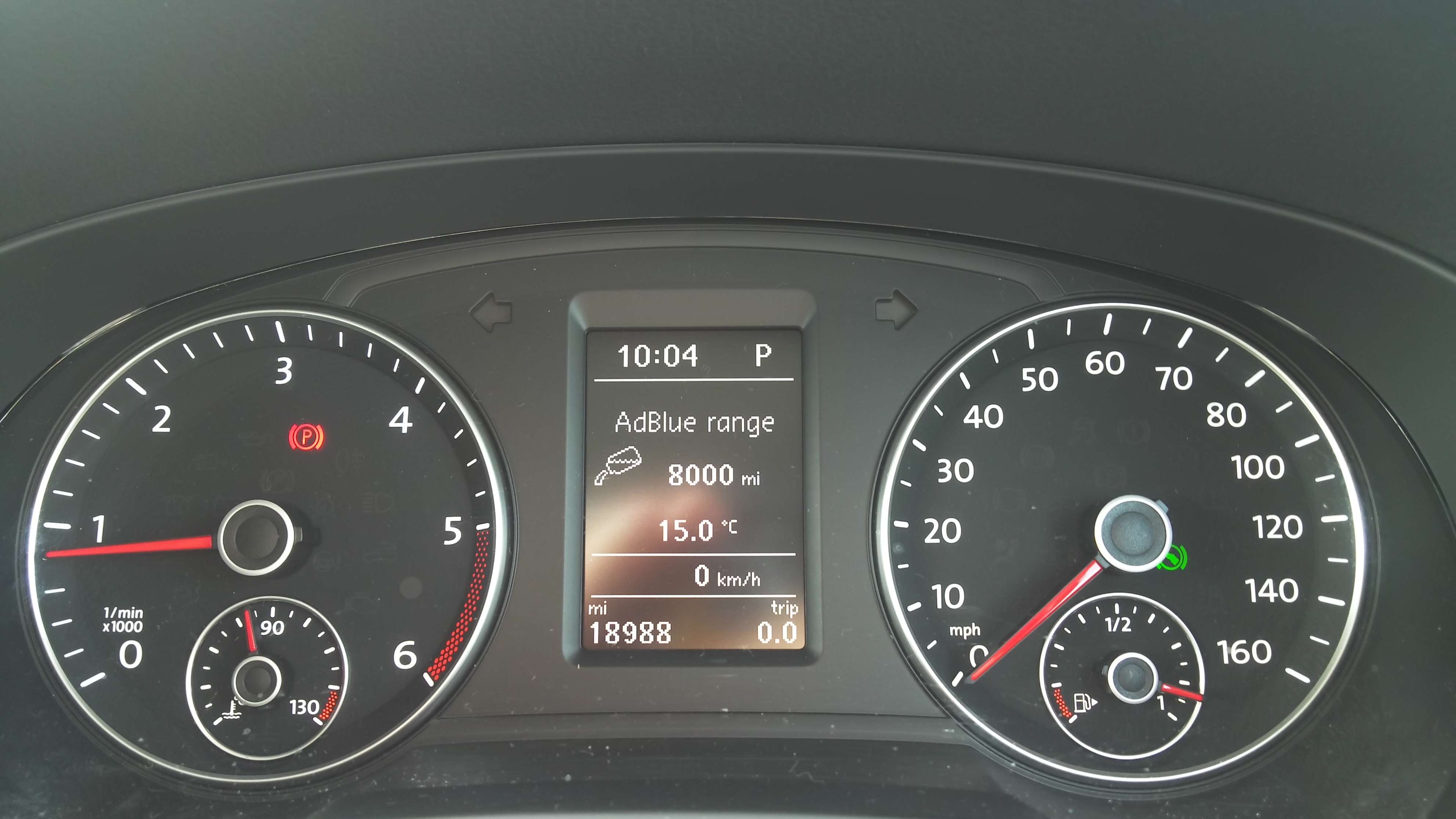

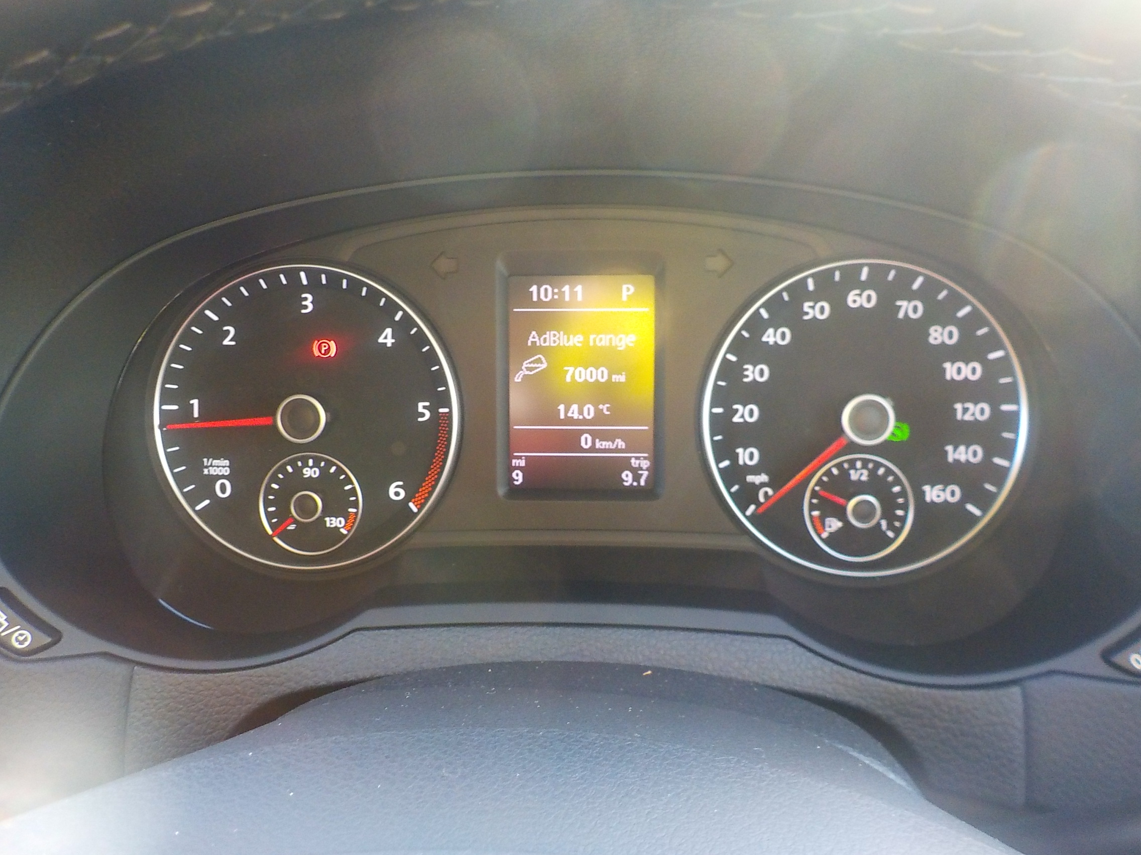

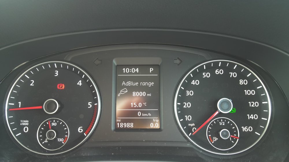

I'm in a similar position as I've retired sine buying my diesel.  During the winter, especially if we have a spell of bad weather and I don't go far, I have to drive up and down the Brecon Bypass to clear the DPF.  It's OK at the moment as I'm in Lithuania and the long drive doesn't give any active regeneration problems.  When I started out from home, the car was showing AdBlue range was 5,500 miles and after covering over 1,600 miles, the range has only dropped to 5,000 miles, so I assume the DPF runs cleaner when the car is covering long distances at full temperature.
@PenpusherThe issue is that the range for Adblue stops dropping by the likes of 500 miles a time and when you fill with Adblue the range gets better as the miles go on the car,
then eventually Regens get more frequent and Adblue is sipped and the clogged DPF starts showing and takes longer and longer to clear.
