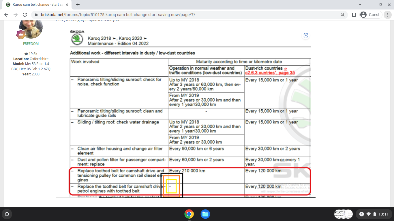

The main point being the frequency of when it should be changed.
Skoda now state 10 years, although they're not prepared to guarantee that.

I’ve said for a long time that the 5 year thing has always been a uk rip off on these tsi engines. I can understand anyone being worried and getting the belt changed, but the every 5 years age thing doesn’t make sense and was never in the official service manuals but dealers and many specialists have quoted it for years.
Thank goodness they are officially saying it isn’t needed.

Just to help confirm everyone comments, the Skoda website now appears to have removed all mention of the Cambelt 5 yearly Change in its maintenance section.. Looks like it is no longer a thing...
