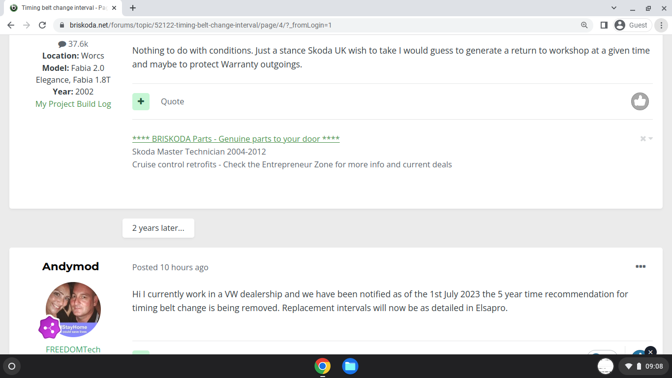

Here.
Thanks I bet those paying for a new belt might be a bit miffed.
1 hour ago, toot said:
Here.
....... So what does 'Elsapro' say?  (And what is it?)
A quick Google of Elsapro returns that it is the VW dealers portal.
Thanks @Kenny R.
Now if only someone could tell us what Elsapro said......

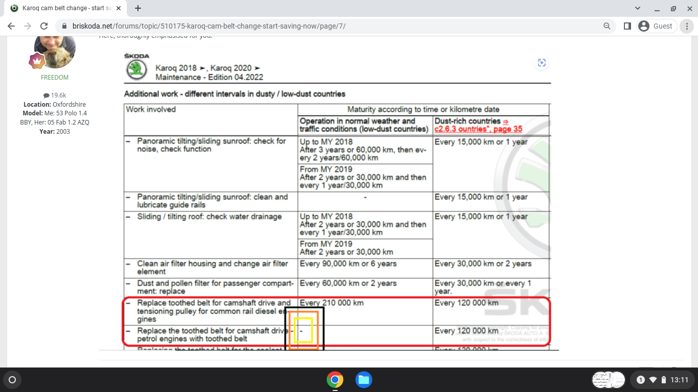

210,000 km / 130,000 miles.
368071363_Screenshot2022-03-2511_55_58.jpg.edf9de7f74f6008ca469ca99fb9091d8.jpg.59c8e70155a4cf78e8950a1f2f6ef6be.jpg.488811631264d00d7403f888744f31c2.jpg

The EA211 Evo 1.5 ACT Self Study Program says the belt is maintenance free, if you put a Evo2 car into the Digital Service system there is no distance or time interval BUT I would say 100k miles or ten years.
So looking like it is nearer 210,000km (about 130,000 miles)
No specific time interval, but supposed to be inspected at major services for wear which will guide, and estimates seem to be 10-15 years, so let's use about 12 years as prediction
Slightly over double the old suggestion of 5 years or 60,000 miles
Which suggests realistically only really need to start worrying about the replacement cost at >8 years or >90,000 miles

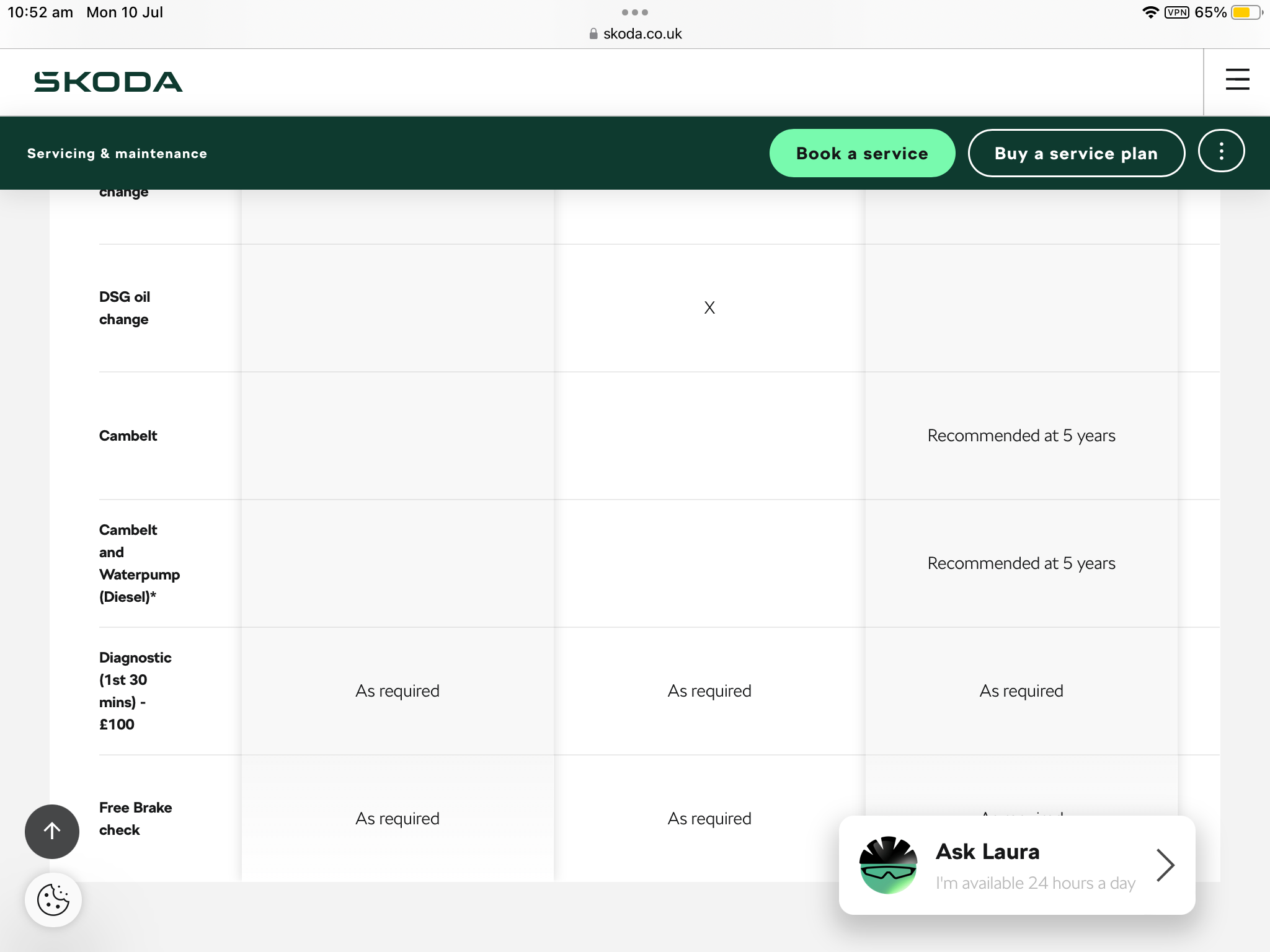

I contacted them via their main number... https://www.skoda.co.uk/discover/contact-us
I'm hoping to hear other people have contacted Skoda and find out what they are told? Skoda's website still says 5years/50k, but I assume it will be changed soonish.
Thank you all, and @tootin particular , for all the info on here, saved me a lot of money in these expensive days. Top stuff everyone :)
Not sure what it was before but now saying recommended at 5 years.  Not the definite “X” or “as required”.
I’ll prob wait until 50k miles, which with the miles I do will be at about 10 years.  Cynic in me wonders if it’s coz dealers are struggling for technicians and this is a way of freeing up capacity.
