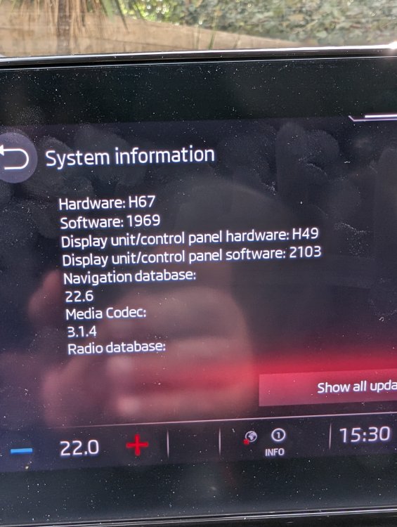

I recently purchased a new Karoq SE L which has the ability to connect to Android Auto (AA) wirelessly. My phone (Samsung A52) initially connects AA wirelessly but after a few seconds it will disconnect. The phone works fine with AA with a wired connection.  I have tried re-pairing the phone to the car but this hasn't made a difference. I went back to the dealer and the salesman tried his iPhone wirelessly and it worked first time.  Has anybody had a similar issue or got any ideas?

Have exactly the same issue. Wireless drops out after a few seconds. Usb connection stable and reliable. karoq se drive purchased 25/7/23. Sony Xperia 10iv. Tried deleting repairing and looked at permissions. No joy. So now to purchase a short usb cable so at least it's tidy.
I had this exact same issue after picking up my new Karoq SE L on Wednesday. Android Auto worked fine with a usb cable but dropped the wireless connection after a few seconds when not connected via usb and refused to reconnect. I found a reference online to a setting in my phone (Samsung Z Flip3) that suggested a conflict if Android Auto had been used on other cars. This seemed worthy of investigation as Android Auto worked seamlessly on my wife's Kamiq.

Further update. When I collected the car from the dealer the "expert" who could verify Skoda connect was on holiday so, to be able to use remote locking etc, I had to return to the dealer with my driving licence to finish the set up. On arriving at the dealer today I was told she'd rung in sick and she was the only person trained to use the Skoda Connect system.
Getting to the point on Android Auto, I mentioned my problems to a very IT savvy tech who suggested that, as the phone connects sometimes, it doesn't appear to be a phone problem. He suggested unpairing my phone from the car and performing a factory reset on the car. He sat with me while I did this. With the factory reset done  I re- paired my phone and Android Auto immediately started via wi-fi without selecting the App button or any prompting from me. He couldn't identify what the original issue might have been but did suggest it may have been a conflict with Skoda Connect. On the 40 minute drive home I listened to Spotify wirelessly via Android Auto.
Obviously, after the factory reset, I then had to reconfigure the Skoda Connect App while I both keys were present in the car. I did this when I got home and, as soon as I verified the Skoda Connect account on my phone, Android Auto disconnected and asked me to connect via usb.
It seems that the technician was correct in that there is a conflict between Skoda Connect and wireless Android Auto. Not sure where to go from here.

The car additionally has an active Skoda Connect account enabled.

I have the exact same issue connecting wirelessly to Android Auto on my Karoq SL 1.5 2023 model.
I have had the car around 10 weeks now, I notice that on the notifications in the car that the e-sim data connection is not available, I am not sure if this is causing an issue or not but the dealer seemed to think this was the problem and Skoda are aware of it and trying to fix the issue.
