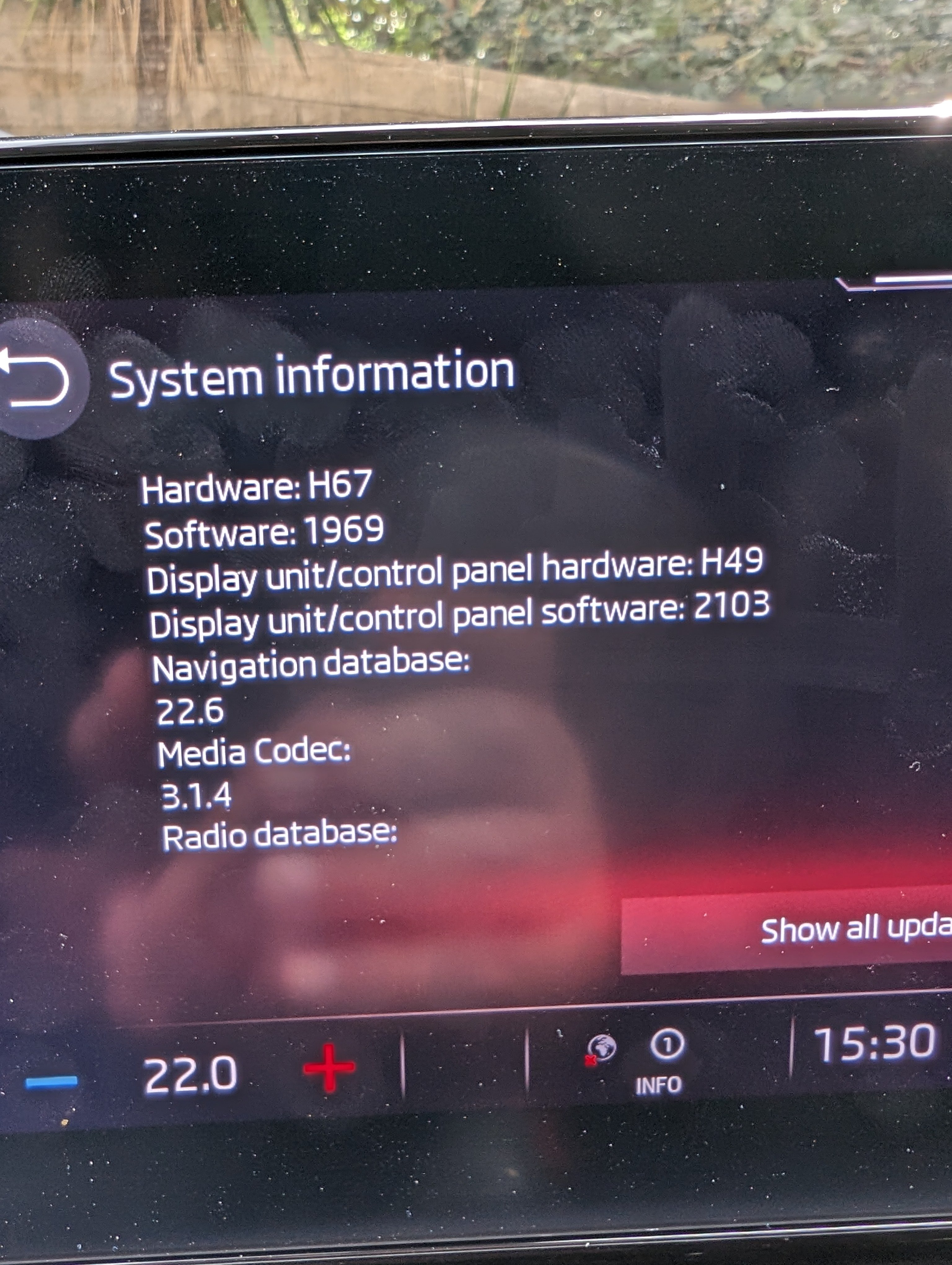

Here's what I'm seeing for system information.  Looks like my SW version is 1969 whatever that means.  When I clicked om "show all updates" I got a blank screen.  Anyone have any insight?
The blank screen on software updates just means it hasn't downloaded any OTA software updates for you yet.  It will change if and when it does.
As you have an Octavia, you should probably look in the Octavia forum here for specific advice   www.briskoda.net/forums/topic/522574-update-to-version-1969/    .  Version 1969 appears to be the most recent for your model / hardware.
