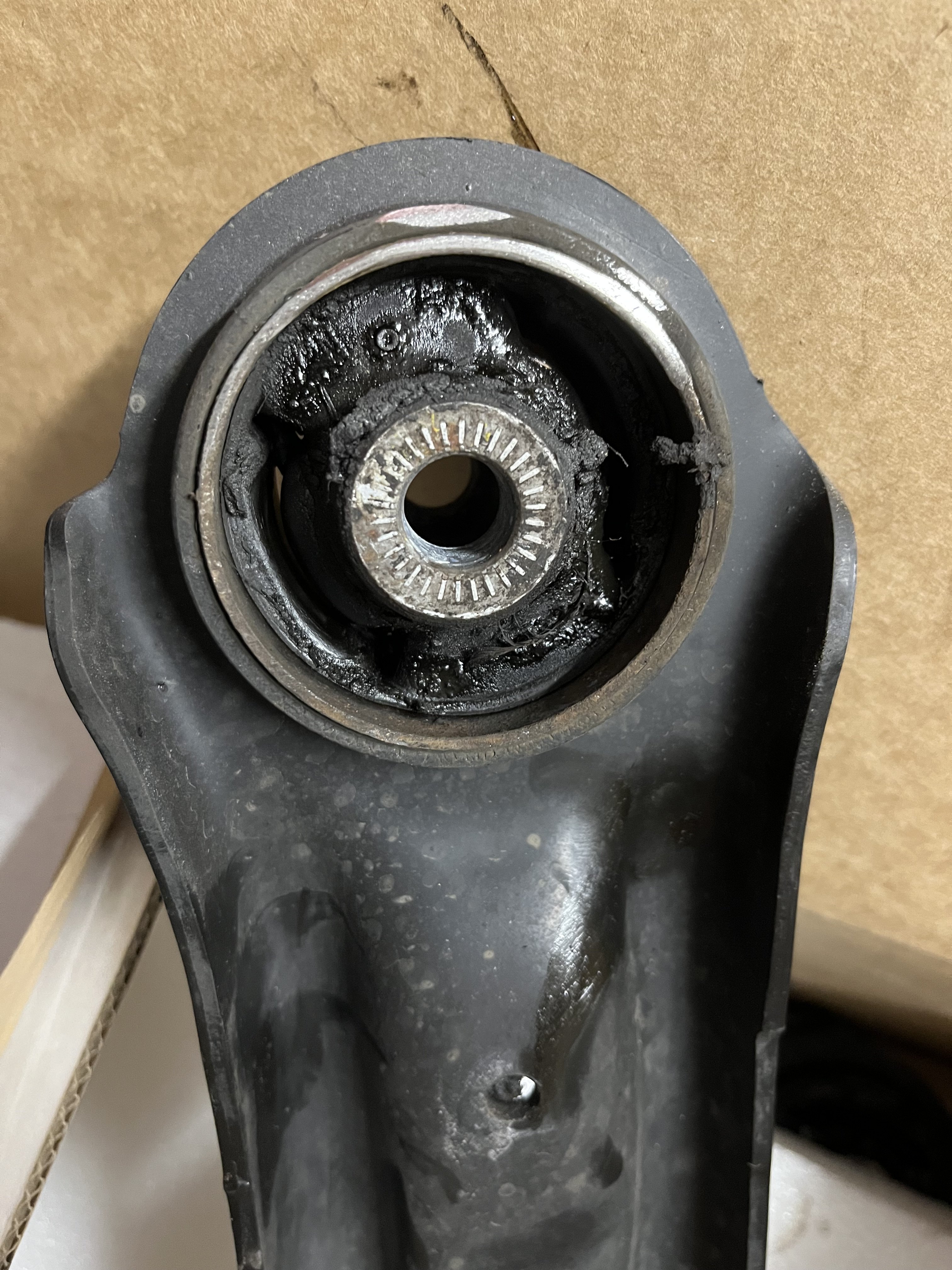

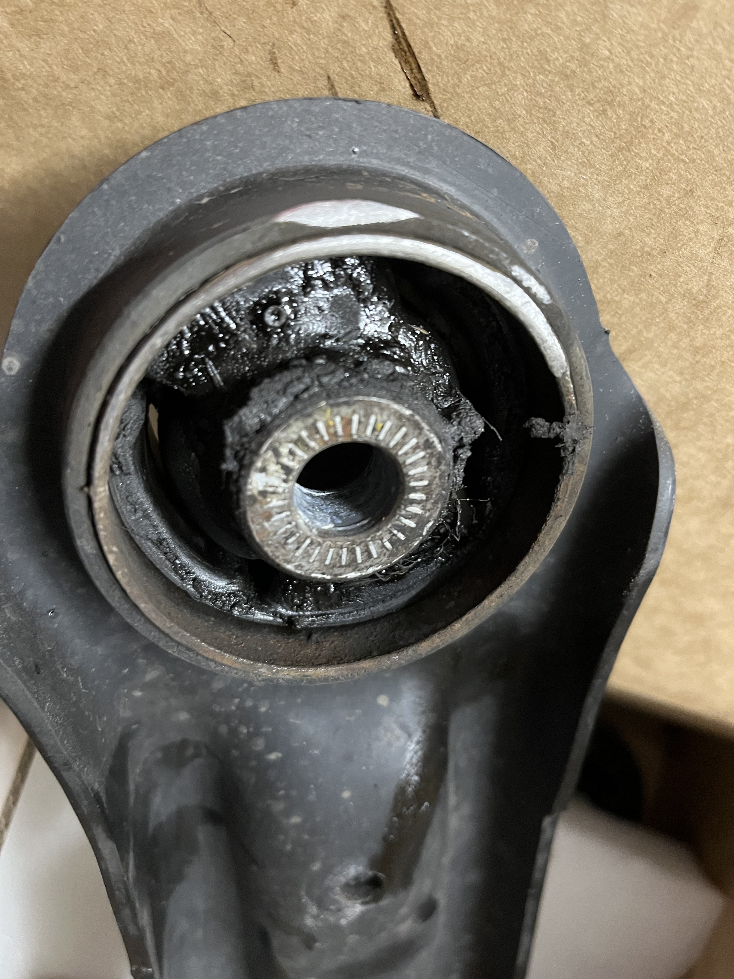

The longevity will be far more than the original void bushes, they were probably still like new, they have metal to metal contact from new and the dealers slather them with grease, some forum members were even brainwashed into thinking it was a standard service procedure.

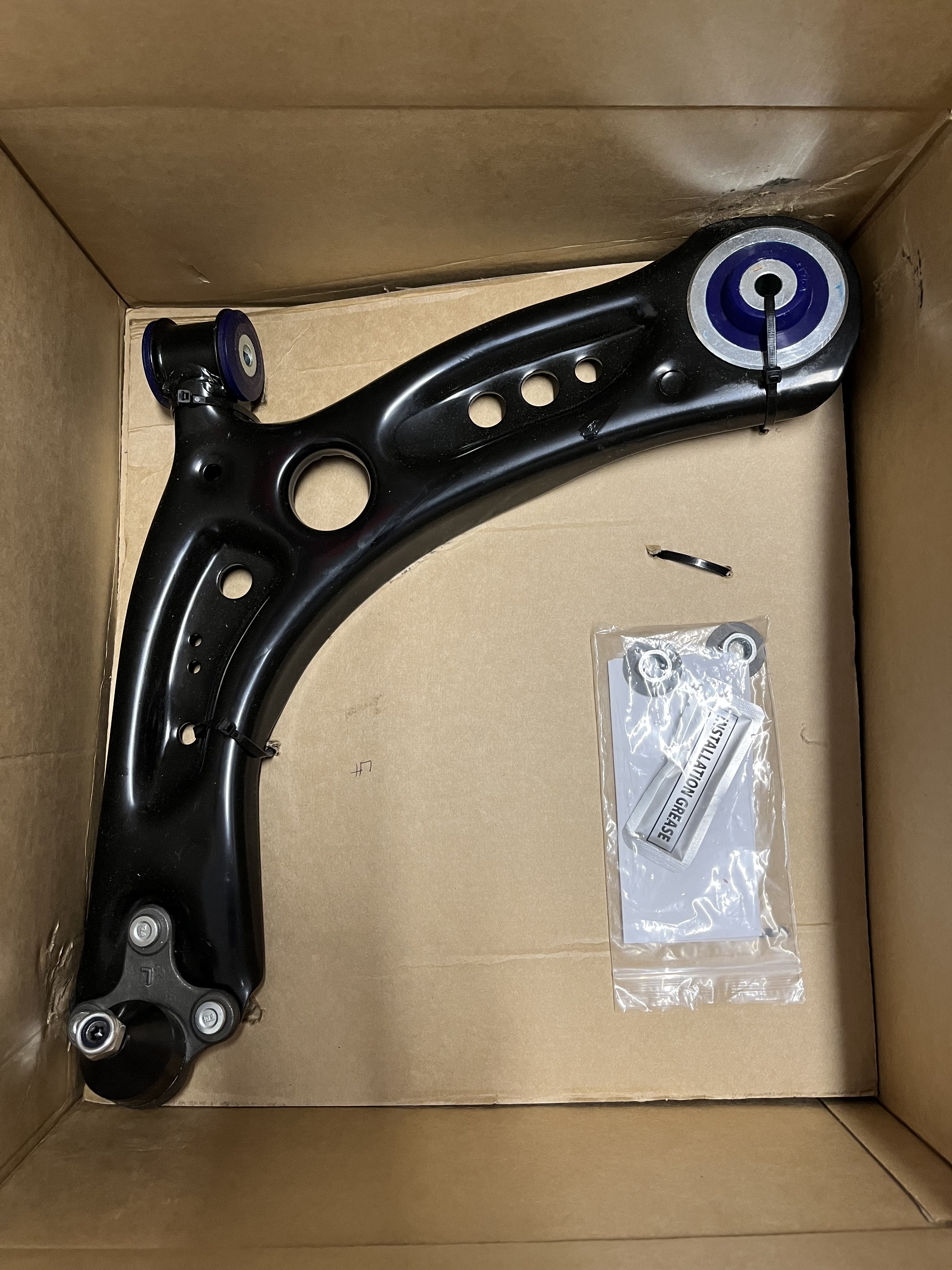

The new arms were £230 or thereabouts plus postage depending on where you are. Everything to N.I from the mainland is like a million pounds to send these days, if they’ll even send it at all. A lot of mainland delivery is free.

The entire arm was replaced as it wasn’t that much more expensive to buy the entire arm compared to buying the bushes and the ball joint separately.
Also the fact that on quite a few occasions, the OEM arms can allow the replacement bush to flex/move after being pressed in. The arm must distort slightly during fitment. This requires a new arm anyway.
With all the time wasted messing about pressing, it’s just handier and quicker to replace the arms.
it’s personal preference though, as I’ve seen the bushes you refer to giving great results as well.
I actually was initially going to try that route until I found the ones I used and for the reasons above just went that route.

The arms are definitely the source of the creaking/grinding and well worth the cost in mental health benefits alone.

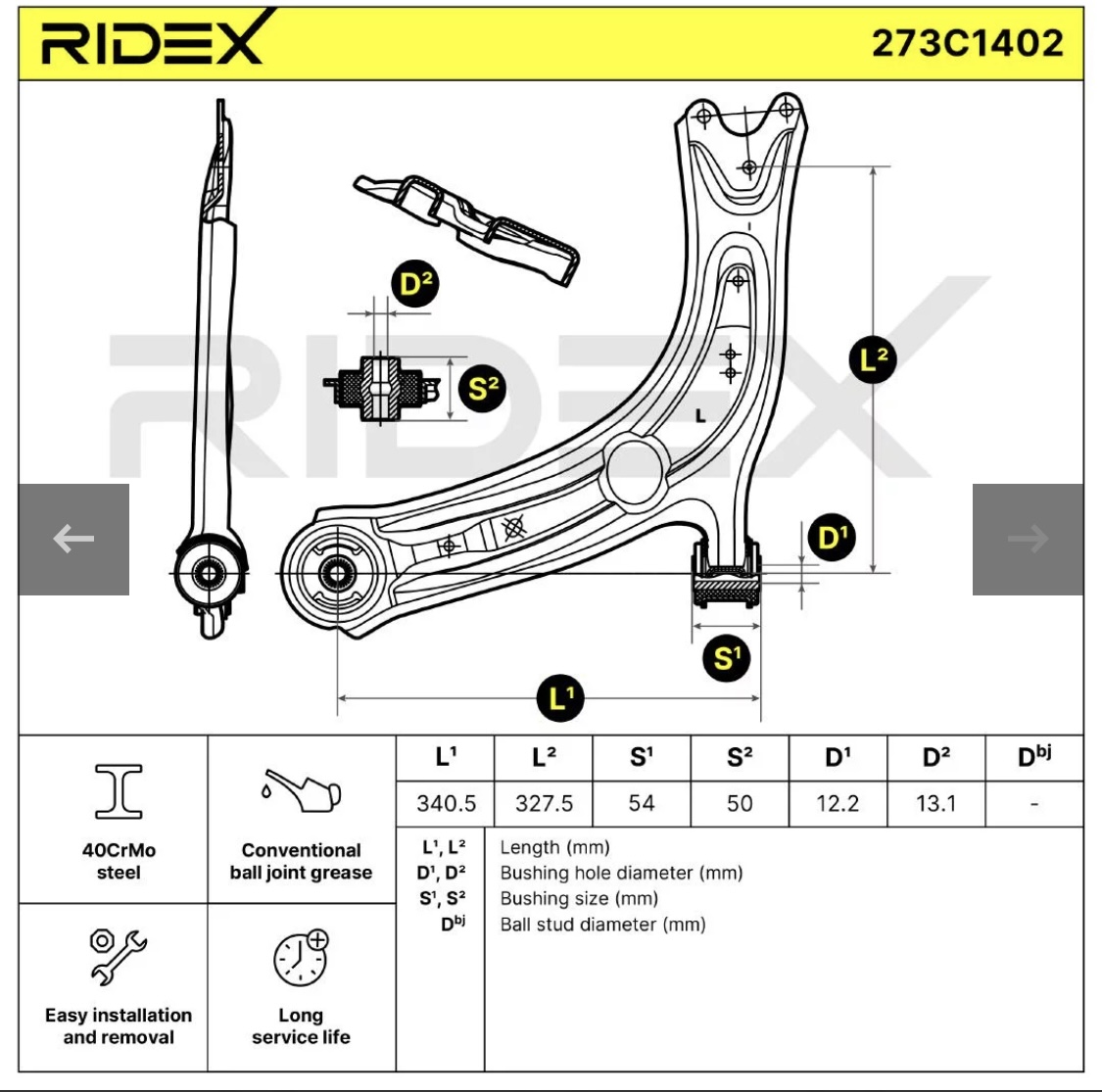

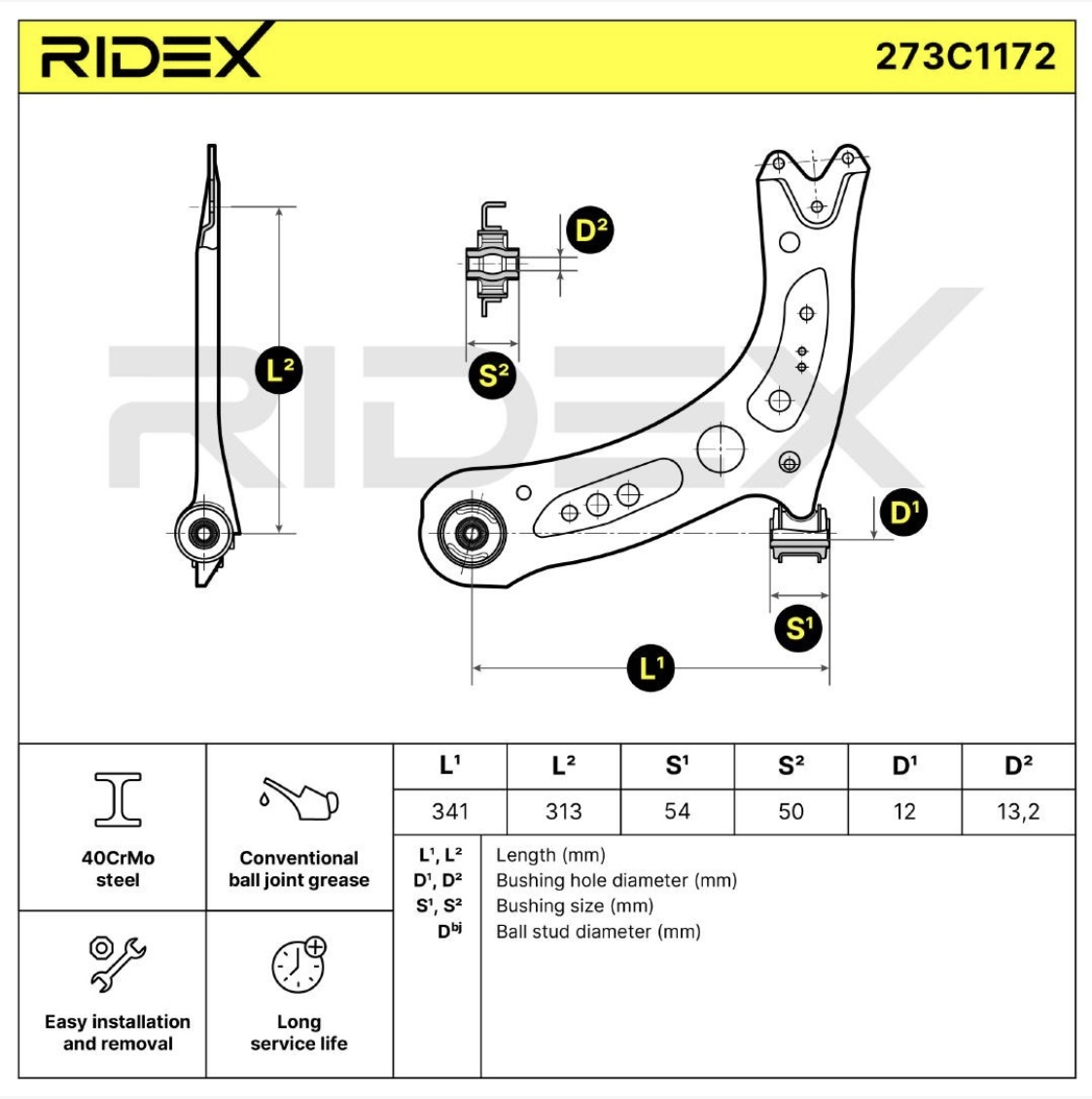

So then I thought I’d research the golf vs superb control arms and found this.
Golf control arm is 313 ‘wide’.
Superb control arm is 327.5 ‘wide’.
So now I’m fascinated as to how this has worked, because this ties up with what the Aussie person found.
Thoughts anyone?

I'm the Aussie guy who had TRC1070 on my Superb and then removed it. I can confirm the arms for Golf are shorter than the ones on Superb.
I also did some calculation:
The front track on a Golf R MK7.5 is 1537mm. The OEM wheels on MK7.5 are et50, So the distance from left disc to right disc is 1637mm.
The front track on Superb is 1578mm, supernova wheels are et44. The distance between two discs is 1666mm.
AFAIK, the subframe on Golf R and Superb are actually the same size, correct me if I am wrong. In this case, two arms on Superb are 29mm longer than Golf R's arms in total. So each is 14.5mm longer.
Which 100% match the number you showed here.
