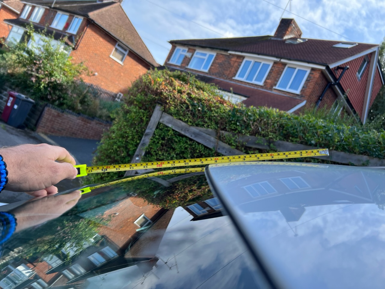

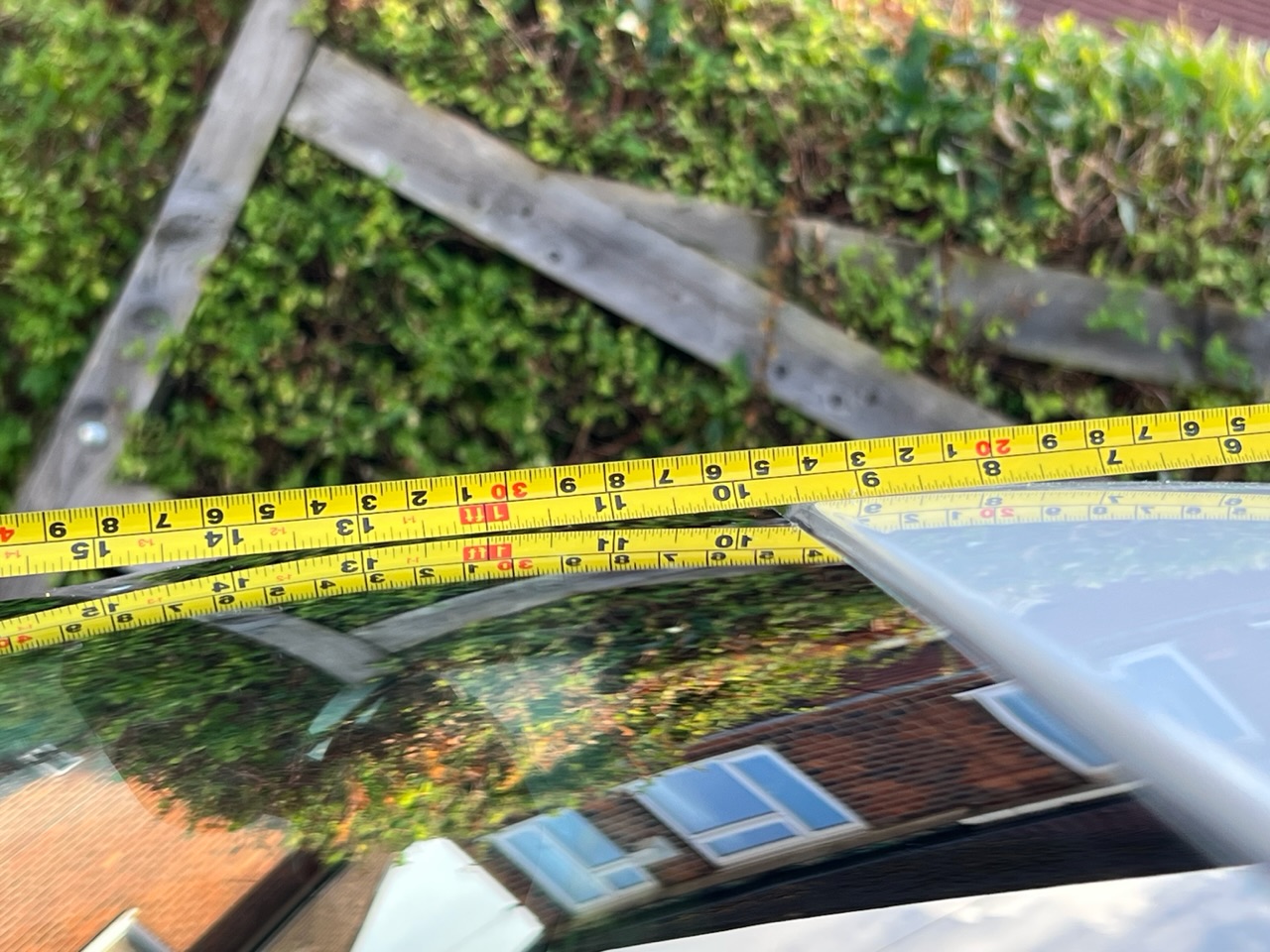

The windscreen fitted is sadly a poorly  manufactured pattern part by XYG.

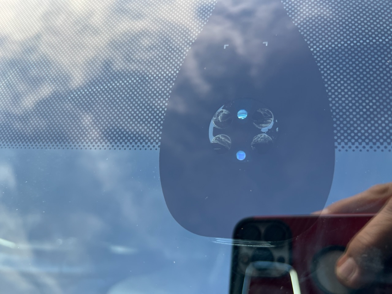

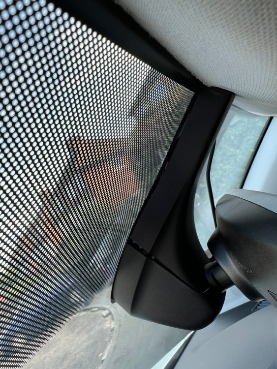

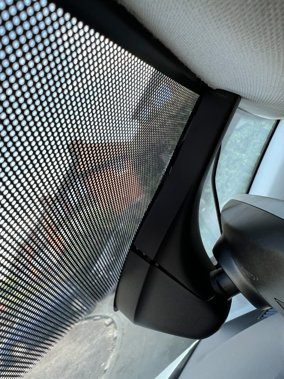

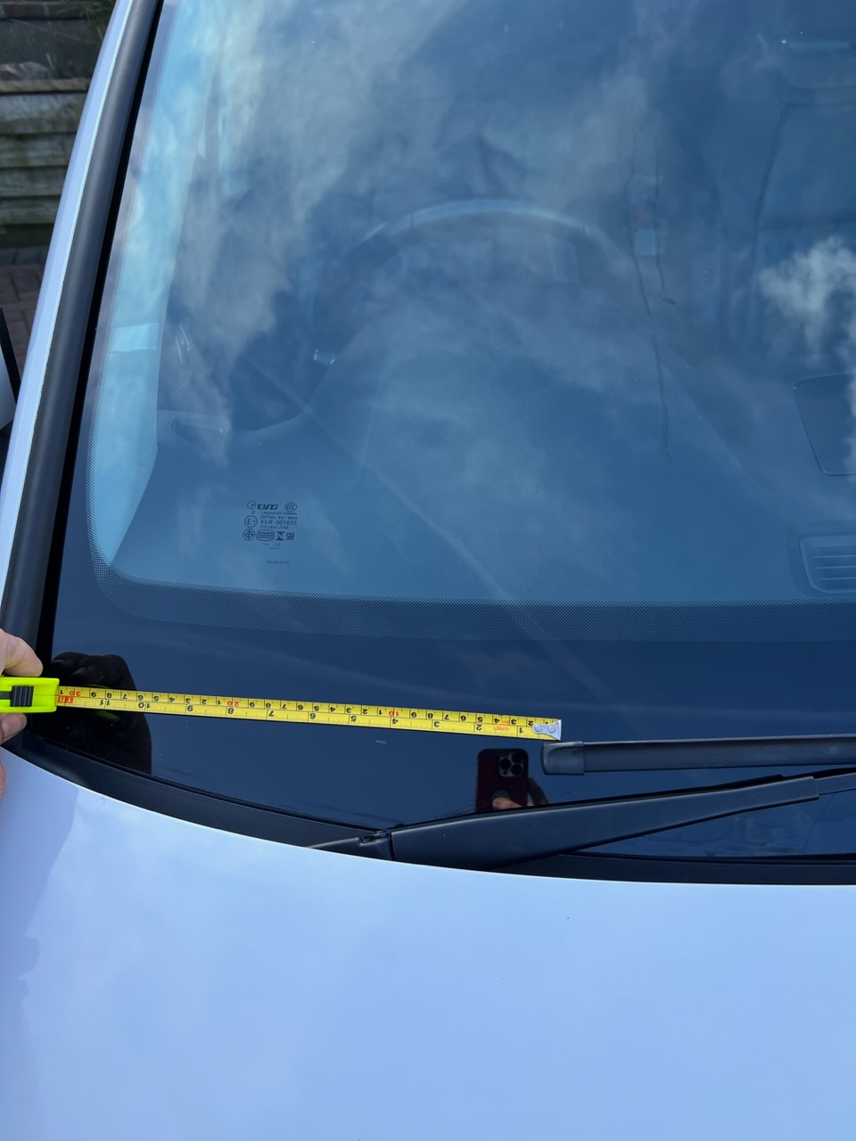

The windscreen glass bows at the top and is misshapen. This means the rear view plastics don’t fit properly around the rear view mirror and fall off and rattle. The profile of the front of the car is all off, the glass doesn’t follow the bodywork properly. There’s a manufacturers logo printed about nine inches into the screen and the sensor area of the screen now has white blotches to it.
So hard to show in photos but the windscreen curves lower down is straight along most of the swept area then curves awkwardly at the top excessively.
I am hopeful that the company comes back shortly with the correct manufacturers part rather than a poor copy from a clone factory. Curious what other people have fitted or if they have had similar problems?

If anyone had photos of the top curvature of their screen and the sensor area that'd be appreciated.
I am curious how much the top of our windscreen is out by and if the dip/drop at the top if the same on the VW/AG screens.

The blotches on your rain light sensor are just due to them not replacing the silicone pad.
but the quality of the screen and that bulge, unless anyone’s else is like it, that’s shocking glass….

They have also conceded that the sensor pad should have been fixed when they swapped the screens.
