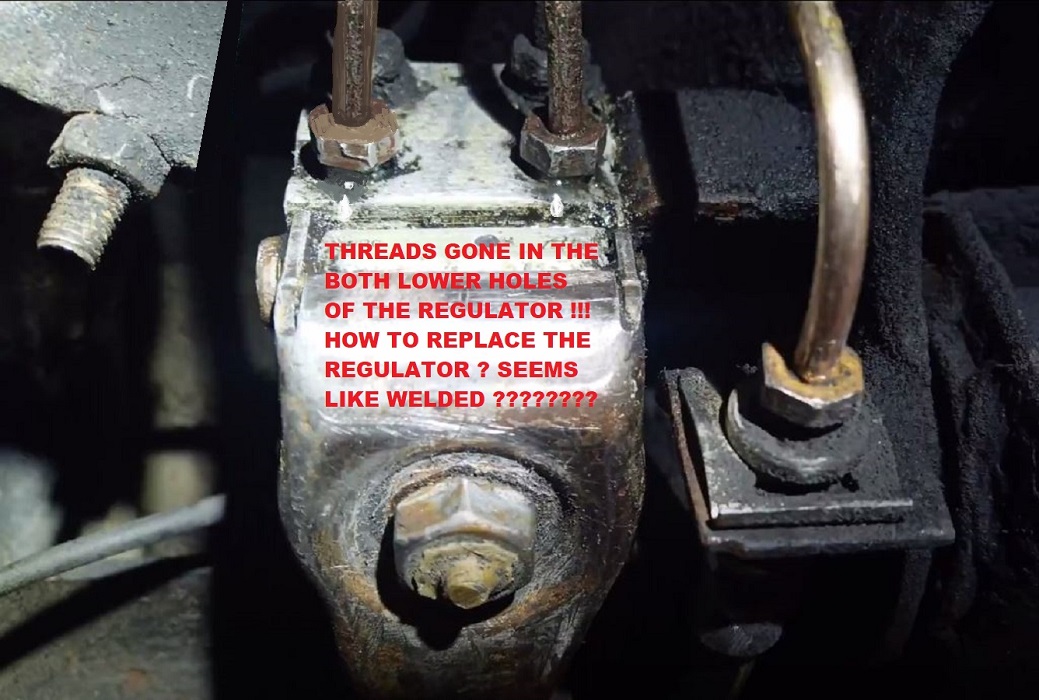

I managed to change all the rusty rear part brake pipes and also all the brake hoses, but now it seems, that the threads in this 23 y.o. regulator are gone.
So I should change also this regulator/balancer/compensator. They are rather expensive, but that is not the main problem.
The main problem is how to remove the old regulator and to attach the new one.
It seems like being welded into the body of the car or at least to the rear axle ?
Regards, JussiG7 from Finland
There is 2 allen cap head bolts on the side that run all the way through the regulator.
Be careful not to round the allen heads off.
When I changed mine the bolts were well and truly ceased in, and I had to weld Allen bits into the bolt heads to avoid rounding them off.
I wouldn't have thought that the threads would be gone unless the pipe bolts were cross threaded or were massively over tightened, I mean 100Nm or more.
I found these a quite tricky to get in because of the bend in the pipe is so close to the end it wanted to pull the bolt back out of the regulator as I was screwing it in.
Just remembered, I had to remove the exhaust rear section to gain enough working space to remove the regulator bolts.

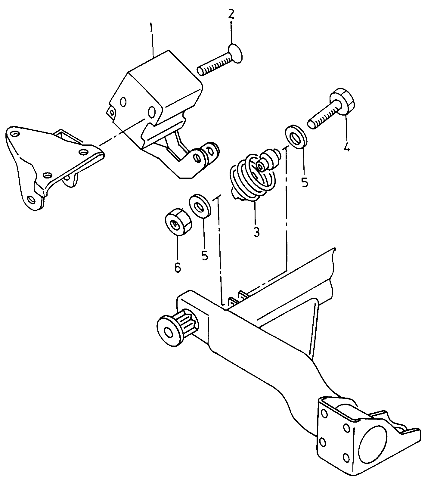

I have a 1998 Felicia and have not changed the regulator yet but I did do a search see pics the bolts Number 2 are countersunk M8 X 58 you could buy S/S bolts and cut them down to size.
Do let us know how you get on with the replacement.
That's what I did, I seem to remember that I used 60mm length, the extra 2mm isn't of much concern, because the bolts screw into what are effectively captive nuts on the beam axle which allows the extra length to pertrude.
Oh, and I did forgot that the bolts were countersunk, and not caphead.

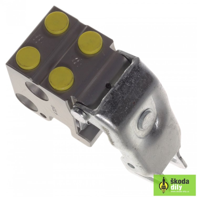

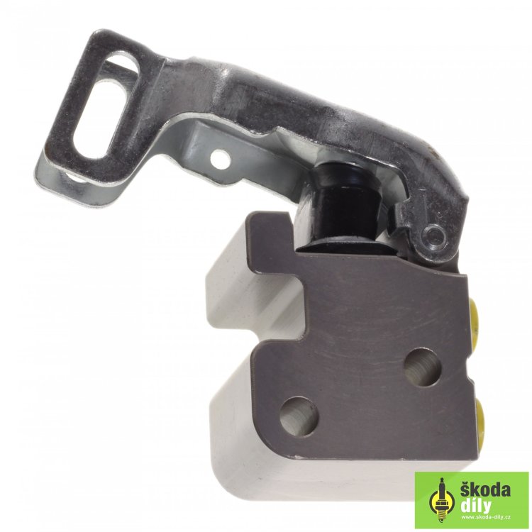

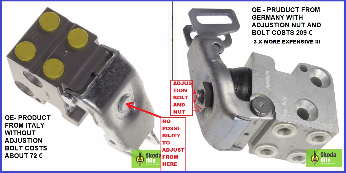

I suppose I shall not use this car more than 3 years max. So, I ordered the cheaper Italian OE - part from Skoda-Parts.com .
The German alternative would be 3 times more expensive, but it seems to have a possibility to adjust the valve with a bolt and nut.
Actually, I had to adjust the old regulator a bit two years ago, because it gave too much brake power to the front wheels versus the rear wheels.
But I suppose that also the Italian version works well the first 20 years. Would you have any comments to this subtopic?

The Italian one from skoda-parts is the exact one I fitted, and I have had no issues so far, it's been fitted for just over a year now. Remember there is some adjustment available from where abouts a you bolt the regulator's arm to the beam axle.
