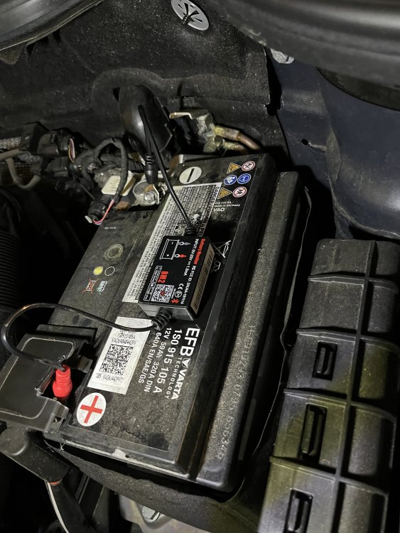

Hi.  Hoping that somebody might be able to help me.  We rarely use our Skoda Karoq any more, so it spends a lot of time in the garage.  A couple of weeks ago I got lots of different warning messages pop up on the screen when I tried to start it.  So I called Skoda breakdown assistance.  Within minutes of arriving, they diagnosed the problem as being a low battery (which interestingly, seemed to be the only warning message which was NOT popping up on the screen!).  I heard lots of good things about the BM2 battery monitor, which you just connect to the positive and negative terminals of the battery, and you then connect to it using bluetooth on your mobile phone, and use an app to see the state of the battery, get warning messages when you're near the car if the battery is low etc.  So I bought one of these BM2 devices, and I tried to install it today.  I was able to fit one of the BM2's terminals to the Karoq battery terminal which is closest to the front of the car, by loosening the nut on the battery sufficiently to slide the terminal of the BM2 into place and then tightening it again.  But I just couldn't figure out how to attach the other BM2 terminal to the Karoq battery terminal which is furthest from the front of the car.  I loosened the nut, but there is a formed metal piece which prevents you from sliding anything in behind the nut.  The clamp of the battery lead seems to be sprung so that it pushes the nut against this formed metal part.  Do I have to completely disassemble this clamp component?
I was hoping to not have to completely disconnect the battery, but ended up loosening the nut that it disconnected anyway.  I then got all kinds of warning messages when I tried to start the engine again.  Fortunately I remembered what the Skoda breakdown assistance guy told me a couple of weeks ago.  You have to turn the steering wheel as far as possible one way and then the other, in order to reset these warning messages.

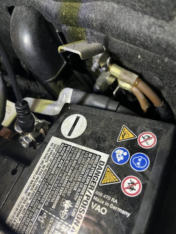

Is there enough thread to just fit the terminal on top of existing nut and then add another nut?
Photos would help us understand the problem.

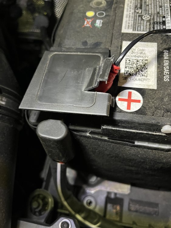

Thanks for the tip! I don’t know why I didn’t think of that in the first place!  I had a spare M6 nut in my garage, which I used to attach the BM2 terminal.
There’s a plastic flap over the positive battery terminal, and I had to cut into that with a Stanley knife and fold it back a bit, in order to make room for the BM2 terminal to protrude. It’s all working fine now. Once I had actually attached the terminals, it was literally a 2-minute job to download the app, and connect to the BM2 via Bluetooth.
