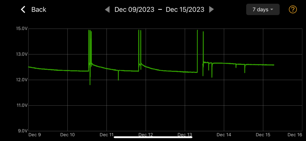

For those of you who were wondering whether my battery really was reaching end of life, or whether it was perhaps the BM2 battery monitor itself which was draining the battery, here’s the answer, from a screenshot which I took this morning in the BM2 app. You can see that since I changed the battery a couple of days ago, the daily drop in voltage is significantly less than it was with the old battery.  I haven’t driven the car during the previous 2 days. The temporary dips in voltage were when I simply opened the car door, in order to pop the bonnet open.

Hello Mark, for reference, did you change the battery before Dec 9?

No, I changed it on December 13th

Those dips are proof of how careful one must be when measuring the at-rest battery voltage to check its State Of Charge.

Then it is not a valid comparison if you had driven the car in the days before as the graph indicates to me.
What I believe I can see on the previous days is the battery voltage dropping quickly after the engine is shut down and the battery cools then discharging at a similar rate to the new one.
On December 10th I (believe) can see a short journey with what looks like a restart, perhaps with the vehicle paused with the ignition on or the keys in the ignition, on the 11th it looks like another short journey and possibly a restart right at the end, nothing on the 12th, on the 13th the new battery fitted with one start to make sure everything was OK before shutting down.
Very useful to have the data available though.
What I am seeing is a flatter discharge curve after the battery was changed - which looks to be the gap in the trace around midday on the 13th. I'm estimating a difference of approx. 0.2 volt, see how it goes I guess.
