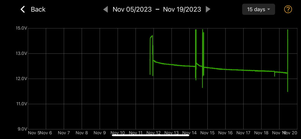

Without this BM2 device to see what’s happening to the voltage in real time, I would never have been able to see what actually happens when you use a battery charger

checked it this morning, and it’s now showing 12.62V. Is that the level where a 12V battery in reasonable condition should be?
Yes, several hours or the day after charging that is about right, a battery that has suffered damage from discharge but still useable will be at say 12.4-12.5 volts, same for an older aged battery.
2 hours ago, Mark-Surrey said:
It was almost completely discharged a couple of weeks ago, after using it only infrequently, and only for short trips. But I have recharged it since then with my CTEK MXS 5.0 battery charger/ conditioner. The Skoda breakdown assistance guy said that the almost complete discharge was likely to have reduced the future performance of the battery somewhat
That is correct but it depends on what you mean by completely discharged, without the no load recovered cell voltage the term is meaningless, 10.5 volts is classed as completely discharged, beneath that sulphation occurs which is why I dont like the recommendation to discharge to 7.5v to use the recondition function.

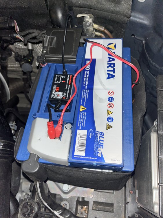

I ended up getting a brand new battery fitted by my local independent garage. It was £170 including fitting, for a Varta EFB battery. They moved my BM2 battery monitor to my new battery. The new Varta battery even has a recess on the top which is the perfect size for the BM2 battery monitor!
They also fitted the cable for my CTEK battery conditioner to the battery, so I can connect the CTEK device more easily, without having to mess around with crocodile clips.
Both unfused and exposed.

Can’t see the -ve from the charger cable, but it should be connected to the dedicated connection on the bulkhead and not to the battery -ve post.
Thanks for your sound advice. I just checked, and you are absolutely correct. They have connected both the battery monitor cable and the CTEK charger cable to the negative battery post.  Can I just attach the negative CTEK charger lead to one of the posts underneath the metal bracket where I would normally attach the crocodile clip?
From what I can see, the CTEK lead is currently attached to the negative battery post using a secondary nut, so I should be able to move it without affecting anything else with the battery itself.
Yes, and with a bit of luck the secondary nut you remove will fit the connection on the bulkhead.
 Thanks @Kenny R! All sorted now, with your kind assistance
