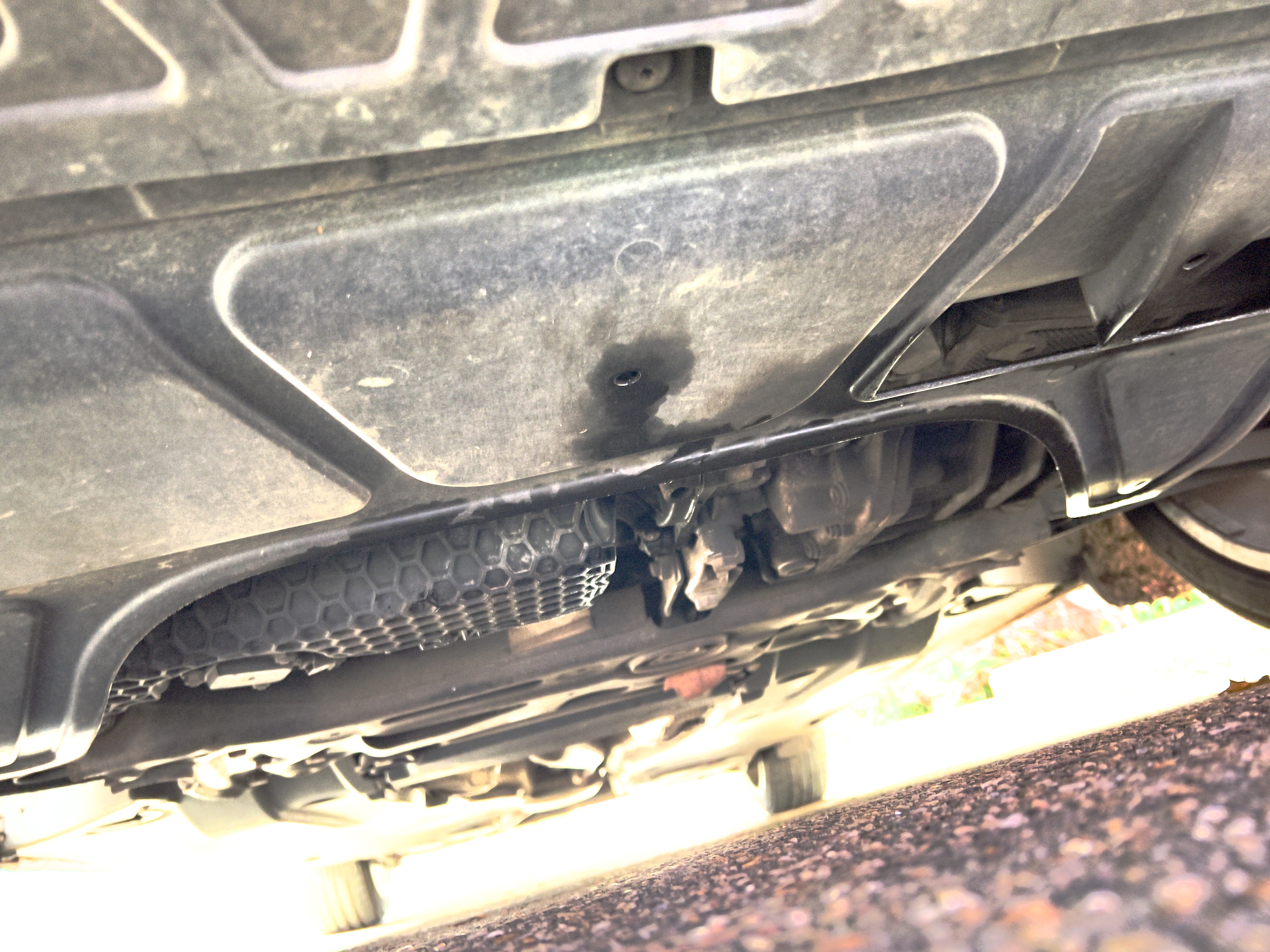

Damn its a coolant leak ….. Not enough to drip onto the drive but the dark patches are coolant all right …. Not going to risk the airport run in it …

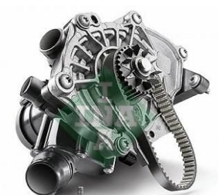

Likely thermostat/water pump housing leaking on front of engine - super common on these engines. Mine was a £700 job to fix inc. parts at my trusted local garage. Skoda quote was over 1K.
I second that @edwards, similar cost for me recently to get the water pump changed following a similar leak, although timing belt changed too whilst they were there.

The EA888 Engine on the Skoda Superb 280 / 272 is a timing chain not belt. It doesn't need replaced.
The thermostat and water pump in this engine is guaranteed to failed🤣 Even you replace it now, it will still fail again.
Some aftermarket water pump has a better quality.
Indeed. Perhaps it was the belt drive to the water pump they were talking about?
