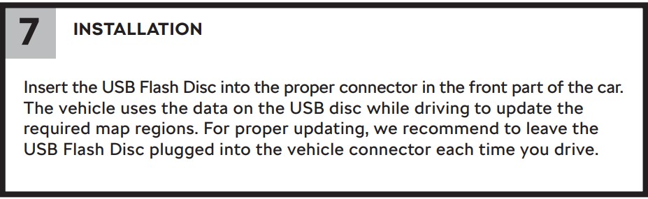

This is what's confusing me...
Now confused as there's no option to update it. 😕

Hardly an explicit set of instructions and can see the opportunity for confusion.
FWIW, my interpretation is that it could take a while to update the whole map dataset hence the recommendation to leave the flash drive plugged. Not sure I have any idea how long 'a while' is though. If it were me, I'd do it on a trip to the in-laws some 300 miles away rather than a run to the local supermarket.
If you're not doing any/many long trips maybe just leave it in the port for a few weeks and check the Nav Db dates periodically to if/when it's updated; it'd only need to be once a year or so.
