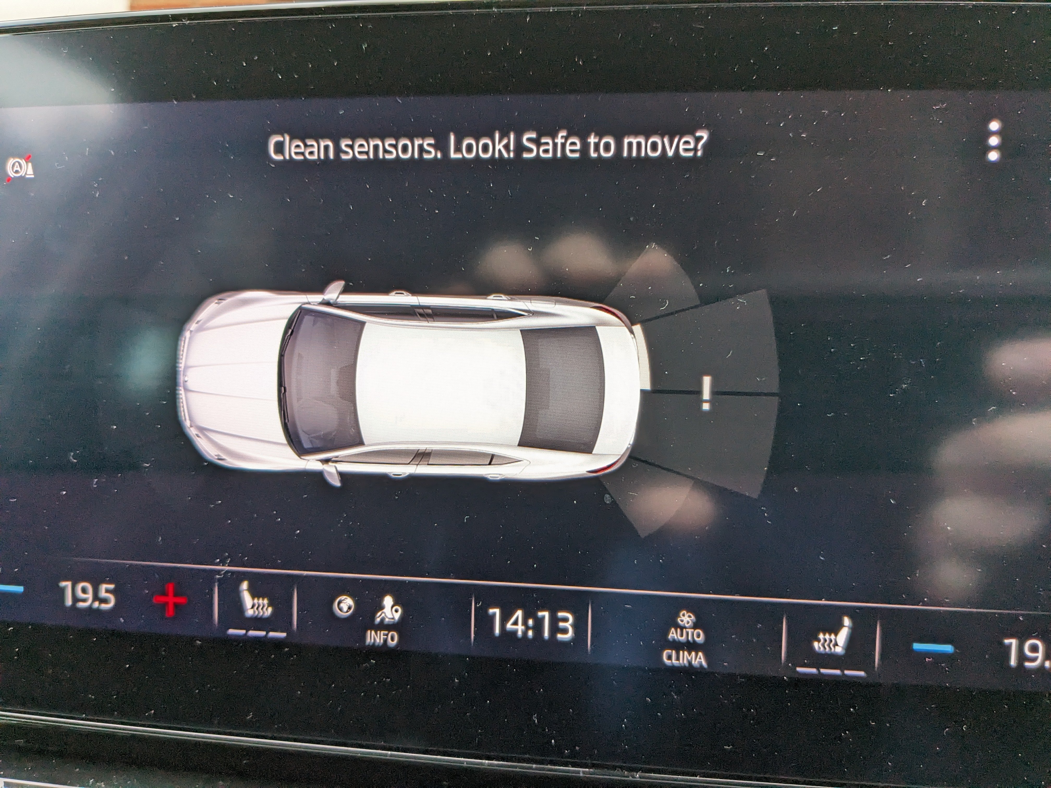

This is how mine looks on the infotainment screen and I also get a message on the Virtual Console saying that the rear sensors may need cleaning.
Based on this picture, is it the sensor second from the right that is at fault? The gray bar on that area seems to suggest that. However, no amount of cleaning of all the sensors seems to fix the problem.
it is posible that the sensor is pushed into the bumper.
you shouol try to interchange 2 sensor to see what happens

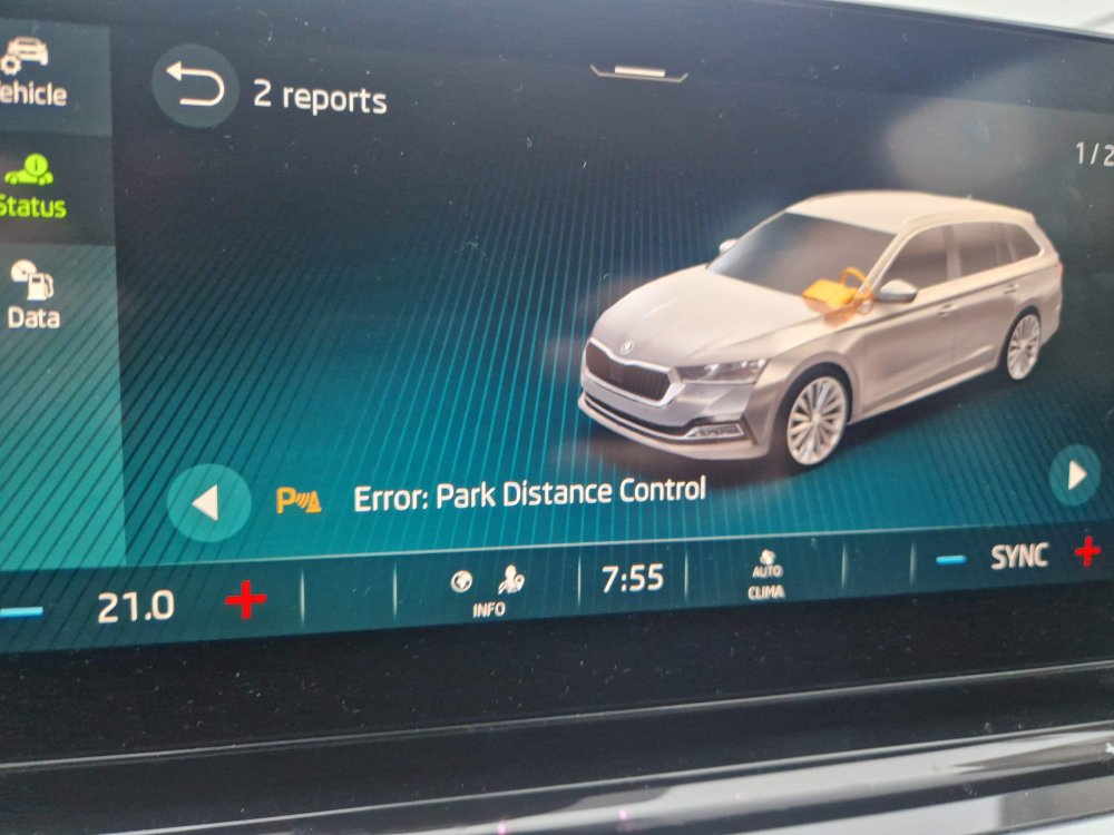

I maintained a detailed log over several weeks in January and the fault doesn't appear to be related to faulty parking sensors, environmental conditions, or battery voltage. The fault mainly appears when starting the vehicle from cold, however I did observe it a few times immediately after switching the engine off-on at normal operating temperature.

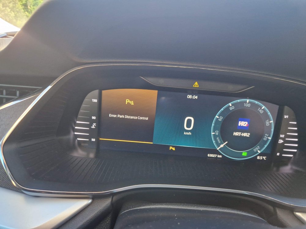

On the instrument cluster I get the "Manoeuvre braking currently unavailable" message showing briefly at engine switch on (white text), and the "Error: Park Distance Control" (yellow text) message when putting the car into gear or pressing the Park Assist button.

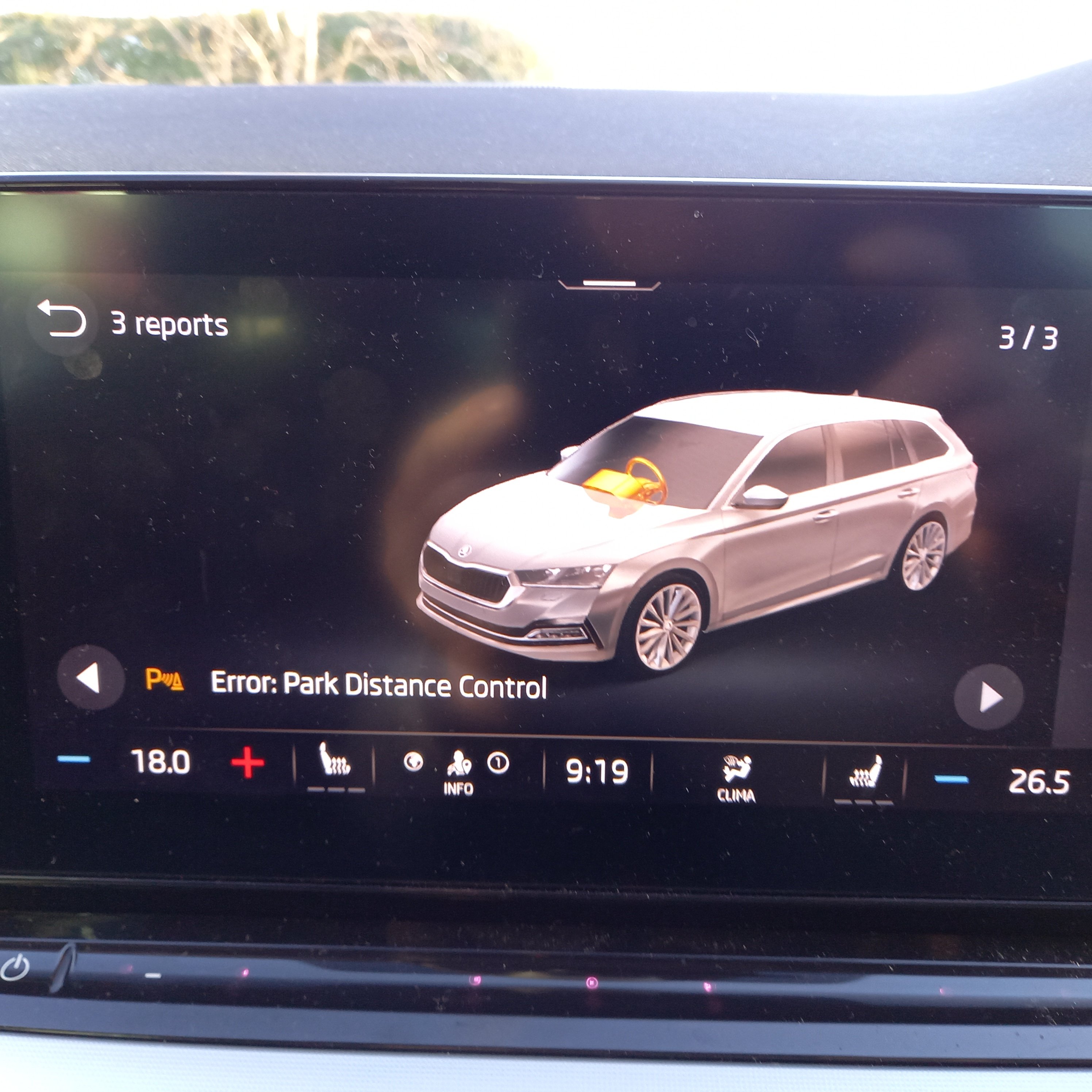

The fault is also reported by the infotainment system under vehicle->status - the error is incremented each time park assist is engaged (max = 3).
I changed the startup sequence this morning as described by ALBACORE and the error didn't appear - will try again over the coming days.

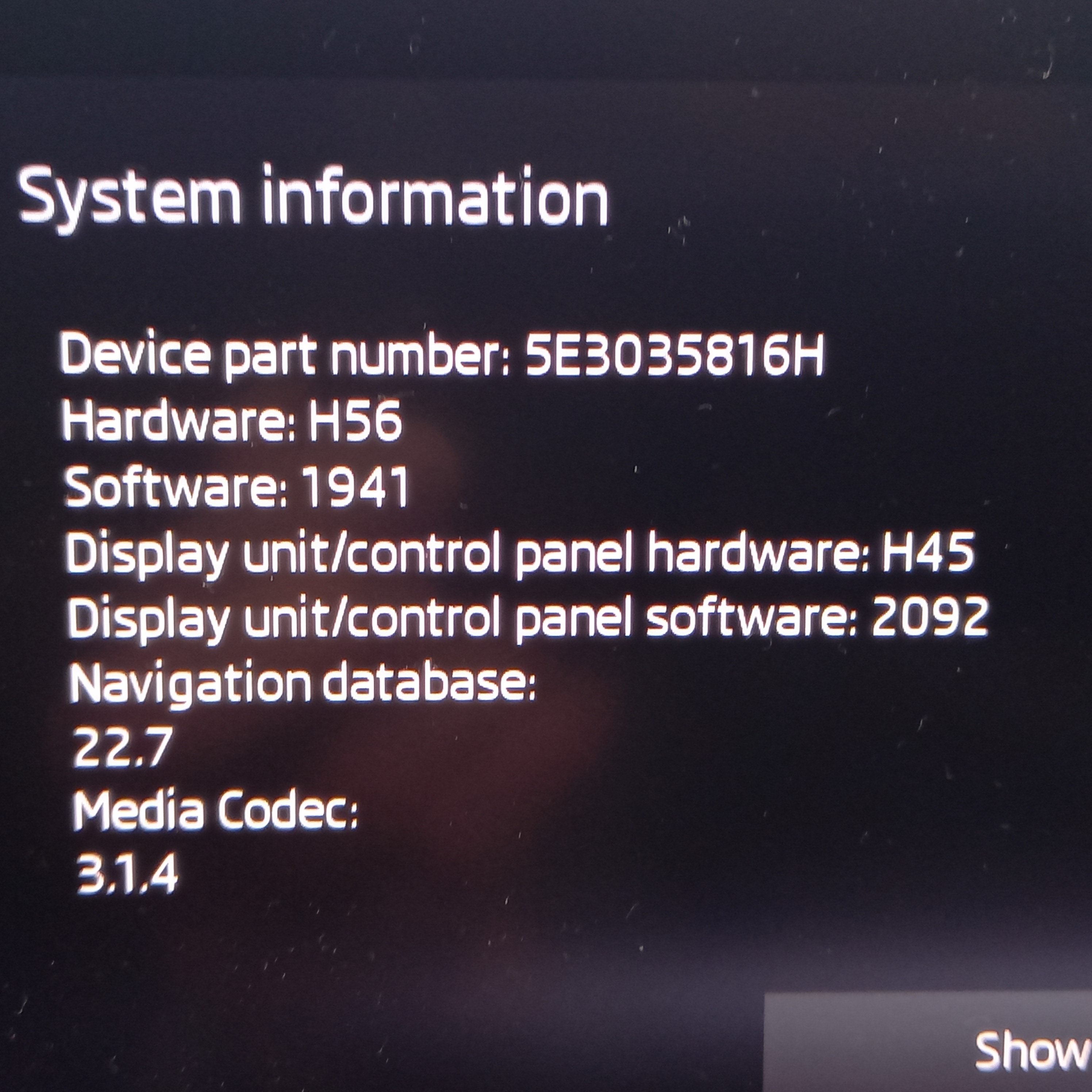

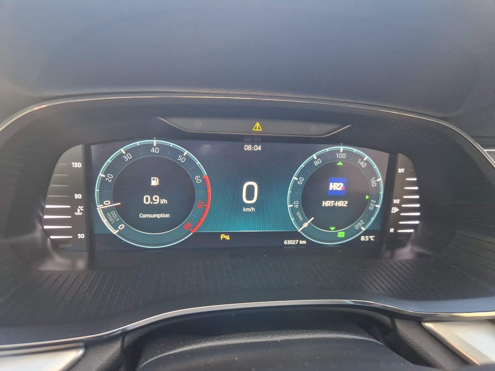

Hi all, apologies for tagging on to this thread, but am having similar problems with my 2023 Octavia vRS, which updated itself to 1941 a couple of weeks ago.
I got the car in March, and all was fine until Friday, when I had a genuine tyre pressure warning. Pumped the tyre up and reset the pressure sensor on the infotainment screen and then the problems started. Infotainment screen started turning itself off/on every two or three minutes, with satnav on the digital dash also going offline at the same time. Then I started getting the PDC warning too. Yesterday I spoke to the local Skoda service centre and the earliest they can fit me in is 25th June. Then yesterday afternoon the infotainment screen switched off, and won’t come back on, and there’s a warning about the SOS and the parking sensors. Today it started pinging randomly for half a mile and then stopped again. I’m a little concerned that the electronic problems are escalating, and hoping that this can’t get to the DSG or electronic handbrake. I’ve tried disconnecting the battery etc as I’d seen that as a possible fix, but no dice. The guy at Skoda told me that there’s a newer update (1969 I think he said), but it’s not available to me yet, and now the screen has completely stopped working I’m not sure how to sort that.
Photo taken when the screen was working.
Edited by JammyUK
I'm surprised that your 1941 update was done over-the-air - I was told that my car had to go into the dealership for this update, but that was August 2023. The Skoda dealership has had my car for the past 4 weeks, investigating the PDC issue, which has been ongoing for 6 months. The root cause has now been traced to a faulty alternator, which is draining the battery somewhat when the ignition is off. This is causing the PDC system to lock out when the engine is cranking, due to an undervoltage condition, and happens more frequently during cold conditions, as expected. So far, Skoda is not attributing my PDC issues to the 1941 update. I believe that all sorts of electronic issues can arise if the battery voltage is too low, especially during cranking, but seems like you've got something else going on with your vehicle.
