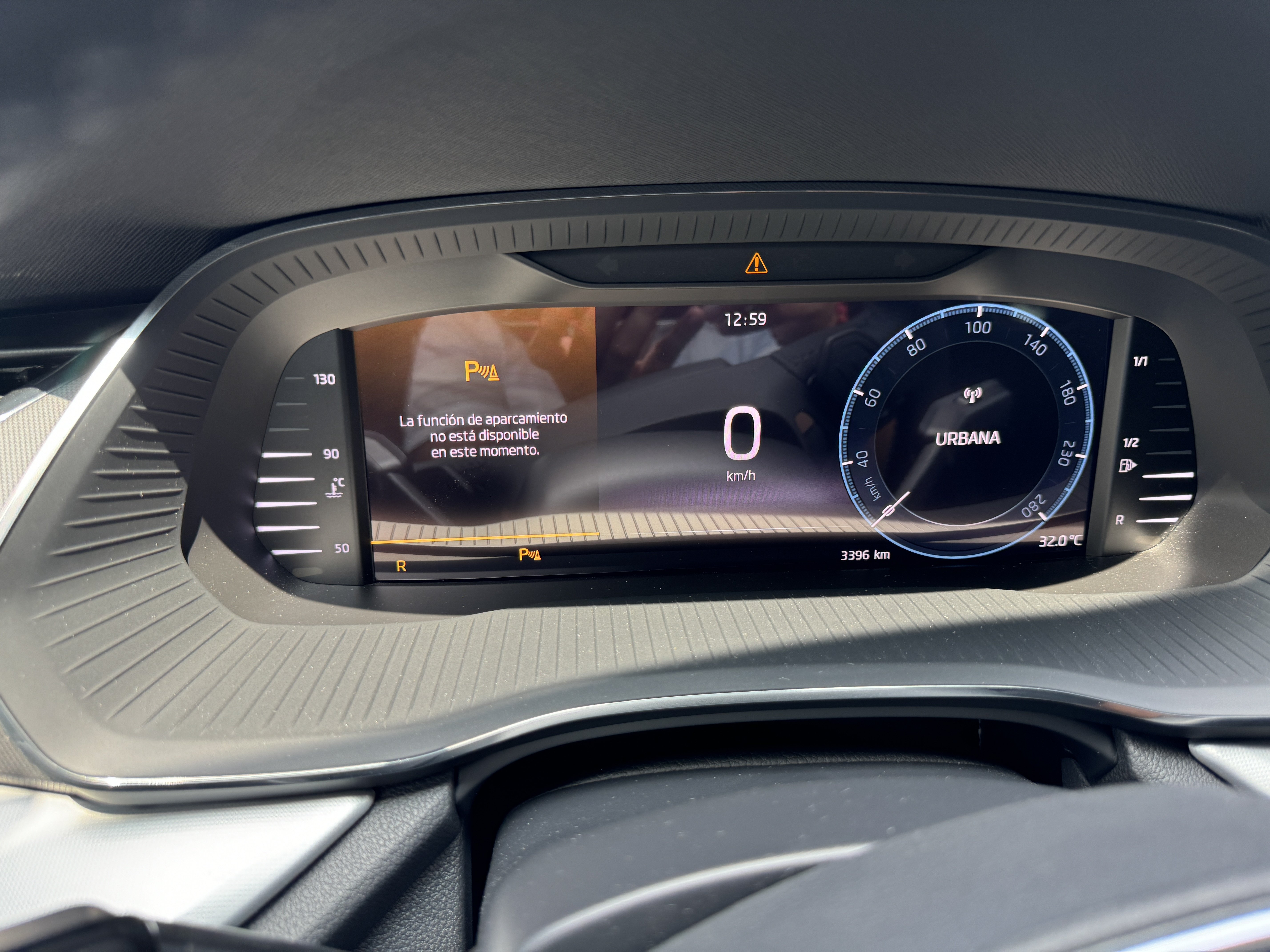

I have the same problem.. My car is at the workshop (official dealer) from Monday, and they don't have any idea  about the problem. My car is a Octavia 2024 Sportline 2.0TDI

My car is running 1805 (I have a swing radio 🤦🏻‍♂️) but the dealer and Skoda say that is the last version (for me).. and I have the problems with the PDC or infotainment… at this moment, we are testing with different battery (since a week ago), so will see 🤷🏻‍♂️

i still have that problem.. but i have a swing radio.. my dealership saids they’re going to change the communication unit (I suppose: gateway unit or maybe the BCM)… I’m waiting for it. 🤷🏻‍♂️
