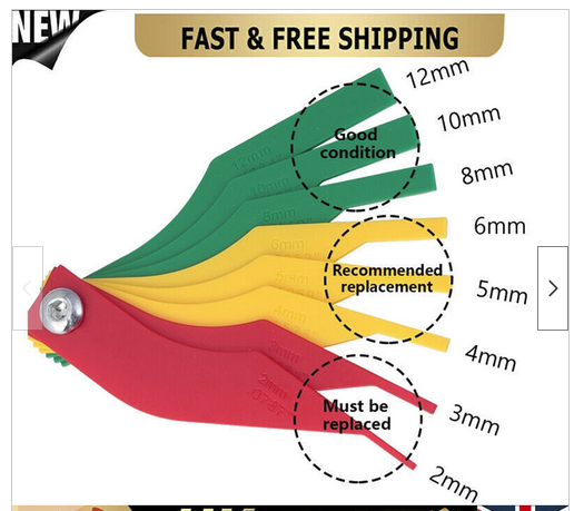

Spend a fiver and shame the garage. These are a piece of cake to use. Look for brake pad measuring tool.

@inspectorman
thanks ! I was thinking of any way how to measure it by myself.
I just need to find a video as I didn't even know that I can measure it by myself

Just take a look. I'm sure you can tell 3mm from 10mm. It does not requires a micrometer to assess pads.
I'm not criticising you.  I'm suggesting it's really easy to be on a level with your local garage chimp in when it comes to decision making.
